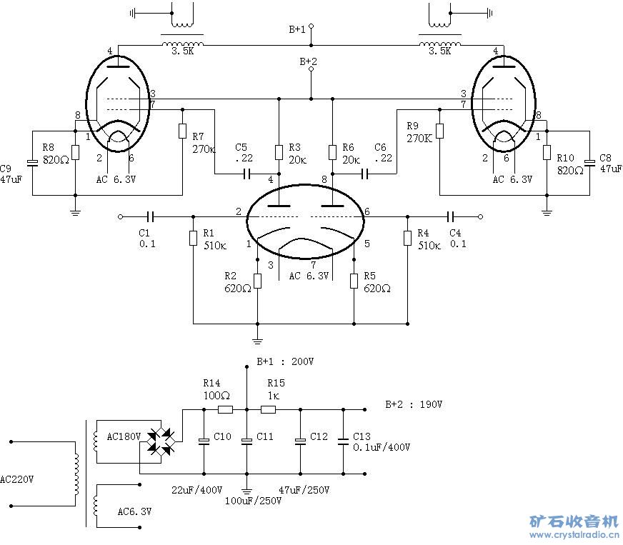

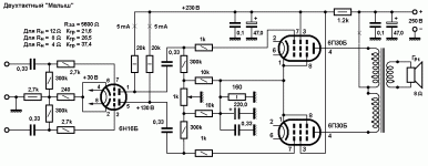

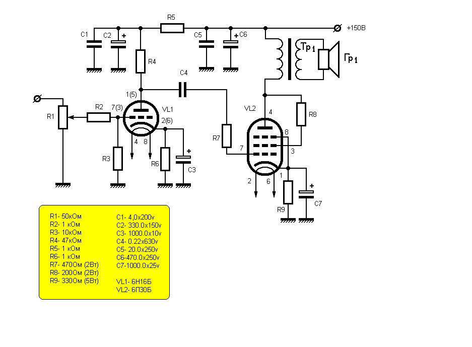

Thank you...
indeed there is not much information to find for this tube.I found some schematics and they all used about 5-6 k for the transformer BUT every schematic i found used a much higher B+ (up to 300 volt!!!) than the 120 Volt in the datasheet of the tubes.While i trust in russian tubes to take some volts more i fear this is way to much...what do you think? The last of the 3 schematics is SE so its a different thing,it has a B+ of 150 Volts,so this may be ok

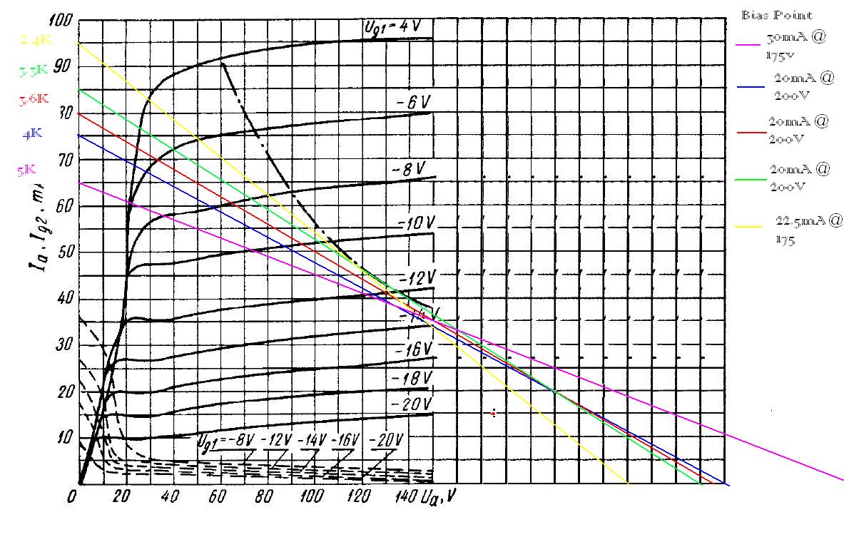

Looking at the datasheet Va max is listed as 250V, not 120V. 120V is a recommended operating point, and is not a restriction. Max voltage at cutoff is shown at 350V.
I would be inclined to operate at more like 175 to 200V, so with transformer drop and anode resistor drop, a B+ of up to 225V would be max. With 200V you would be operating the tube with about 175Va-k.
Unfortunately the curves don't go beyond 150V, so extrapolation is necessary.
Note that the G2 for the plate curve is at 120V, so your cathode resistor will need to be larger to compensate or you will draw more current than you expect to.
From the lower left curve, extrapolating for Vg2=200V and Ia =20mA, you need a Vg1 of -32V and a cathode resistor of 1600R (1W resistor). This is for the 4K curve.
Also to achieve this you need a B+ of 232V plus the drop in the transformer, so you are close to 250V B+.
Also, this analysis of for a single tube. For PP, double the impedance of the curves.
Using the purple curve, the 10K p-p transformer would work.
Use Ia=30mA, Ik=35mA, Vk=26V, Rk=750R 2W
B+ will need to be - 175 + 26 + Transformer drop (5V) = 206V
