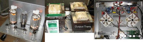

My friend asked me to select a Chinese amplifier and I selected an 813 SE triode connection as shown in the attached photo.
I investigated inside of the amp and found following points.
12AX7 Voltage Amp >CR couple > 12AU7 (parallel) Voltage amp > CR couple >813 fixed bias
Plate voltage of 813 : 800V
Output Power: 20W
Over all NFB: 12dB
Coupling Capacitor: WIMA's polypropylene
Tubes: All made by ShuGuang
I modified it to reduce NFB to 6dB and got good speedy sonic which I suspect given by big size OPT as shown in the photo.
No hum was heard.
Chassis contraction was not sophisticated, such as tolerance and finishes of the surface. I purchased it by 700USD.
In net, it was not so bad shopping.
