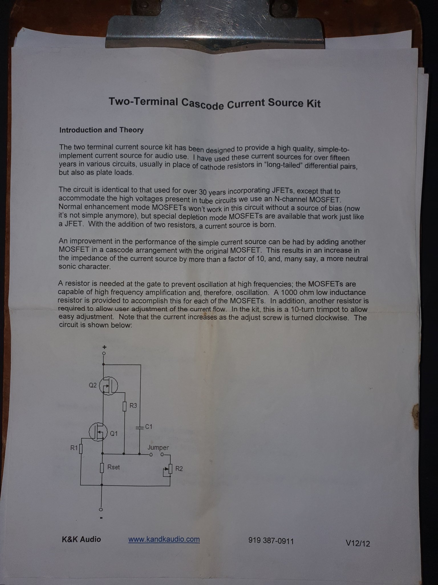

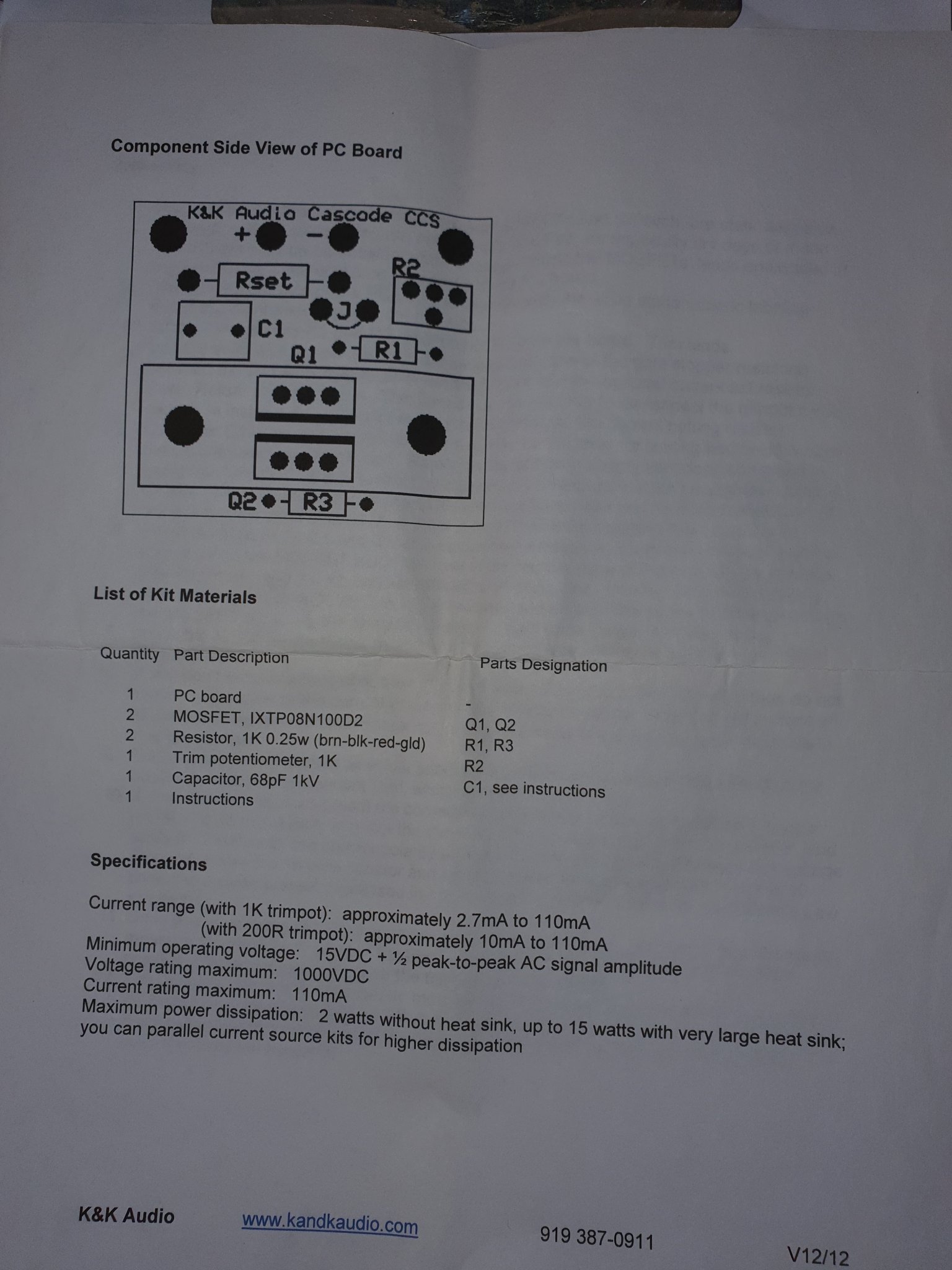

Anyone have a copy of sheets for K&K Cascode kits?
Hi all. I ran across these unused kits I had got from Kevin years ago, and realized any instructions that came with are long gone. I'm sure I could figure it out eventually, but I figured it was worth a shot seeing if anyone on here still had whatever data/instructions he sent with them. I've got a few of the smaller "Cascode", and a few of the larger "Large Cascode" boards.

Here you go
l
