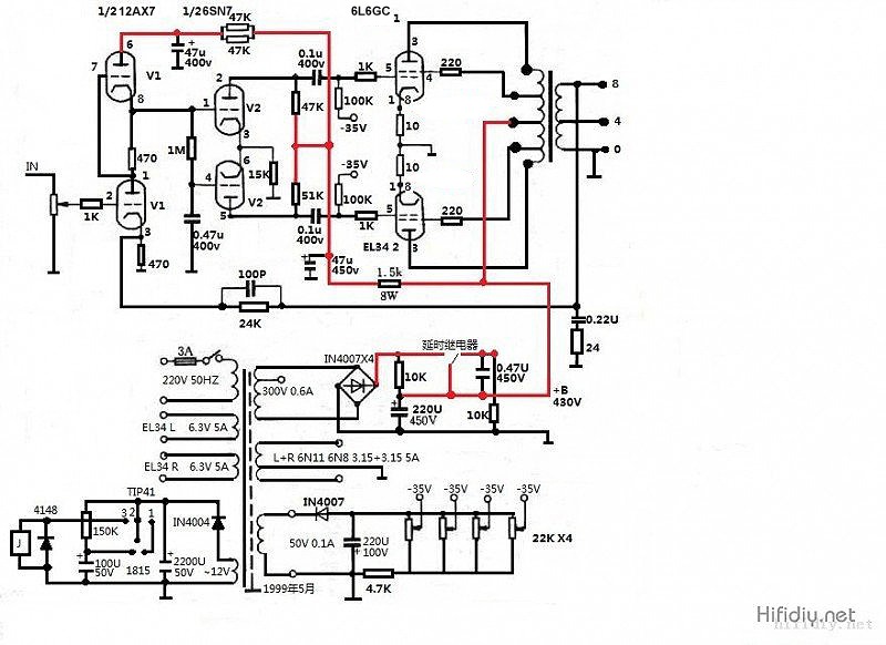

I have had this amp for about 10 years and haven't done much with it other than play with different tubes. I started looking around the web for info on it and found most pictures and reviews showed it having 6L6 outputs, but the 3 different schematics I found showed EL34. The other odd thing I noticed is that 2 schematics showed it connected as a pentode, the other shows connection to "ultra-linear" taps, but all still EL34s. Mine was connected as pentode with G2 connected to B+ thru a 10K resistor and G3 tied to cathode. I pulled the output xfmr caps off and found they actually have the UL taps, so I have connected wires to them and run them down into the bottom area. while I had it apart I decided to check the transformer impedance ratio, turns out it's 4.4K P-P and the taps are 43%, pretty much standard UL configuration. So now I wonder why they would have built it like this? The other odd thing is that they indicate the bias is different for each output tube, and they use different plate resistors in the driving 6SN7, I have no idea why it's built this way?

1. The 6L6, 6L6G, 6L6GA, and 6L6GB screens are only rated for 270V, 2.5 Watts.
A 10k screen resistor might have been there to alleviate the 430V B+ when they are in either pentode mode or ultra linear mode.
The 6L6GC screen is rated for 450V, 5 Watts, Big Difference!
The EL34 screen is rated for 450V, 8 Watts. A Very Big Difference!
A 220 Ohm screen resistor makes sense with 430V B+.
2. The 6N8 with 15k common cathodes resistor is a poor-man's Long Tailed Pair phase inverter, LTP, (not long tailed at all).
The 15k resistor is returned to ground, instead of a 150k resistor returned to a very large negative voltage (the latter is more long tailed).
The poor-man's long tail does not use / does not have a true current source; instead it uses a 15k resistor on the parallel cathodes.
Since g1 pin 1 gets the whole signal directly, and the g1 pin 4 is at AC signal ground, there would be more signal plate current at pin 2.
The cathode pin 3 couples signal current to Both cathode pin 6, And the 15k resistor to ground (cathode pin 6 and 15k share cathode pin 3's signal current).
That means less signal current to cathode pin 6, so less signal current to the plate pin 5.
With less signal current on plate pin 5, we need a 51k plate load; there is more signal current at plate pin2, so we only 47k plate load.
The larger signal current in 47k, versus the smaller signal current in 51k, gives about the same signal voltage out for both phases.
If you use a true CCS (constant signal current sink) instead of a 15k resistor, then the plate load resistors for pin 2 and pin 5 must be equal resistors
(Either both 47k, Or both 51k; use precision matched resistors).
Push Pull Output Transformers . . . Hate plate currents that are not equal. That is why they set the bias current on each output tube of a push pull pair, to make the output transformer happy (no early lamination saturation when the currents are balanced; versus early saturation if the currents are un-balanced).
Be sure to make the voltages across the 10 Ohm resistors equal, for equal cathode currents (near equal plate currents and near equal screen currents). Of course, those 10 Ohm resistors need to be precision matched.
The only other alternative is to use Exactly Matched output tubes for a push pull pair.
I am sorry for the complex answers.
Happy Experimenting!
Happy Listening!

I'm finally back on this project and have been playing with it for a week, and doing a lot of research trying to nail down some of the anomalies in the diagram vs my amp.
First thing I found out is the cct brd in the amp could be either for the M99 or the M100 and it turns out mine is the M99 and uses a different tube line up. The other thing I found is this schematic originated from an Asian DIY site where someone reversed engineered the cct and came up with this when they were troubleshooting the amp which is why the bias voltages were wrong. Turns out all the documentation and reviews I could find for the amp indicates the tube lineup is 12AX7 into 6SN7 into 6L6GC. So I have updated the schematic for anyone else who finds this thread and can now continue tweaking it for better performance.

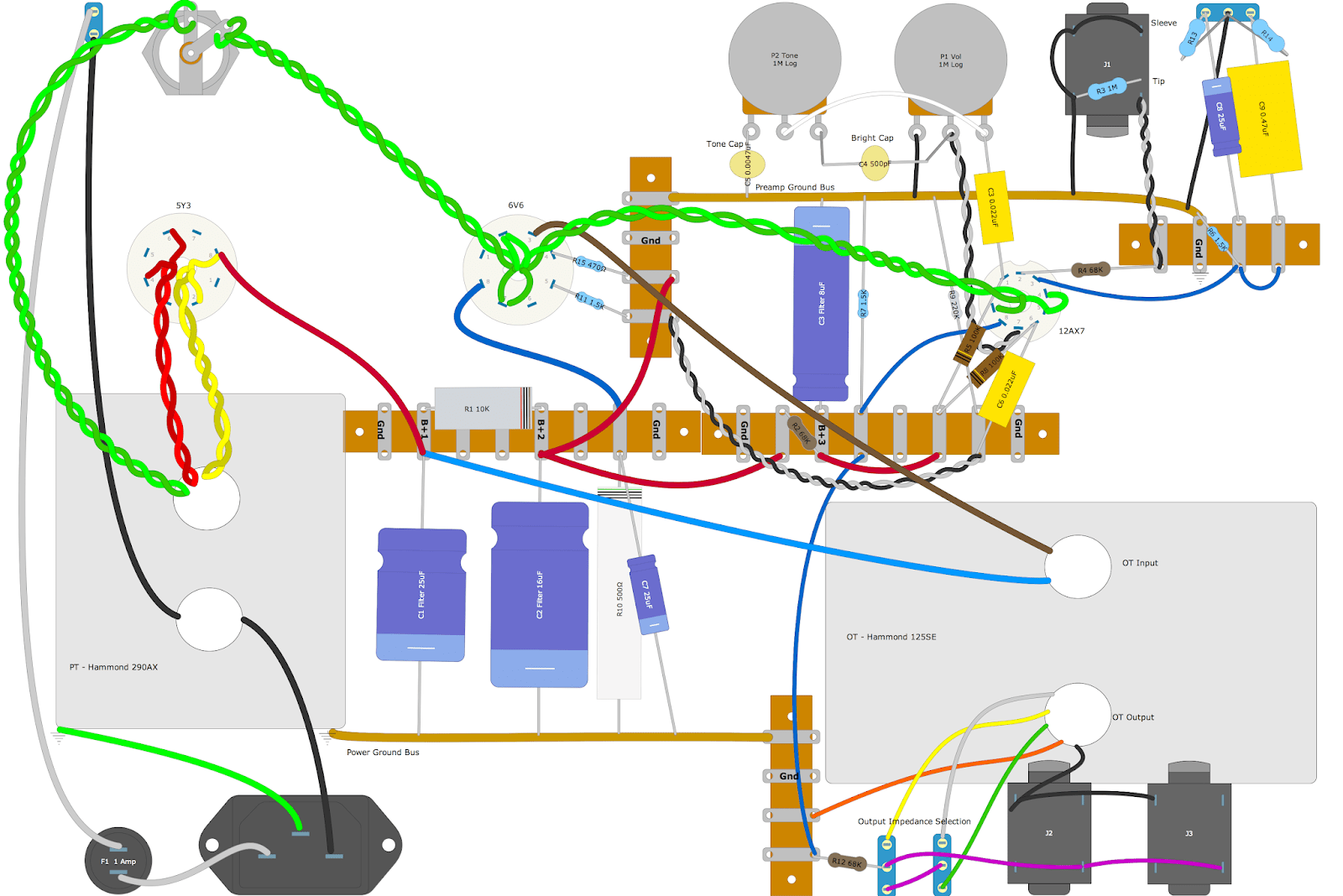

Hi there, new member here and first time posting from Melbourne Australia!!
@kilohertz I've got the M100+ also, It's not my main amp however I've been searching high and low for a schematic so thank you for providing yours!!
So reading the above this should come as no surprise..... mine is different too! only minor however different. mine is 12at7's the two parallel 47k resistors on the 12ax7 (in your cd) are labelled as 47k on the board however mine are 150k, 33p ceramic on the NFB board calls 82p, yours is 100p...!! Also mine only has 2 bias pots and I would love to somehow rework to achieve 4 pots. My bias pots are not top plate mounted, and man!!! 1 per channel is a major headache if the tubes are not really close, and where they are mounted is painful to use. You mentioned a possibility of rewiring by p2p and tossing the pcb? my pcb is totalled due to constant playing around so I'm really interested in trying this also including the PSU board and whilst I have good practical skills and a reasonably good understanding of how this could work I'm not quite at a level where I'm comfortable to read a schematic and apply it to a build. I was hoping someone here could assist with a basic layout drawing (can be hand drawn) that shows components, wire routing and attachment points, similar to the one I show below, doesn't need to be a pretty thing just simple enough to follow. I also want to scrap the input board, only 1 input required, no remote or channel selector required and just use an alps or similar coming off the RCA to volume pot and straight to the first input stage.

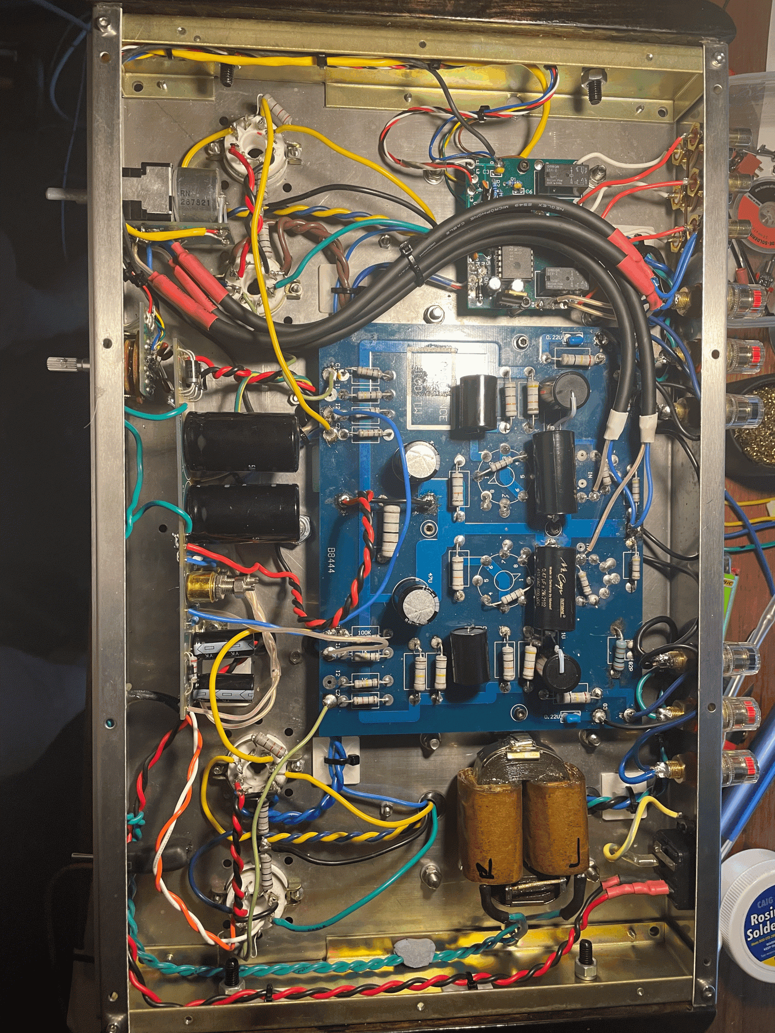

I haven't worked on mine for over a month. I installed the LM334 CCS as described and it worked great without a negative supply. I think I ended up using a 10 or 12K in series with it, and put the LM334 on top of the cathode R, closest to the tube, the R goes to ground. It works great and balances very nicely. You can see my prototype in the picture below. I don't recall making any further distortion tests as I was moving on to another project but I know it sounded nice.
I like the drawing you supplied, is that something you generated? If so what software package is that? It sure makes layout simpler. I haven't scratch built P-P in a long time but really enjoy it. It's not difficult, you just need to be aware of the tube pin numbers, helps to make a diagram indicating them so you don't have to keep getting the magnifier out to see them on the socket 🙄 .

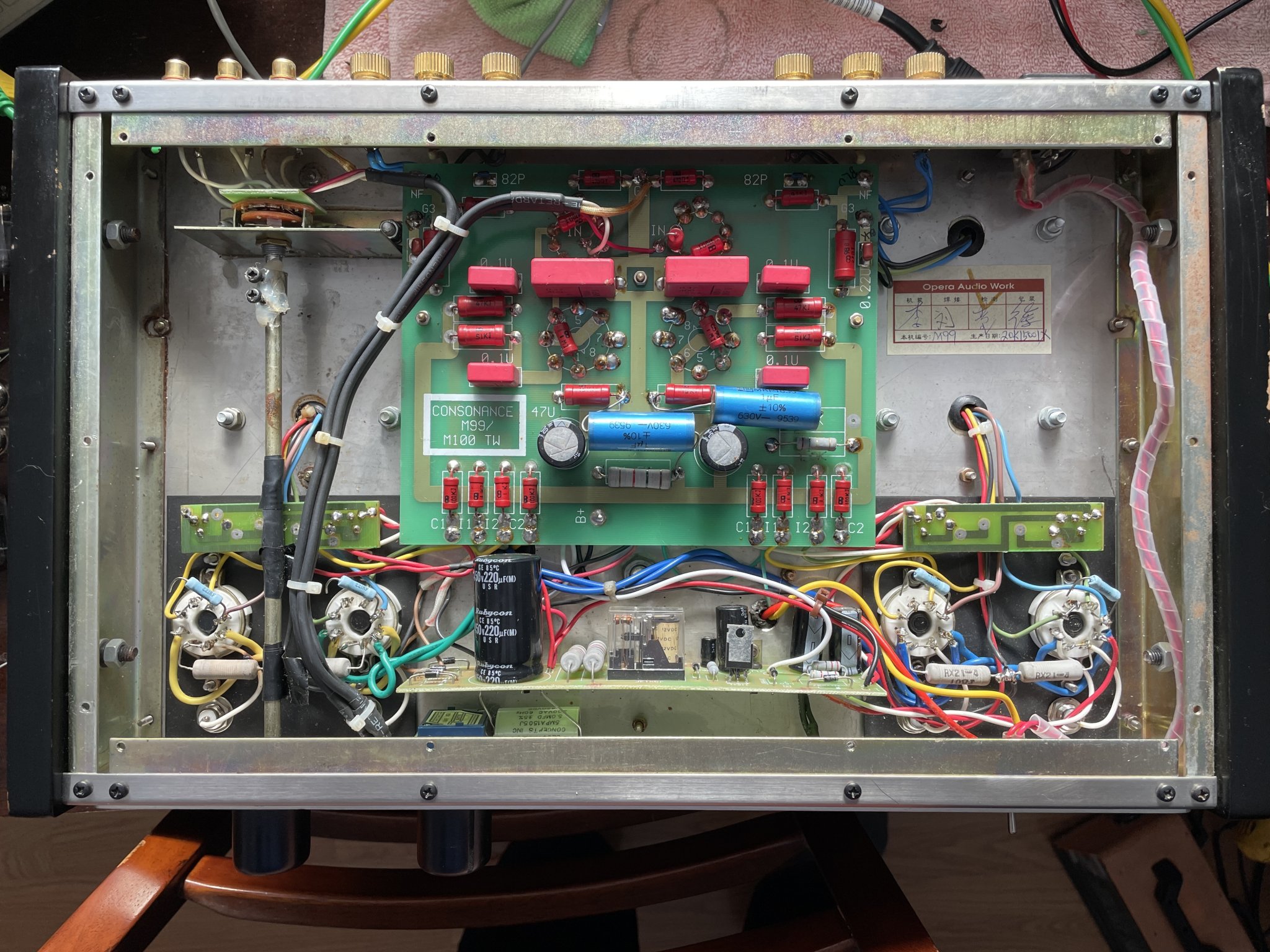

If you can, I would love to see some closeup pics of your PCB and the overall underside as it is wired. Would be interested to know what differences exist. I'll post mine now.
