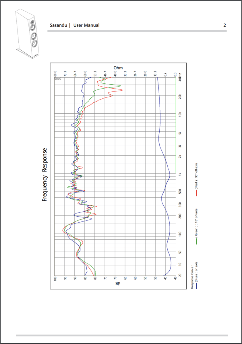

btw you can download the manual here
https://sbacoustics.co.id/wp-content/uploads/2021/10/Sasandu-User-Manual.pdf
judging by Freq response, the treble seems lack of energy a bit and seeing the impedance, it might be suitable for solid state amps, as it drops below 4ohm from the graph (i may be wrong though)

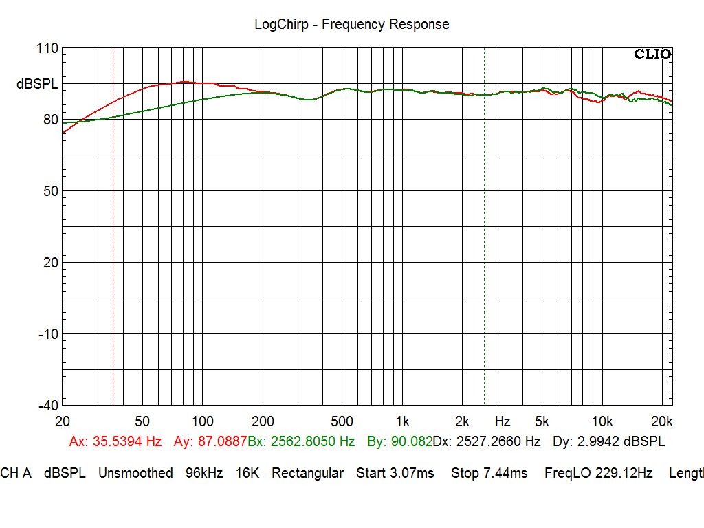

SB Acoustics Sasadnu DIY kit from Audiohobby.eu:judging by Freq response, the treble seems lack of energy a bit and seeing the impedance, it might be suitable for solid state amps, as it drops below 4ohm from the graph (i may be wrong though)
There is no energy lack in treble, it is just how SB measured it.
Green is short window on axis between midwoofer and tweeter and red is on tweeter axis (complex sum of far field, nearfield and port) - 2db scale.
I suggest that it's better to listen them on the axis between midwoofer and tweeter - low chair or just add small foots to the front.
They are pretty flat with some extra bass + 2db @80-100Hz.

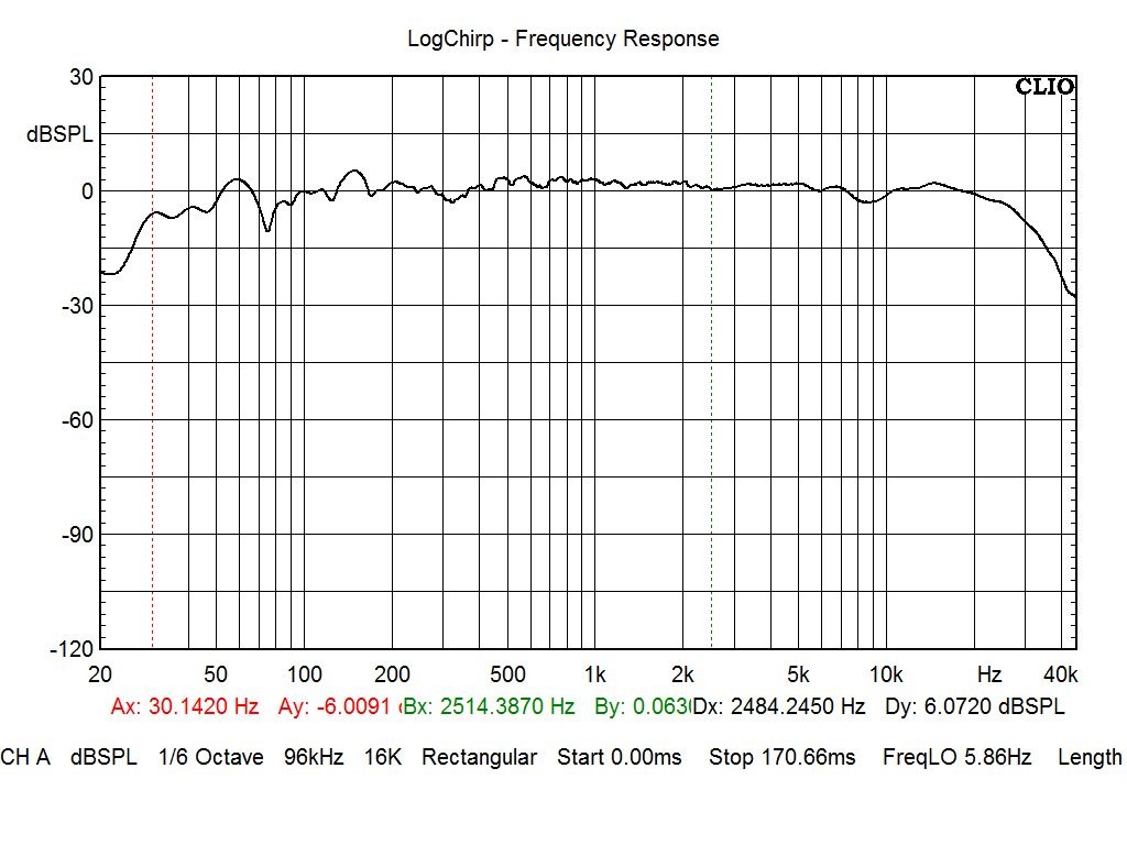

Here is in-room measurements, 1/6 smoothing - it extends to 30Hz @-6dB:
150dB vertical scale makes all looking good. 40-60dB scale (as is normally used for speaker measurements) would probably show mild downtilt of trebles above 10kHz. It is also in tweeter datasheet.

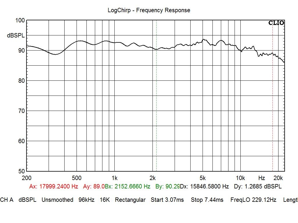

It is pretty flat there, image attached is measurements are on axis between tweeter and mid, 1dB scale.150dB vertical scale makes all looking good. 40-60dB scale (as is normally used for speaker measurements) would probably show mild downtilt of trebles above 10kHz. It is also in tweeter datasheet.
1 kHz is 92.5dB
2.15 kHz is 90.3dB
18 kHz is 89dB
200Hz-18kHz fits into +-2dB
TW29BN tweeters ares very detailed, slight roll-off is absolutely fine there.
I was not concerned with that top end mild rolloff. Now your measurements match SBA measurements and tweeter datasheet.
For example, BW 802D Diamond tweeter has similar rolloff and it is definitely ok, detailed and airy.
