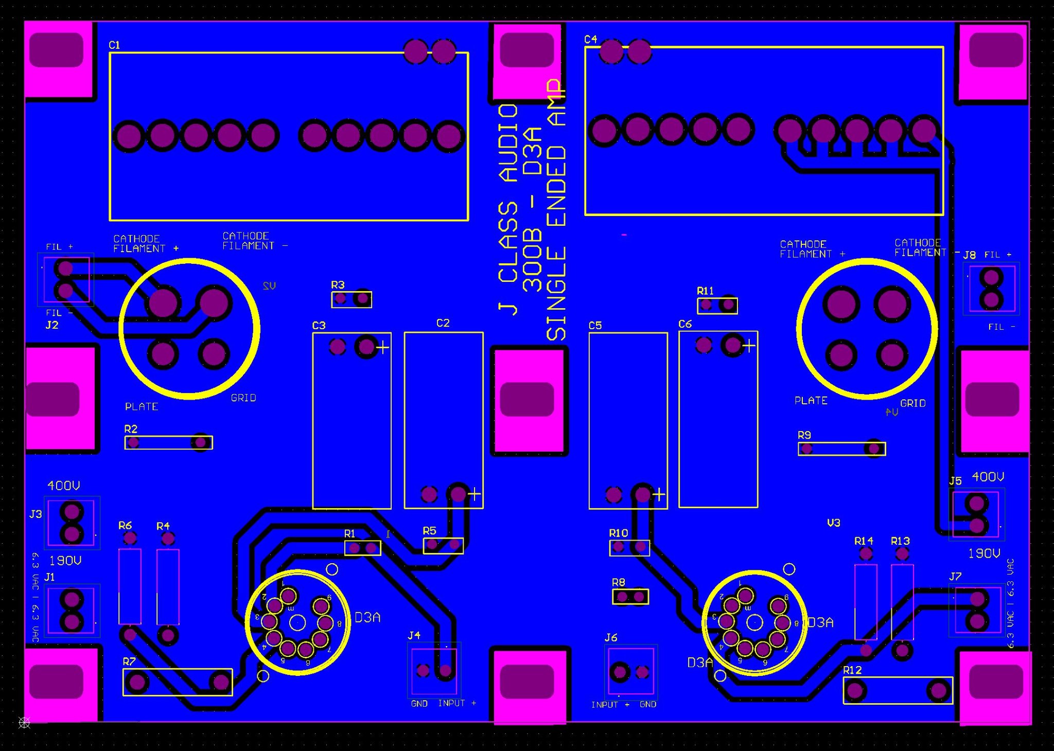

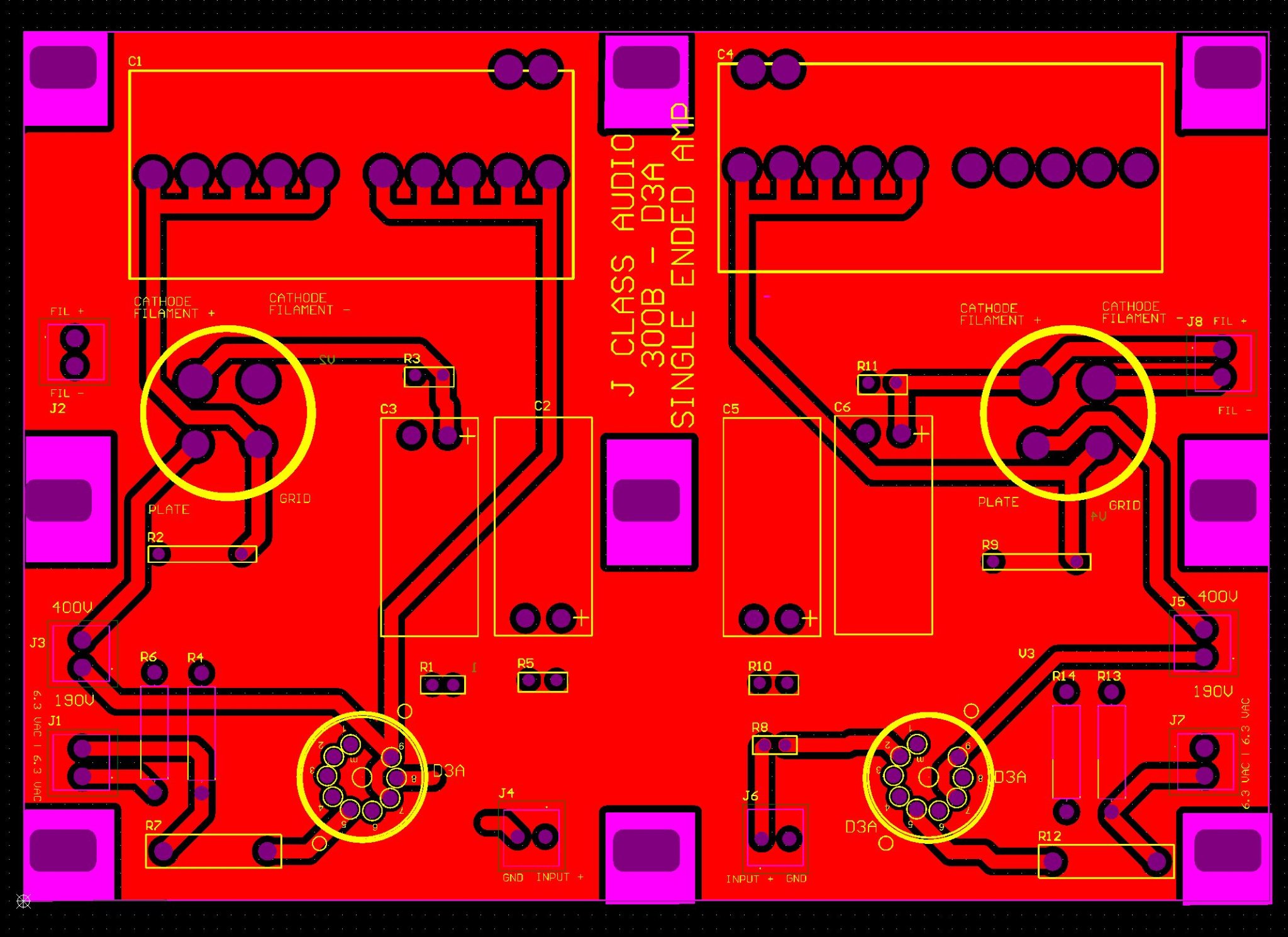

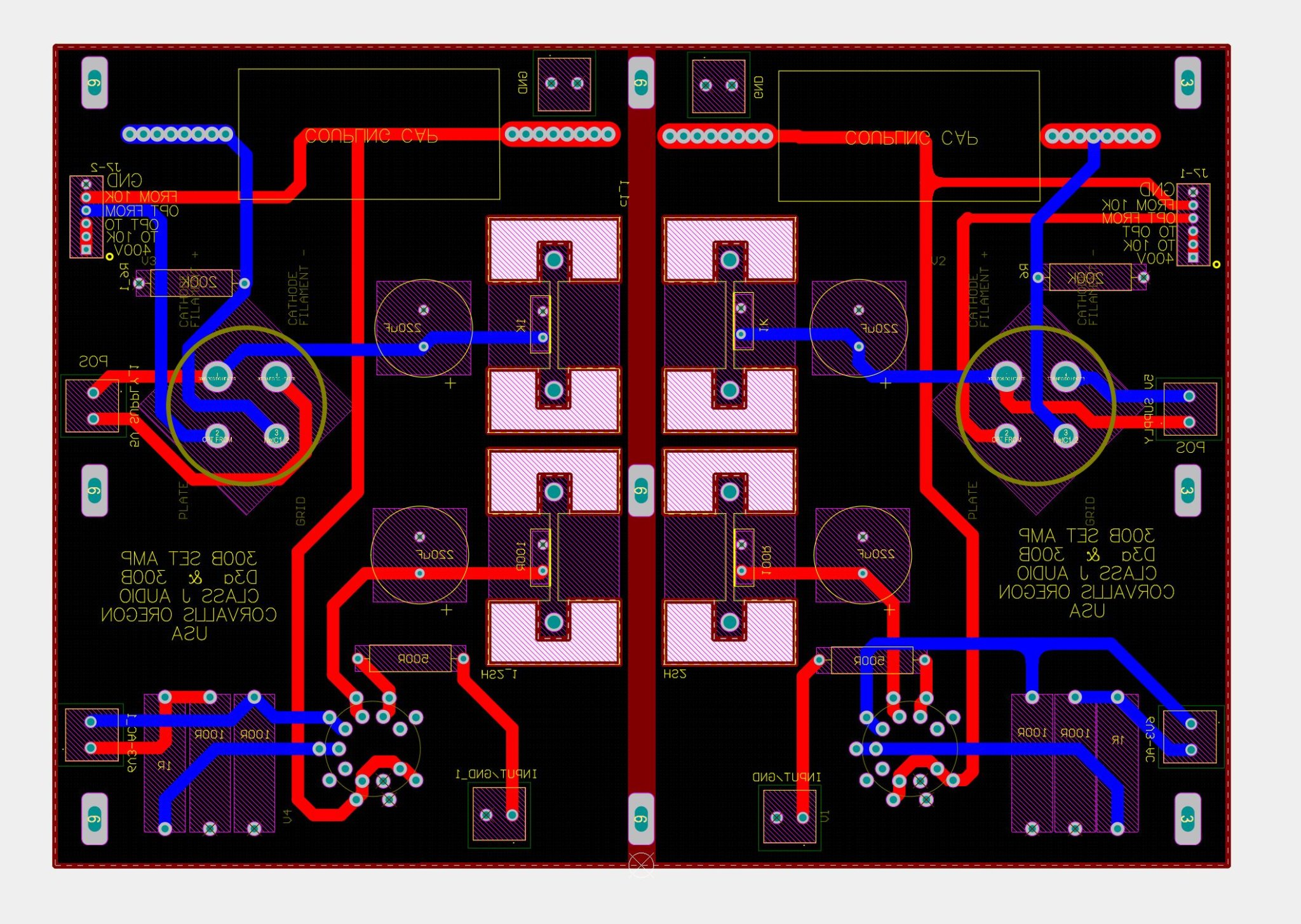

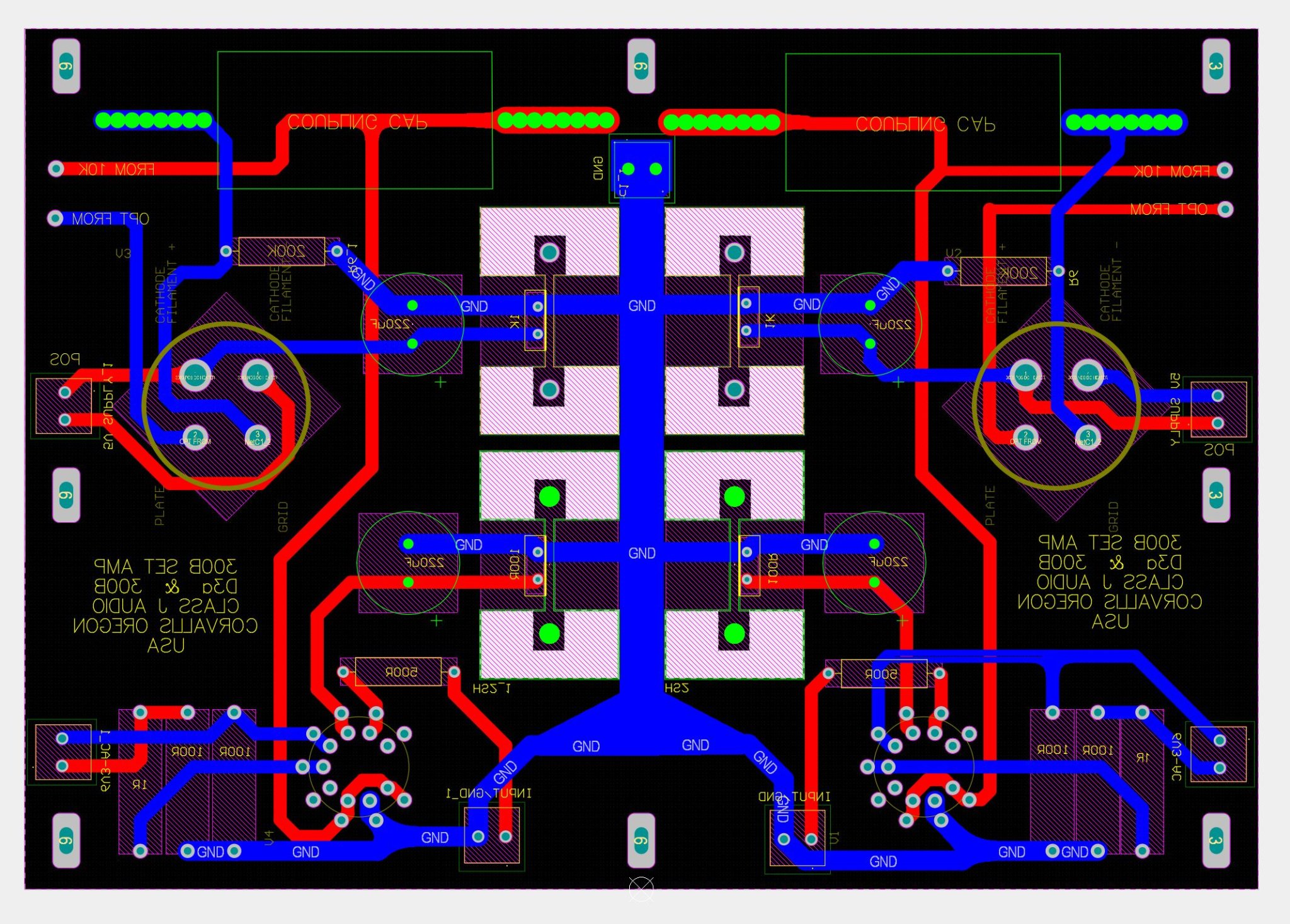

I am getting a SHHHHHHH sound in one channel. My old board didn't have anything that the new board doesn't have. The grounds are different is all. Old board was a 2 layer with a pour on each side tied to ground. The new board is a 4 layer with 2 solid ground planes in the middle. I am thinking it must be the way the grounds are connected. This amp was the quietest 300B set amp I have EVER seen. With La scala speakers at 106spl you could not tell it was turned on until the music started. I am going to unhook the connection to the ground planes and run individual wires from each ground point. There isnt that many. And see what happens. I have tried to put different board layouts in this amp 3 times and every time I ran into problems and went back to the original. Which is far from ideal but somehow dead silent. I just dont get it... what could I add on real quick to squash any d3a oscillations?
Also I design circuit boards for a living. Not saying that makes me immune to errors ( god knows that isnt true) but I avoid the big ones.. this has me frustrated beyond words..
Here is the board that worked and the one that doesn't. The heaters on the D3a are ac and the 300B has a pair of tent labs filament boards on the heaters. The amp was dead silent with the good board. I have a batch of the good board on its way to me and I also have some of the pic marked future boards. I got rid of the ground planes and changed the grounding to the scheme shown. No idea if it will fix it but i at least have the good boards on the way as well so I can always put it back to the way it was if I have to. The problem board has 2 inner ground planes and the connection is made to the power supply by the 2 connectors at the top of the board straddling the center screw.
