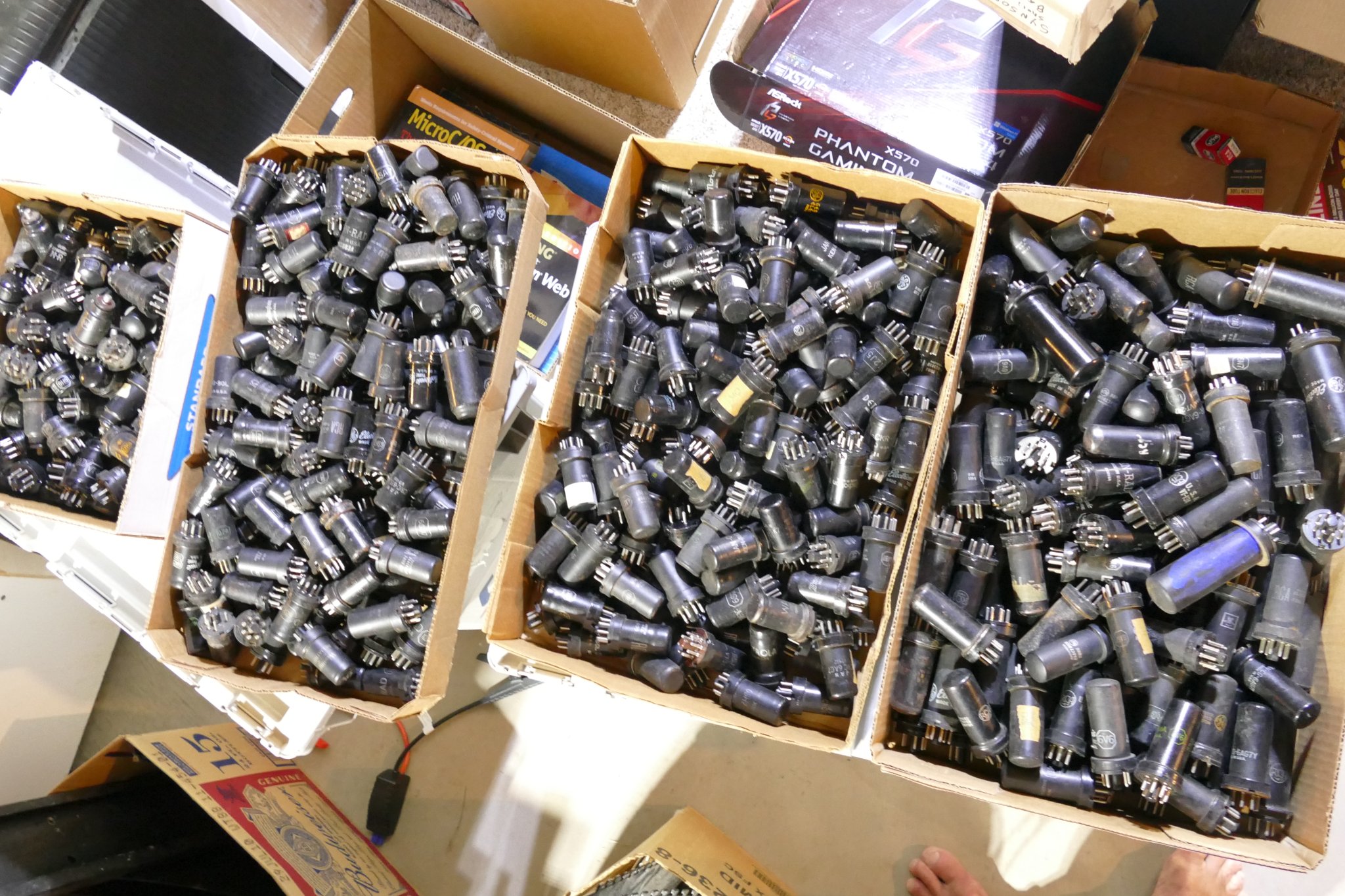

The one in the yellow shirt bought 40 pounds of vintage metal vacuum tubes for $30. They have been sorted by size. I need to rig up a way of testing them. The 6V6 and 6L6 tubes will simply be tested in my SSE. There were at least 15 6L6's and probably 20 to 30 6V6's. The 6L6's are easier to find since they are bigger.

Buying a big box full of assorted unboxed tubes is a highly unpredictable situation. In this case I saw the 6L6's and 6V6's and took the gamble. I'll know more once I sort and test them. I still have two more small boxes of metal tubes from previous hamfests. I got all of these to improve my chances at making a single one - off guitar amp I will call the MetallicAmp, all tube, no glass. I plan to create a modern multi channel high gain amp with parts that could have been built in the early 1950's.

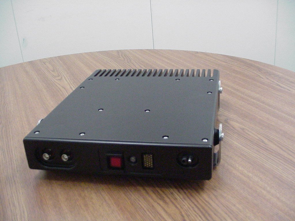

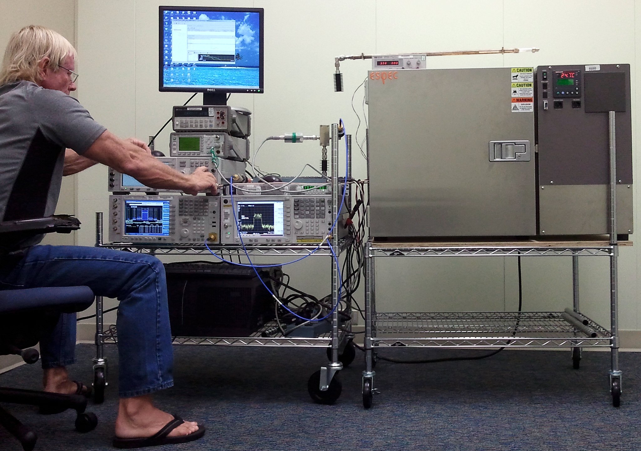

Here I am working hard. The "black box" is a prototype high speed data radio I designed which would normally reside in the trunk of a cop car. We had a full machine shop, a PCB fab, a miniature SMD assembly line, a stocked engineering parts room and several other fabrication groups in house. They were all being phased out as our group was morphing into an IC design center which I wanted no part of. I took the buyout in 2014. The other two had left before I did, involuntarily.

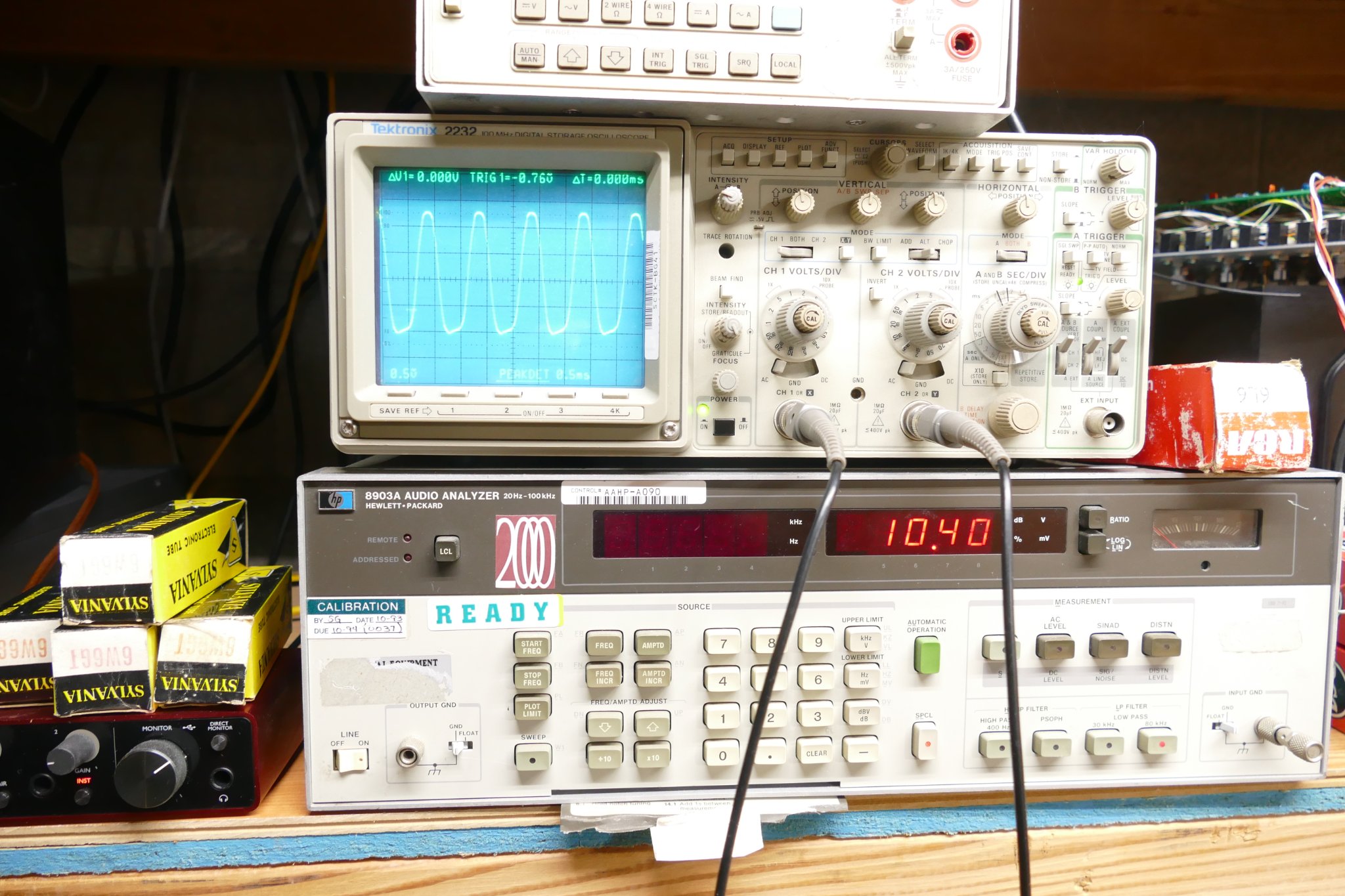

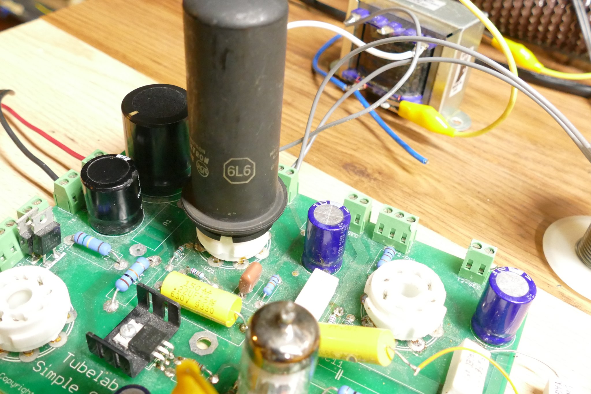

After tossing all the rusted or broken tubes then tossing the thyratrons, klystrons and unidentifiable tubes, I had 672 tubes in several trays sorted by size. Two nearly full days later I had them all sorted into 51 different unique type numbers.

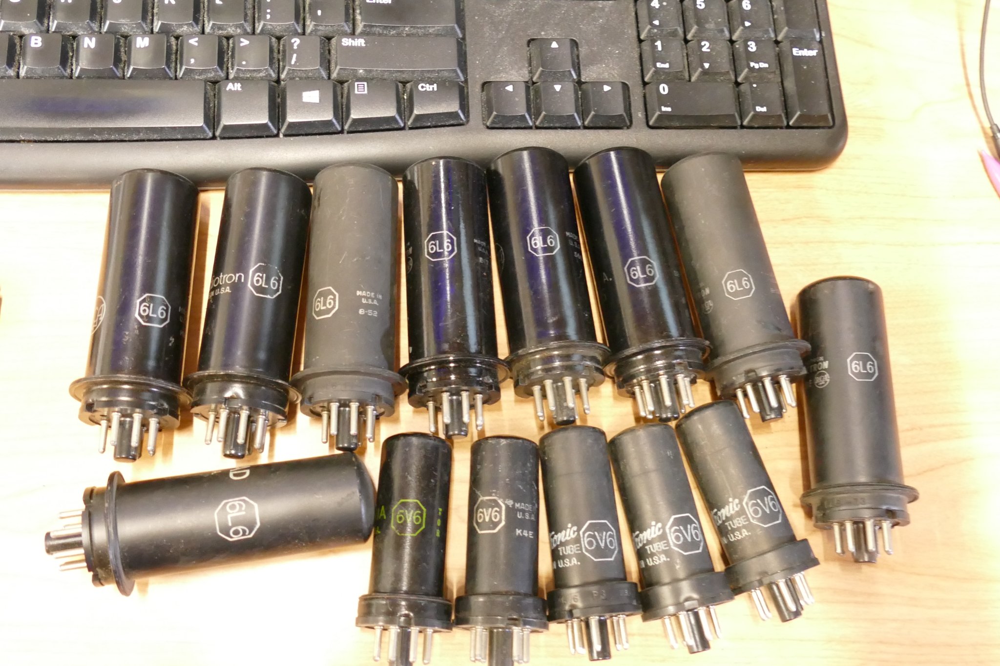

Tonight I set up one channel of my 19 year old SSE board for audio output tube testing. There were 20 tubes that identified as 6L6's, but one was an impostor which paid for that infraction with its life. Someone had written 6L6 on the side, but the engraving on the rim said 1619 which is a 6L6 with a 2.5 V Dh filament which is now open. Another tube identified as NG and it was indeed dead. A third tube didn't draw much current and didn't have any output at all. This left 17 tubes that made at least 8 watts at clipping with about 60 to 80 mA of current in pentode mode without feedback. Three NOS metal 6L6s and two Chinese glass 6L6GC's made around 9 watts. so I set my limit at 8.
I started with 18 6V6's and finished with 17 testing to a 5 watt minimum, determined by a few glass 6V6GT tubes.
I started with 12 6F6's and finished with 10 testing to 3 watts baser on the specs in an old tube manual. The bad tubes got hotter than the good ones, drew too much current and had low distorted output, so I suspect they were gassy.
