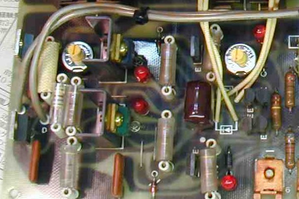

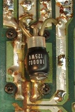

Anyone familiar with this power amp?
Yeah, it has the numbers of a cap, and the ones on the top side of the boards are caps.
But why the willy ? It looks 3-legged !
You think its a 3-pin cap with the third pin sleeved for isolation, or a double cap in one encasing ?
And why having it dangling there ?

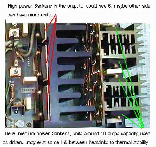

Re: Excuses mois monsier Scytales, I am sorry Mr. Scytales
destroyer X said:
But watching more close, i could see that power transistors are in the big heatsink, as more usual.
regards,
Carlos
Carlos,
The others are also MT-200 Sankens. (On smaller heatsink) only that they are mounted on their sides so from the top they show only half the width.
Arif

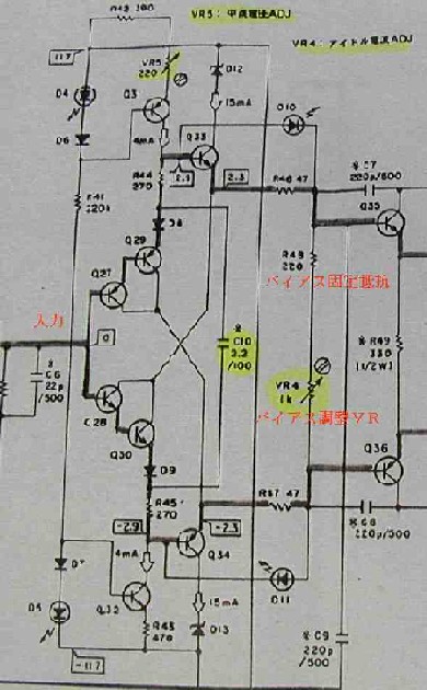

The M5 has two identical toroid transformers for the powersupply, one for each rail.
Anyway, the M5 is the predecessor of the M6.
They are virtually the same, the M6 has a fet entrance, visually you cant tell one from the other.
The other part i posted is true, this is not a switcher, one is a class AB amplifier, the other is class A.
The circuit is sort of floating bias, Pioneer called it Dynamic Current, when more output voltage is needed, the output of the class A stage drives the class AB stage on the big heatsink.
The big one is a full amplifier, with entrance stage, Vas, and drivers.
The third cap is for a single rail ps for driving the high power stage.

Arif,
Andrea Ciuffoli probably has the schematic of the M6.
His headphone amplifier design is partly based on the front end of the M6.
Posted at the headphone article is a picture of the M6,it shows the outputs of the class A stage going to the output terminals, the powerlines connect to the big amp.
The big output class AB section should be modulating the output voltage of the powerlines to the 8 device class A part, piggyback style.
Which explains why the front end is running on +/- 117 vdc, and why the big cap between the class A powerlines blew.
I'll send an email to Rome, maybe Mr Ciuffoli is willing to tell how the voltages on the rails are modulated in detail.
