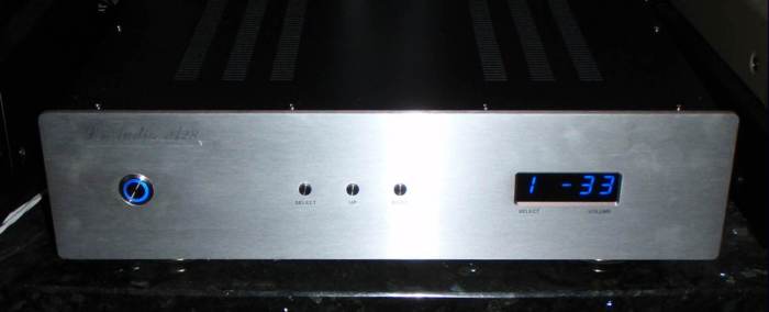

I have finally had some time to experiment with the PGA2310. It works very well actually...
Without an input buffer it sounds a bit dark. With an input buffer, it sounds more like the relay attenuators. I used an OP275 for the input buffer, as that's what I had in the opamp drawer 🙂
There's no hum or noise, so the high input impedance is not a problem. It's the high output impedance of the 50k relay attenuator that caused the hiss. But as the PGA chip is buffered internally, there's no problem here.

Mods: I cut traces between psu-caps(+/-15V), added a 5-10 ohm 2W+ resistor for some CRC-filtering.
I took out the input DC-blocking-caps/replace with jumpers.(small resistors).
Added a cheap china-J-Fet-buffer for output, powered by a group-buy psu.
To come: a small output-mute relay w/delay...
Arne K
