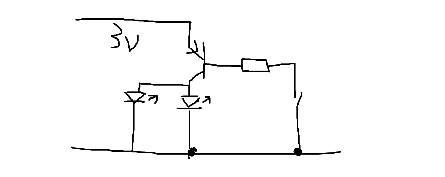

Just to be clear, all you want to experiment with is switching a couple of discrete LED's running off 3 volts ?
If so then there are a couple of things to consider.
I was thinking something like this. The transistor should be a high gain type suitable for low loss switching. The resistor limits base/switch current. You may need limiting resistors for the LED's. LED's to be in parallel and not series as 3 volts is insufficient for series connection.

Thanks mooly for your diagram. It seems to me that something like this should be able to work. Am I wrong thinking the voltage switch can be the hot shoe completing the circuit?
I know in a standard flash design, the xenon flash units run 300v or more and the camera completes that circuit and the 300 plus volts runs through the camera.
I don't know enough to know if the two LEDS with 3v would in some way over power the camera capacity?

The LED's would be powered for as long as the switch contact was closed.
I have no idea what the duration of switch closure would be on a camera, however one possible option to give flexibility (if there were a problem) would be to use the switch to trigger a 'monostable' timer (such as CMOS 555 timer chip) and that would then generate a fixed duration pulse to illuminate the LEDs. The duration of the pulse is set by a single resistor which can be made variable.
The forward voltage of an LED (voltage needed for it to turn on and light) depends on the colour with red being the lowest at around 1.8 volts and white and blue the highest at anywhere between 3 to 3.8 volts. That is why you can not run them in series on 3 volts, there just isn't enough voltage available.
See reference 8.4.1 in the data sheet for the basic idea:
http://www.ti.com/lit/ds/symlink/lmc555.pdf
I've also no idea what the switch contacts are rated at in a typical camera but imagine it is not much current wise.

Do not use the hot shoe to directly control the supply to the LED, I have built strobes in the past, and the hot shoe is designed as a low current switch. Direct switching of high current will destroy it.
