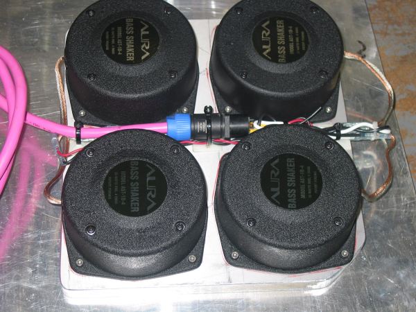

I am using 4 of them on a plate to perform sweep vibration tests for a superconducting magnet. I'll shake the thing, the physicists will measure cryostat and magnet response.
My question: the units are rated 25 watts apiece, and are spec'd from 20 hz to 100 hz.
Anyone have experience with these things? When I test the array by vibrating a 7 ton granite block, I notice that at the shakers' resonance freq, about 45 hz, we can hear harmonics. I assume that I'm hitting and exceeding Xmax for the devices, and that non linearity is giving the harmonics.
Is the power rating based on xmax at resonance? or is it a dissipation thing?
I've wired them in series, for 16 ohm total..that way, the physicist guys can't easily pop them with my amp..a qsc rmx 1450..
Any info would be welcomed..thanks.
Cheers, John

You might try calling Parts Express and see if anyone knows the deeper details.. They bought 'em all out as Aura stopped making them, as I understand.
I think there were 3-4 models even larger than these.. though I don't know if PE has any of them. They do have the next one up.
A suggestion... you could be to attach them in a different axis.. or up on the tube.. you might get more vibration per watt if they had an "easier" angle of effect on your device under test..

how heavy is the load you are shaking. what is the freq. range and max amplitude you desire. a heavy load will damp much of the vibration. what is application. do you need to shake at a particular freq. or freq range.
the aura machie is more apt for supplementing low freq audio signals. i have used them for that purpose with limited success.
for your application i would suggest something more industrial.
if you are in the US try www.eriez.com (http://www.eriez.com/pages/catalog/catalog.aspx?ItemID=324) or http://www.clevelandvibrator.com/vms.htm
if you are looking for something with a variable freq. range there are many cos. making such electromagnetic vibrators out there. like http://www.vibra-schultheis.com/eng/eng_an_03.asp
u can also get a unbalance motor such as one in the link below and use a freq. controller.
http://www.emagindia.com/unbalvi.htm or a simpler less refined but more rugged device http://www.emagindia.com/vibrator.htm

Thanks, guys..Knew I posted in the right place..
I forgot to include some app info.
The end result of all this will be a "final focus" quadrupole superconducting magnet, to be used for beam focussing for the next generation linear collider, a 30 or so mile long machine.
This quad is actually a lens to bring the beam vertical size down to 3 microns. Since two beams are aimed at each other, if they are misaligned by 3 microns, which is what will happen if one "lens" moves up 3 microns, the beams will pass by each other, with no collisions..which is the whole purpose of the shootin match..
Earth vibration levels, depending on the location, can exceed that number by orders of magnitude. Also, liquid helium going through the pipes to cool the magnet can also vibrate it at those levels.
I used the Aura's as a quick and dirty method to allow the physicists the ability to see a known frequency on their geophones. I also chose them, as it will be possible to use them in negative feedback mode, to actively reduce vibration..we are not very far along the learning curve there..
The final app will be at 4.5 Kelvin, and several tesla (the focus magnet will be within a 2 or so tesla detector field, so the aura's are definitely not applicable for the final machine..the iron in them will saturate, and they will distort the detector solenoid field uniformity. The final app will probably use piezo's with some reaction masses, capable of all three axis'.
Right now, I'm vibrating a seven ton granite table, and the magnet in the pic, which is I think about 5000 lbs..

So, basically you want an ultra-low freq actuator to counter the natural earth movements? look into the sensors used by highrises to counter earth movements(piezo strain guages). Also Aura was working with DOD on serveral laser projects in the past so contact them directly. I was given a demo of some of their systems in the '80s and I was shocked! They were able to LIFT the building on mag actuators!
Thanks...a building?
Yah..but I think up to about 100 hz..
Oh...and that 3 micron number... just found out, it is incorrect..
The beam height is 3 nanometers, 1000 times smaller, and about 30 atoms tall..
DOD laser projects?? Sounds like they had to do the same thing with light that the guys here have to do with electrons and positrons.

Re: Thanks, guys..Knew I posted in the right place..
7 tons = 14,000lbs? right? + 5,000 lbs magnet. = 19,000lbs so we are talking in orders of 10 tons here right?
to add to that you wnat to operate at 4.5K and 2 tesla!
try http://www.walkermagnet.com/ or http://www.ldj-electronics.com/

Ummmm...Yah...so, where's the difficulty???
Thanks for the links..
So far, I ran the setup from 5 hz up to 200 hz.
At 5 hz, the reaction mass of the shakers is too small to significantly vibrate the test stand..my amp specs at 3 dB down at 5 hz, so I figure it was about 30 to 50 watts excitation. So, the noise from the equipment in the building swamps it out.
At about 25 hz, the shaker vibration is evident in the integral plots..to the tune of about a nanometer or so.
As the frequency goes up, the power level required to saturate the vibration transducers goes down fast..at 80 hz, I have to reduce the output 6 dB..at 200 hz, gotta go down about 26 dB.
The transducers are either velocity, or acceleration type..
Cheers, John
