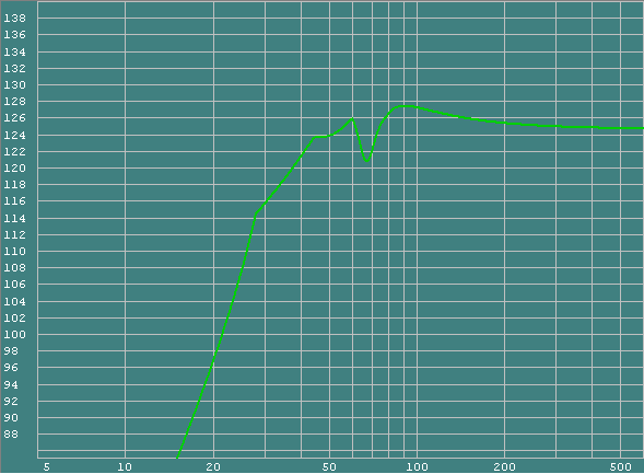

Hi, yeah good catch ! I was also simming a BR round about the same time, so i expect i didn't properly check the image i uploaded. Anyway you're correct about the lack of LP on the sim. Just redid it with the same driver Eminence Kilomax 18, & it's the same. Don't know why ? Maybe someone else could try & see what's happening 😉

I have tried simulating the design posted in post #17 using Akabak but i did not have much luck getting it to work any better than a parallel tuned 6th order bandpass ...
