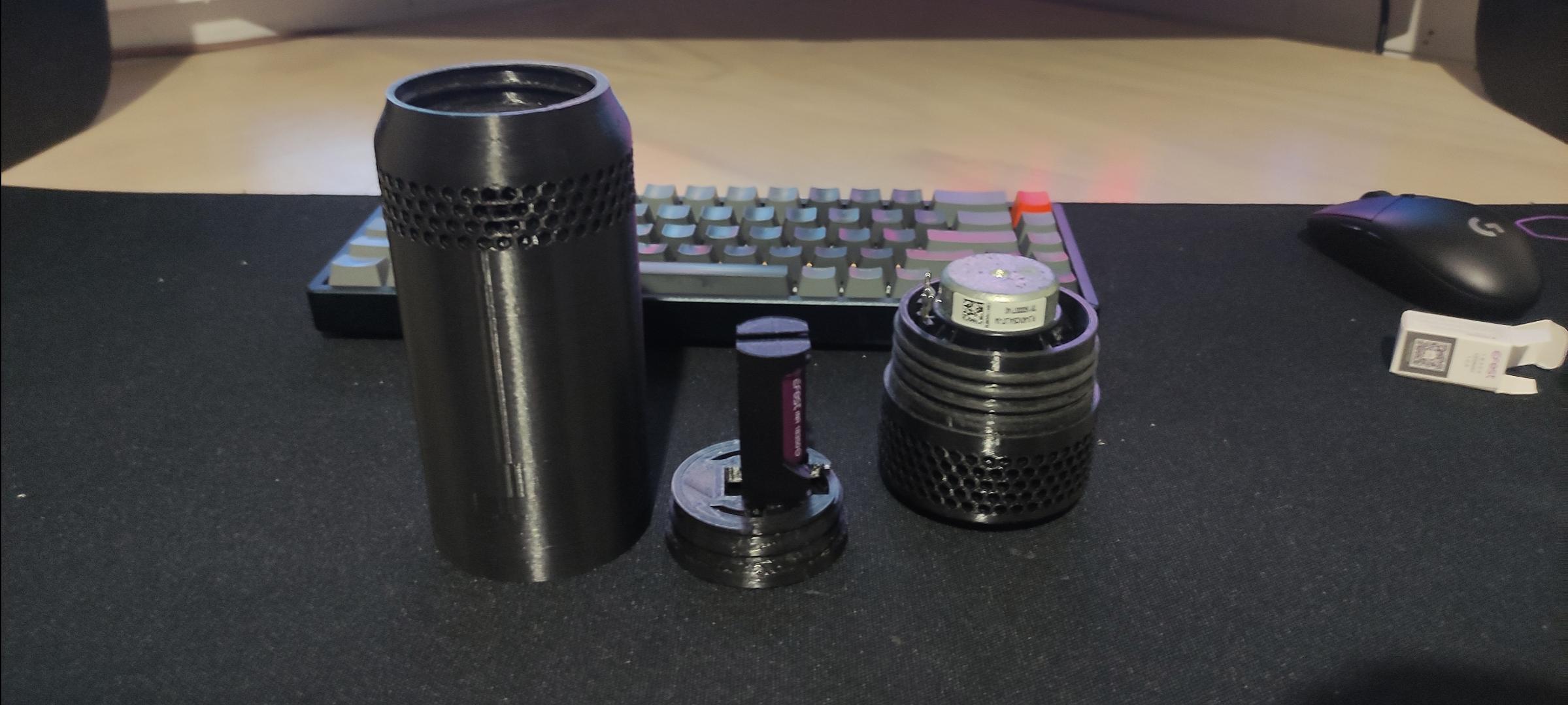

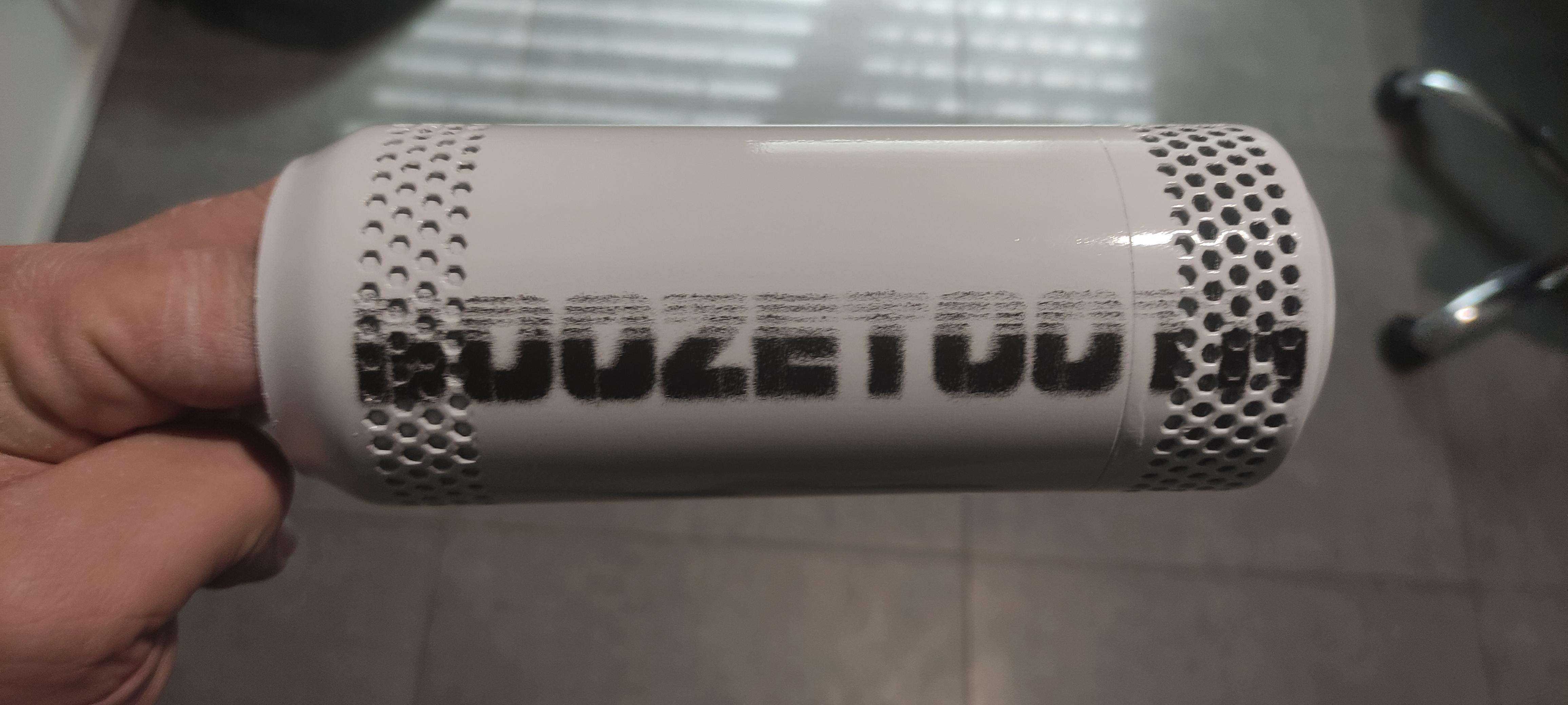

I have a few builds which are basically 3d printed 500ml beer cans with a downward firing 2inch full range and i want to use the amp as it has the ability to be modified through the BT chip and use custom EQ settings (and it is small).

I actually have this one....
I'm able to access the Bluetooth module and change the EQ and name etc, which the board is 35*30mm and puts out (apparently) 5 watts a channel, found a step up module and integrated 1S BMS which is about the 2/3rds the size as the amp so it will do.
Just need to find a good EQ setting to compensate for a 2inch driver in a 0.015cuft beer can to lift the bottom end without burning through the 18350 battery (1200mah) which I the next challenge
