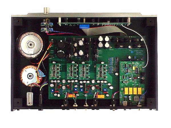

Hi all,
i just wondering about piggybacking the PCM1704s to achieve more output current. Maybe some pins should not tie together or bypassed together with a cap? It would be wonderful if the master Pass himself can answer since the D1 24/96 is no more in production.

that phrase only tells that 8 pcm1704 is in use. It can be
option 1: the output of 2 pcm1704 are tied together (parallel)
option 2: all the pins of 2 pcm1704 are tied togehter (piggyback)
I want to know if option 2 is possible without damage.

This picture will not answer your questions, the last ones...
But it seems that they were not piggy style connected.
It is a poor picture, but ... one can see that 2 pieces 1704 were mounted to
some kind of adapter. Don't want to speculate any more.
