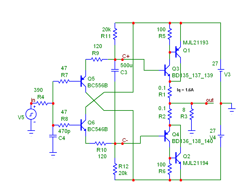

I usually do valve stuff but have accumulated some nice Sanken complimentary pairs and the dead guts of a Zen V3. I want to build something which has a fighting chance of comparing with my Class A PP valve amp.
I came across this design when searching and it looks to have the virtues of elegant simplicity and Class A operation. Has anyone built it or anyone care to express an opinion on its potential performance.
Details are a bit scant, and it doesn't even suggest potential power output. I only need about 8Watts of good class A.

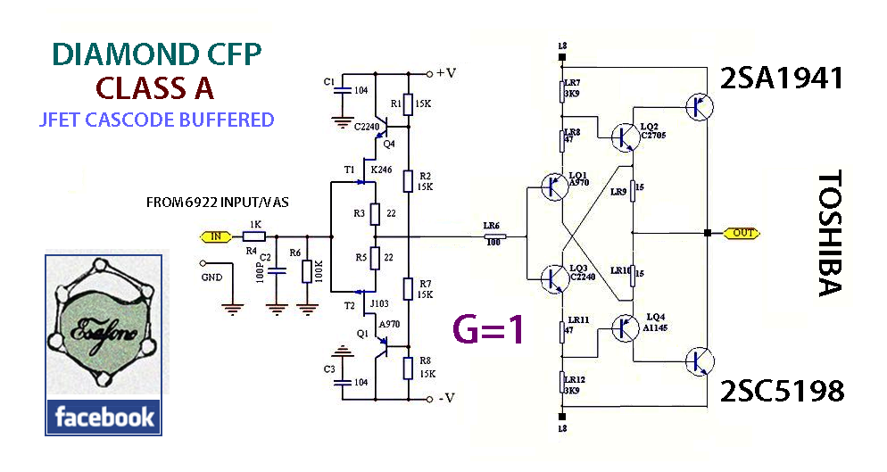

I've built and used the second half without the last pair. Prefered it modified to use a jfet
in and a Mosfet out... but it's a good buffer...
I'd suggest you try the Pass F5 if you want to beat up ur 300B PP amp... of course the specific parts you use for the F5 will change it's sonic appearance rather a lot...
Otoh, why not try something like what you have shown... not sure how the two parts shown got combined, as they seem to be from different sources...

Drawn as it is, the output stage won't work. Stee draws stuff like that all the time...
If you want BJT power buffer that much, you can try this (Push Pull Pure Class A "Hot Follower 99" Amplifier
designed by: Andrea Ciuffoli) - at least, it will work:

So how about Pavels Buffer.
This is a proven design right ?
Though it would seem that a quick look at the outputs datasheet suggests they are an entirely different beast to the Sankens I have.

PMA Pavel's buffer is much better.
If you want Class A.
You can count on he has fineadjusted as much as possible.
You can trust his circuit.
For other voltages than 27V you should change R11/R12 accordingly.
You should be able to use other OP Transistors.
Some would even fit better.
THe output pair are not critical to that circuit

Thanks for the input.
My understanding is that this circuit is capable of 35W class A. My valve experience says I need just 8W to be happy. The transformer I have is a beefy 12-0-12V AC so would be running just +/- 16V DC.
It seems this buffer requires about 15mA of drive from the front end.
The Sankens I have to hand are the 2SA1215/2SC2921.

I have spice models for 2SC2922/2SA1216. But not 2SC2921/2SA1215
As I told, I do not think there is much problem with what power transistors you use.
More important is to use 2 good drivers of the big transistors.

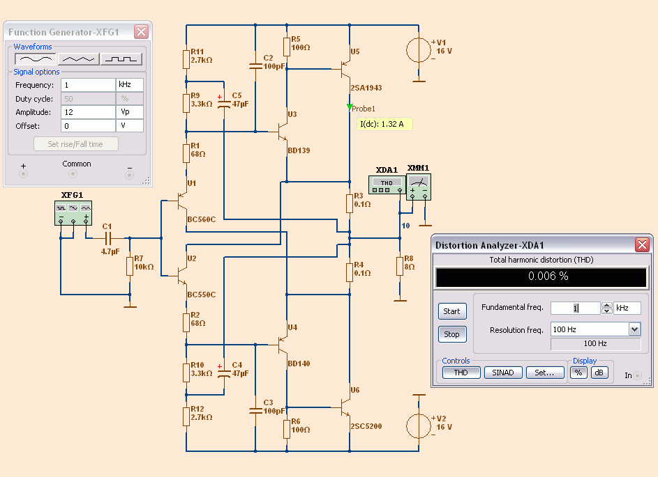

Here I post my take on +/-16 Volt Diamond Sziklai in Class A.
It shows very low distortion for being with No Feedback.
Input is +/-12 Volt peak, ~ 9 Watt RMS Class A
THD simulates to 0.006%
Output transistors are 2SC5200/2SA1943

I'd probably use a current mirror or constant current source/sinks rather than the bootstraps, but it does work. I use a smaller version (with TO-220 outputs) as a headphone amp.
So I am thinking I can build the output buffer in a separate case and then build various front ends in other cases to try out lots of different flavours.
