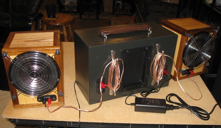

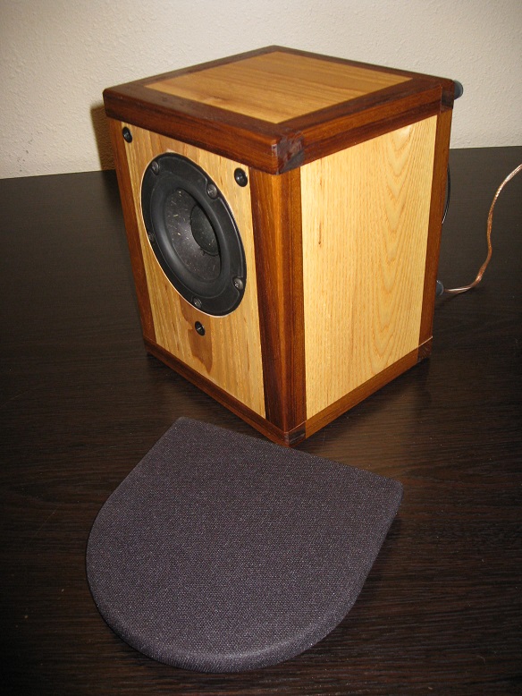

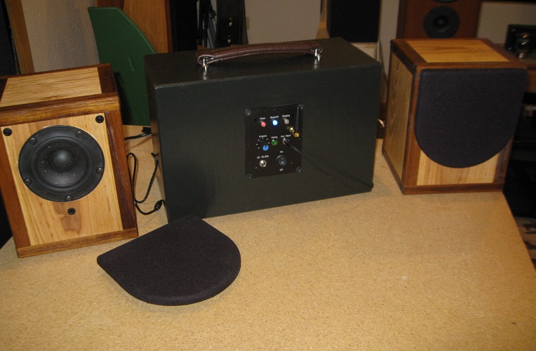

Here is a mini boombox project using Vifa NE123 FR with a 6.5" PR on rear.
Cabinets were made with white ash and teak.
Panels can shrink, warp, and especially cup if they have moisture content when cut and then dried to room conditions. If you can't get kiln dried wood, then joining the box soon after cutting will help keep the panels straighter and prevent cupping.
I cut the speaker holes before the white ash was dried -- and checked that the drivers fit at the time. A few weeks later, the panels dried and the cutout had shrunk almost 1/10th of an inch and the driver would not fit. Some careful router work with the right bushing was needed to enlarge the hole enough.
Another issue to be concerned with is finishing. Without thinking, I applied polyurethane to the whole box. The teak is waxy or oily, and the polyurethane was still tacky on it after 2 weeks. I ended up stripping and sanding it down to bare wood again. I ended up masking off the teak and only applying the polyurethane to the white ash. There are probably other materials and processes that would work better with that combination.

The boxes are 3.5 liters (IIRC), and the PR on the rear is a Dayton 6.5 aluminum cone.
There is also a contour circuit to tame the FR, laid out on the bottom of the box, inside. The sound is really quite good.
The setup was given to my wife's cousin for a housewarming gift. The center unit has a bluetooth amplifier with rechargeable batteries, features that they liked a lot.
