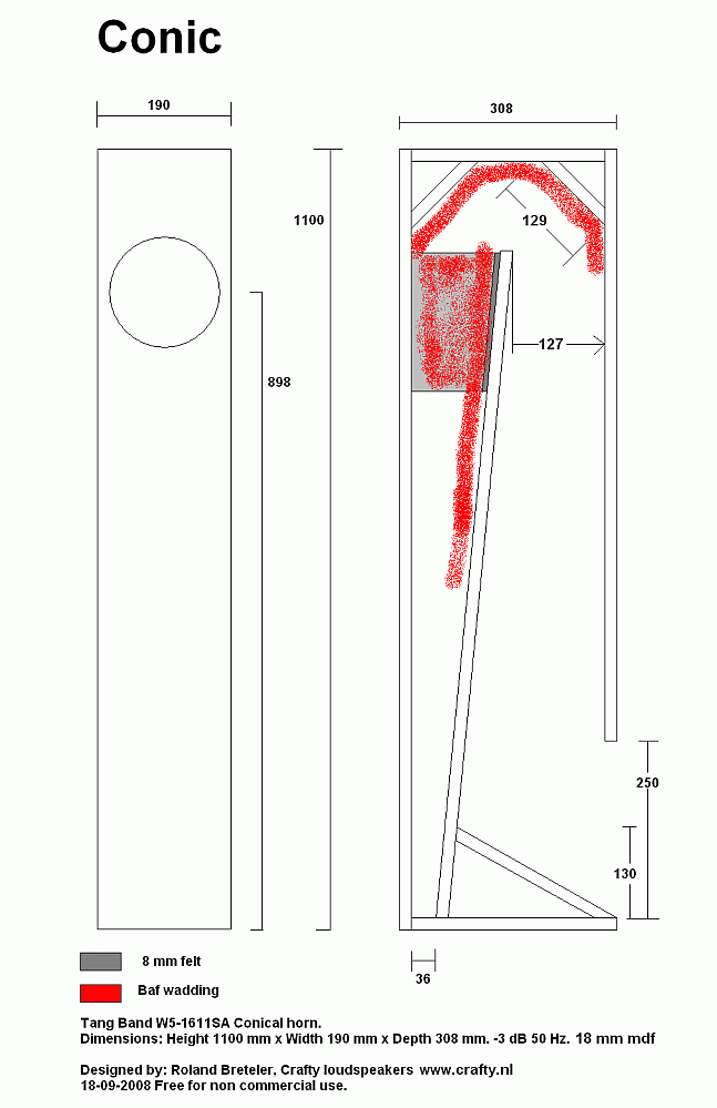

I think i saw a TB W5-1611 backloaded-horn somewhere in this forum. I did not save a link and it has been a while so i can't find it anymore.
would be glad to receive some more information!

Great, thank you very much Henkjan!
I think you are the one who developed this horn, right? Did you make any measurings you could post?

If it's OK for you i'd like to post your drawing in the hifi-forums Sarah-Thread. Some users are also interested in a W5-Horn. Does it have a name already?

I did not devellop the horn, that honour goes to Roland Breteler from Crafty loudspeakers.
I did not measure this one, since I did not have it long enough. but from the tonal balance I expect the usual midrange 4dB orso hump that you could flatten using a Baffle Step Correction. but I would advise to listen to it first, the tonal balance is not unpleasant and makes voices sound even better. already after a few minutes listening your brains will have gotten used to it and does not bother anymore. only when switching between loadspeakers it is clearly noticable.
The Sarah is a much smaller box, so I expect the main notch (the one for the BSC)would not be very good, you might want to try some of the smaller ones aimed at driver resonances (personally I think they are not needed)
