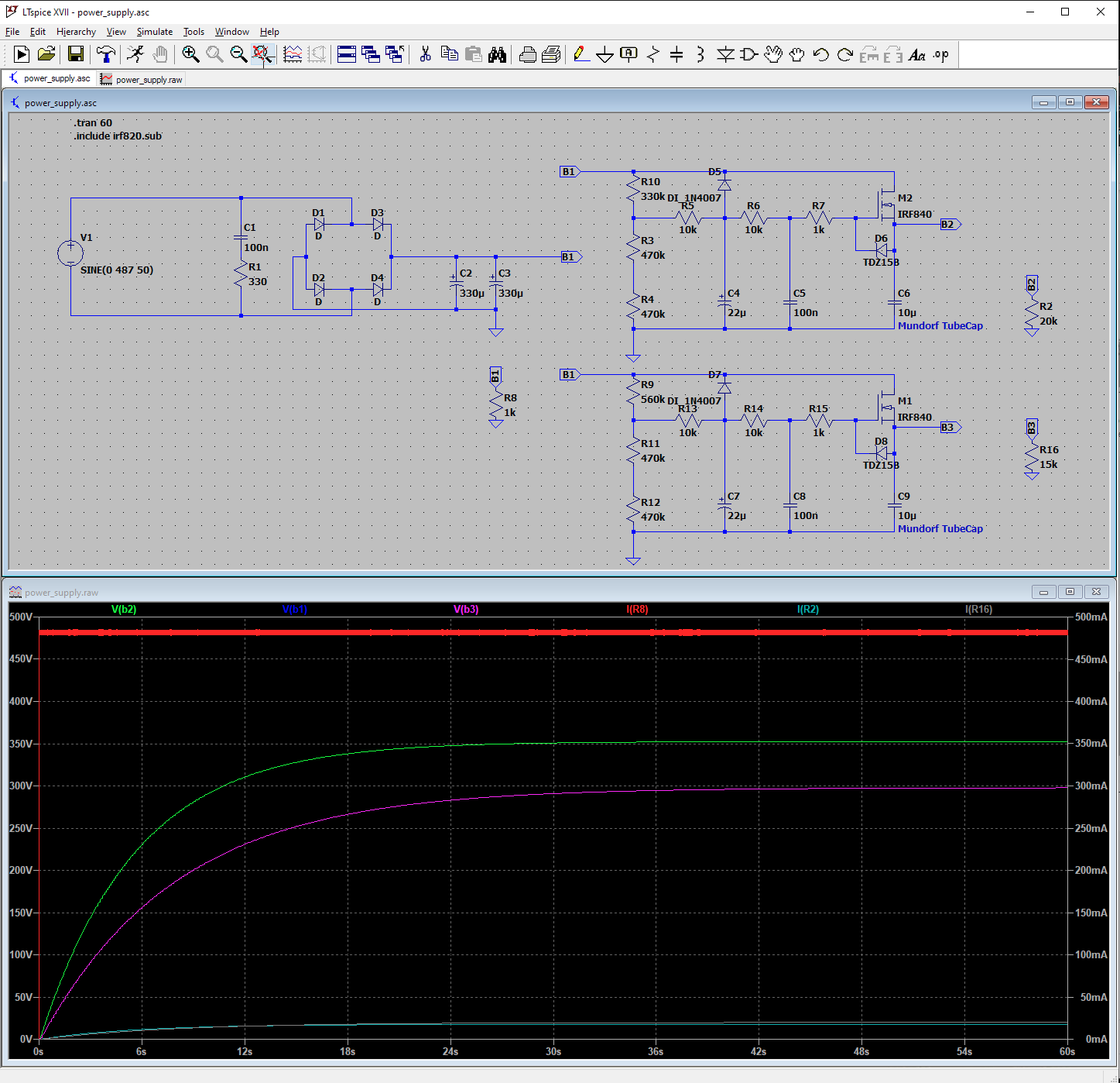

I terms of power-supply/regulation, I've had good results with the attached scheme for a KT88 PP build (480V B+, 300V for the grids and 360 for 90V/270V on ECC83 driver)
The PP-2c uses a big fat choke for the plate voltage and a shunt regulator... how necessary is that? Does that design have a clear advantage? I could re-use and adapt my existing design for the 450V/380V of the PP-2c but would it work as good as the original?
I still need to learn a lot abou power supplies so apologies in advance if this is obvious...
