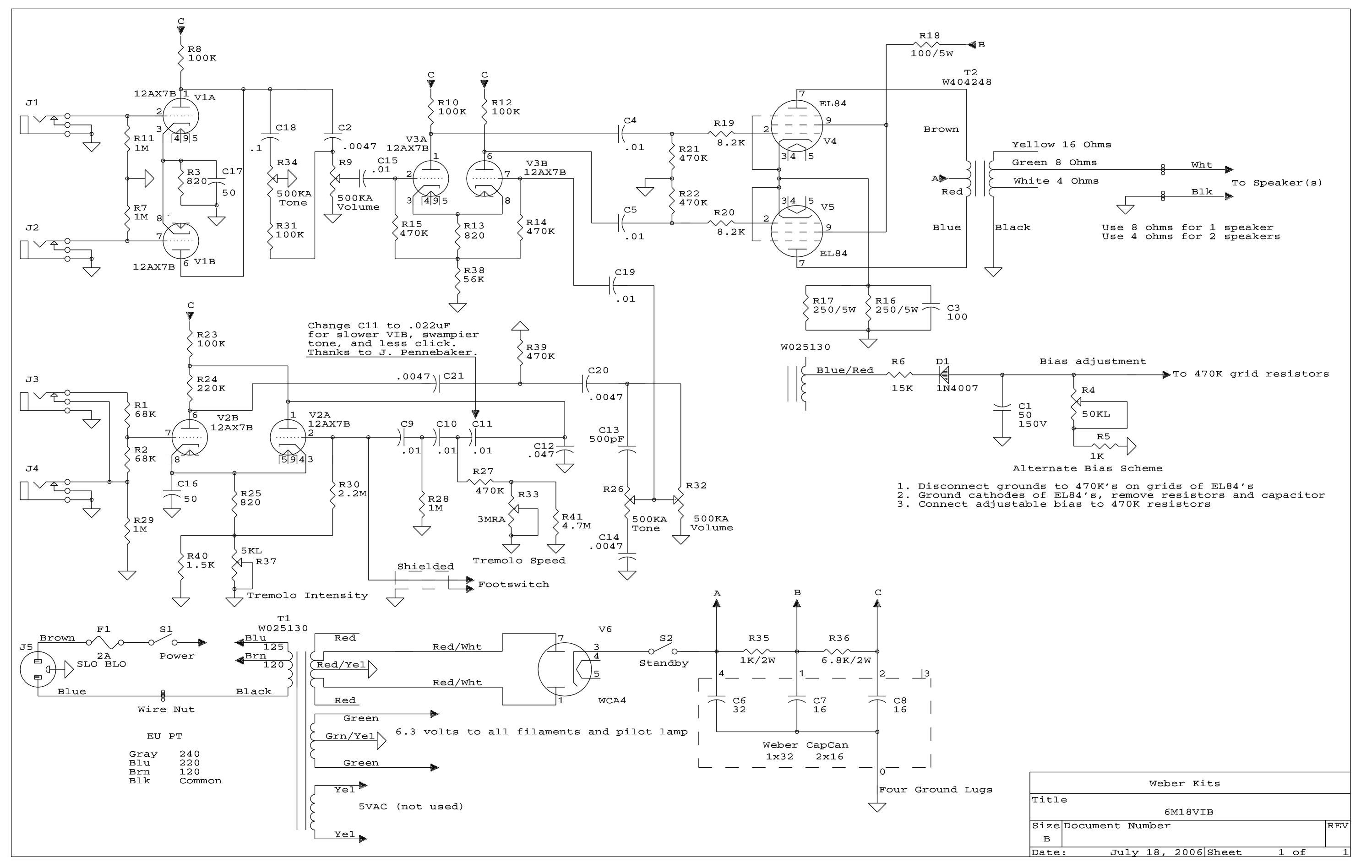

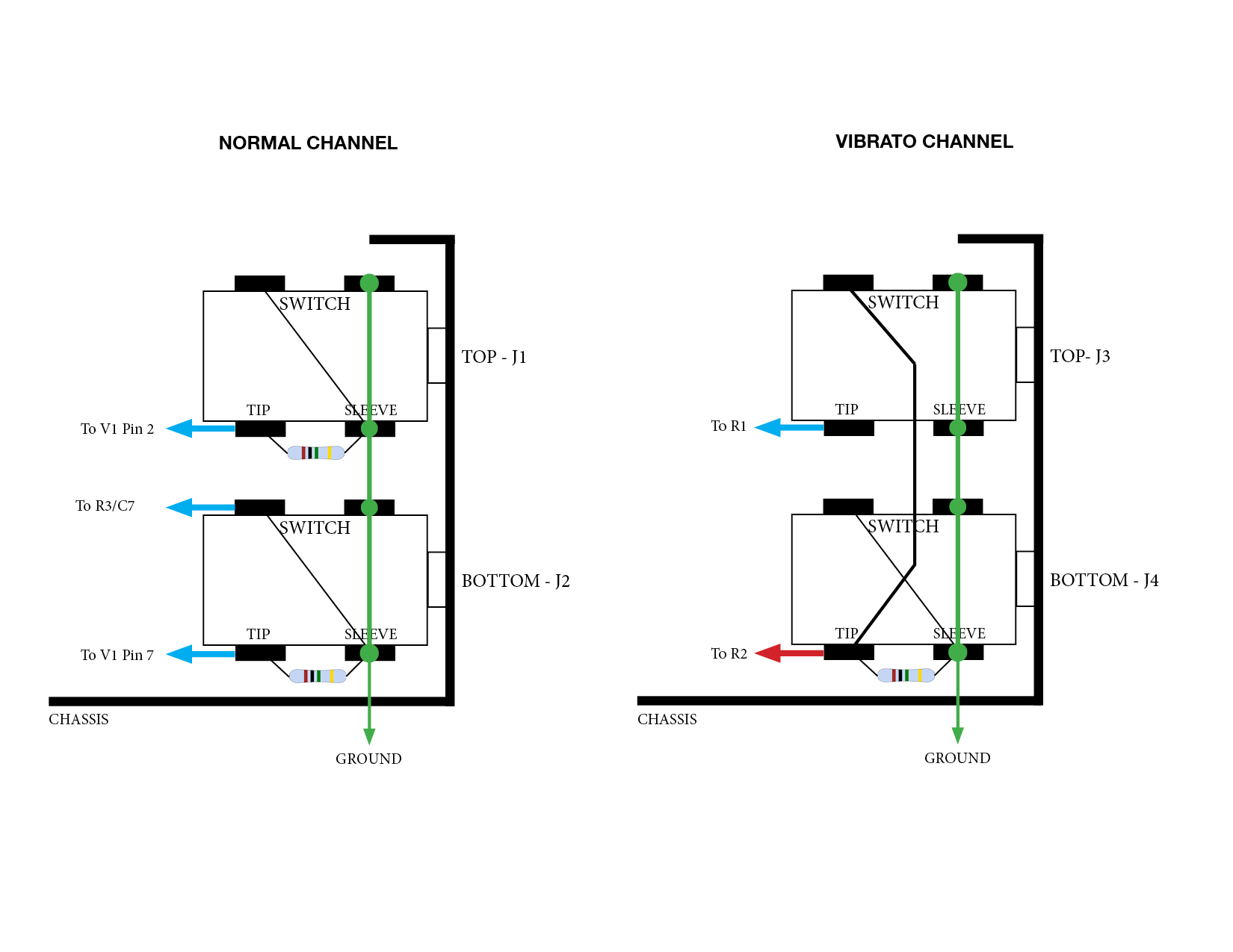

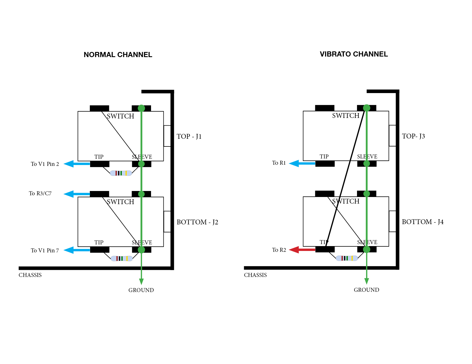

After successfully building a number of tube and solid state studio devices, I'm attempting to build a Ted Weber 6M18VIB ( 18w Marshall Clone ) combo kit.
I'm unsure of how to exactly wire the input channels and wondering if someone may be able to confirm and / or assist with clarification.
After reviewing the provided build layout and associated schematic, the attachments here are my best swing at completing wiring configuration.
Any thoughts or comments will be greatly appreciated.
Thanks in advance!
