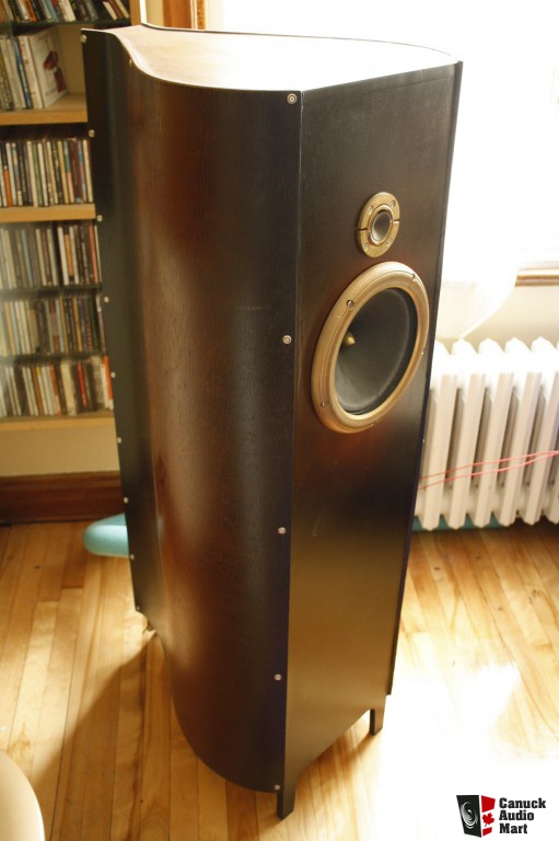

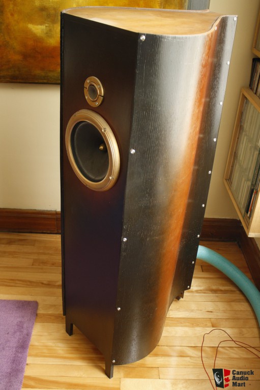

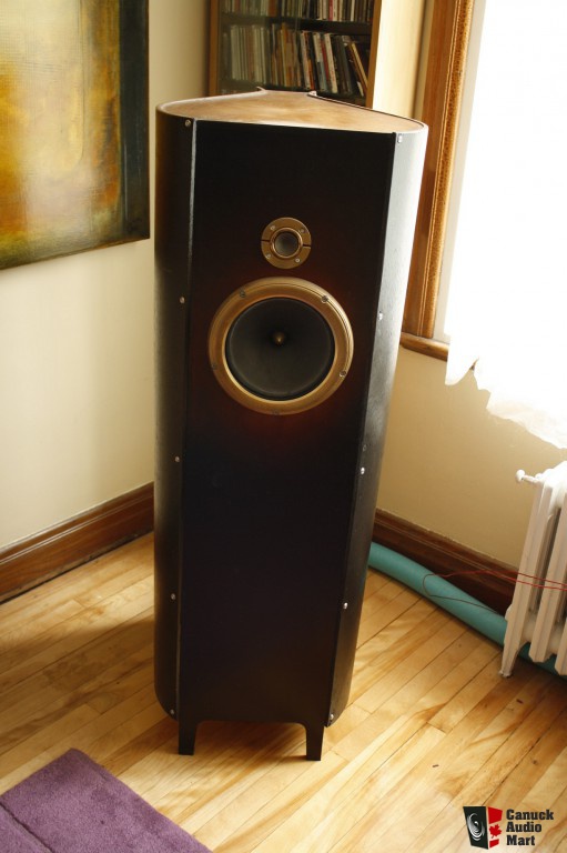

Daze,
Those look very nice. Is this an open bottom design or rear vented? If you have photos of construction that would be appreciated. How do you bend and hold the side plywood panels in place?
They are opened at the bottom and semi-open in the back. There are only two small braces inside. The sides are made of ¨Perform¨ plywood. The front and back are Birch.

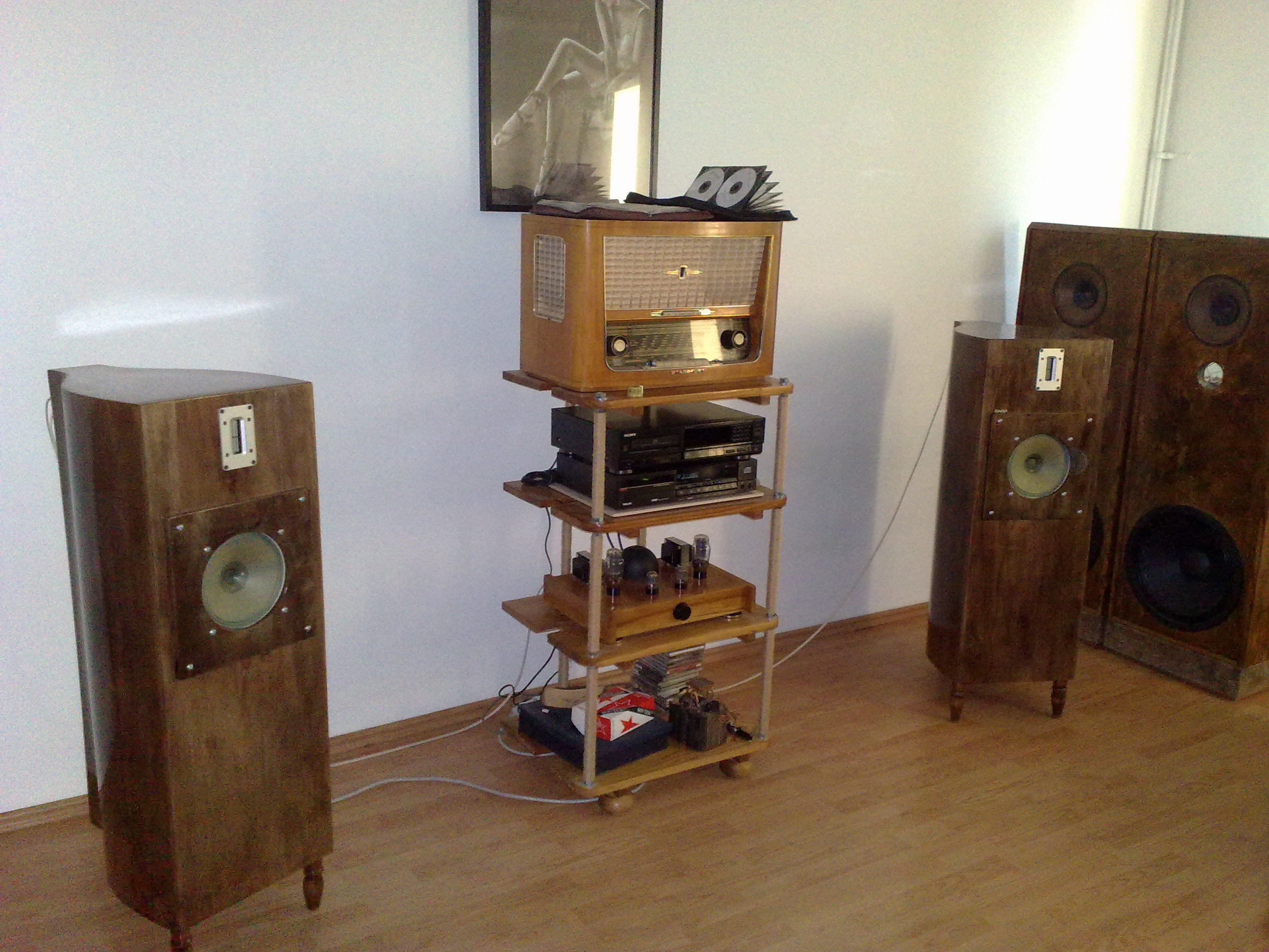

Hi there, i have made a pair of rondo...all i can say is that the sound it's 'different' in a good way compared to conventional speakers. Very good bass (short and fast) , very dynamic and good rhythm with instruments. I have tried different types of speakers in these cabinets, and sabas are not the best ones but sound good indeed. It' s very important to choose the right length for the legs...
I recommend this type of enclosure...it s beautiful, sounds awesome and looks spectacular.
