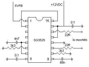

Yeah i'm still designing mine, like i've got a schematic done fairly close to robs, and then trying to make a neat single sided pcb (not really possible). I've had some helpful hints from this forum, like the output inductor thing i haven't decided on yet, but i might try them if the voltage feedback fails to work.

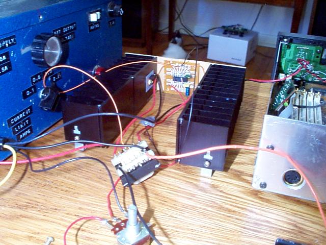

first picture is "everything"..... blue powersupply was in the end set to 18 volts as it has a 2.5 amp limiting circuit, and the voltage was dropping a fair bit, even with it set to 18 volts no load, it still dropped to less than 9 volts when the volume was turned up...
the amp I ran from it was the one I am/was building into a CD player case with a computer... I think I'll scrap the idea... 😛

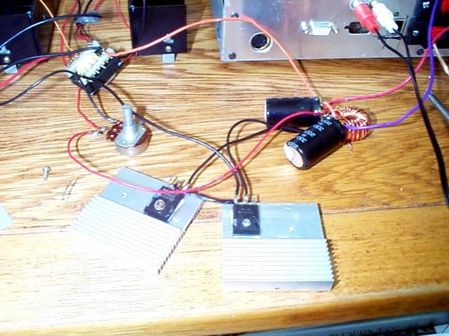

here we have the diode thingos mounted on their own heatsinks, not insulated from them... when you touch the heatsinks, the amplifier goes off... lol
the transformer, some filter capacitors, and outout inductors.. 🙂 and the pot I have been using to adjust the voltage.. 🙂🙂
