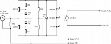

🙂I don`t know if i got it right, but here is a versatile and easily built mc step-up.
Transistors are still available at LC audio.
This circuit can be made to fit inside the turntable if wanted.
And it sounds damn good.

Thanks Pdul,
I am not a transistor guy (prefer tubes), but it looks simple enough and cheap enough to try it 😉

🙄😀I don`t know how it measures regarding distortion etc. But i know that whenever i am
using something else, i miss it, " that clear sound of the singers nipples scratching against the shirt without drowning in noise"
