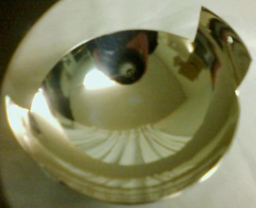

Because the reflectance of silver is highest of any material (ie. up to 98.5%). Chrome (53% I think) is actually lower than stainless steel (65%), so chrome plating it would lower the reflectance. The only material competitive with silver is aluminum (95%). This is why mirrors are made from silver or aluminum, or some of their close relatives on the periodic table.
Silver tarnish is oxidization of the surface layer into silver oxide. But if you heat tarnished silver, it drives off the oxygen and becomes pure silver again. I do see some tarnish on the little mounting tabs of my reflector, but none on the main surface. The lamp heats it up enough to un-tarnish it. The mounting tabs don't get hot enough because they lose heat to the mounting hardware that is not exposed to the lamp.
I think you can get silver coated with a transparent lens coating material like magnesium floride, but I have not needed it.

best reflector
Sounds like you should just go with stainless steel.
I measured my screen Lux with and without my silver reflector, and I found that it adds 22% more light. Apparently, the arc chamber of the MH lamp is not very transparent. So when the light is reflected back through the arc chamber, some of it gets absorbed. Of course, it also has to go through four layers of glass, so that accounts for more loss.
The point is: You can run your projector without any reflector at all, and the screen image will only be about 22% dimmer.
If you are the type who enjoys "holy grail" quests: The very best spherical reflector would be a dichroic glass mirror. (AKA "cold mirror") This is glass with a frequency-selective coating that lets >90% of the IR through, but reflects >90% of the visible light (and UV). If you can buy one of these, then much less heat gets reflected back into the lamp and on into your LCD.

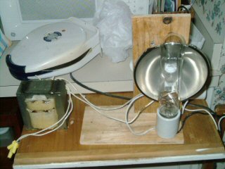

I think the only reasonable DIY approach is to make your own custom reflector from aluminum, polish it up very well, and then put a piece of hot mirror or IR selective film between the light engine and the fresnels.

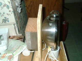

Shiney stainless steel nearly perfect half-spheres in various sizes:
http://www.dr.ca
Then click on Pastry Moulds/Rings/Shapes in the left pane.
Then click on Stainless Steel Moulds in the right pane.
Then scroll down to Stainless steel half sphere moulds. (NOT Ovale)
They have various different sizes, so you can pick one to match the size of your lamp. A 12 cm diameter is about right for a Ushio retrofit lamp. Smaller would be okay for double-ended lamps, but using a larger one than you need doesn't hurt anything but your wallet.
