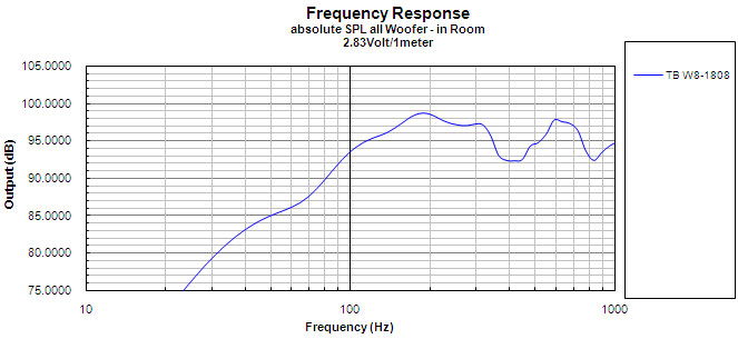

I got this sim for the 1808 on that baffle (36"x31"). Not sure how to account for the wings but it's all part of the experimentation and fun of diy. The sim is not super smooth but i have given up on smooth response charts and only follow the overall trend bc the room contributes so many variables. It's impossible to sim and expect it to be exact. But the overall trend allows you to build something and listen to see if it's about right... and then you tweak. It's a big speaker but if your room can accommodate them along with the woofers you want to connect for bass support you should be able to blend the two around 100hz.

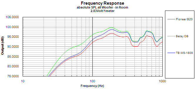

Another sim with the Pioneer B20 (BOFU) and the Betsy full range driver. I have all three of these drivers to play with.
I haven't even finished my current project (using the 1808) and already want to build something with these 36" x 32" baffles!

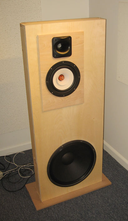

If anyone is interested in taking my 21" x 46" baffles they are free to someone who wants to pic them up. I live on Long Island, New York.
