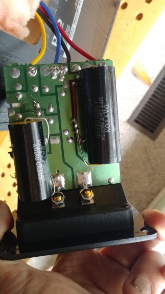

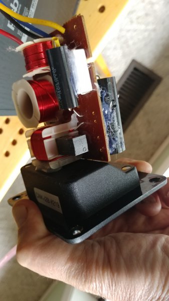

@wingding611 Sorry it's taken me so long to respond. I documented what I did on a thread on AudioKarma. Here's the link if you want to see it.
You're right about not being able to get 8.0 uF caps but the original caps are ± 10% so I went with Dayton 5% Poly caps, 1.5 uF, 8.2 uF and 12.0 uF. 8.2 uF ± 5% is well within the 8.0 uF ± 10% range so the 0.2 uF difference shouldn't make any real difference.
I have to say the result was quite good and well worth the money spent on the capacitors and the time spent making the mods. I've tried attaching a couple pics of the modified crossovers. See if it works.
Someone is probably going to point out that hot gluing a cap to a resistor is potentially risky if the resistor gets hot enough to melt the glue. It doesn't. At least not with the little 20W stereo unit I'm using these speakers on. It only has enough power to get decent volume out of those speakers but not enough to really push them so the resistor never gets that warm.
At any rate, the Image 2Bs sound a LOT better than they did with the original caps and the modified 2Bs sound waaaaaaaaaaaaaay better than the original speakers that little stereo system came with so the project was well worth it. The system is just for my cabin so all I wanted was something inexpensive that sounds decent and that's what I got. I recommend that anyone who's got an old pair of 2Bs kicking around and wants to use them make this upgrade. The differences are quite noticeable, pleasing and well worth the effort and expense.
