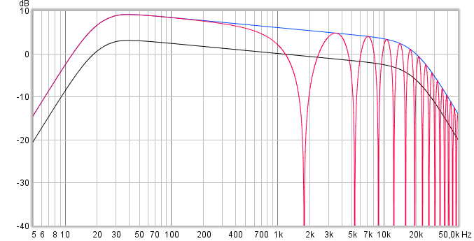

For those being skeptic about some of us that like downmix stereo signal listening to mono speaker please have a look this thread (Fixing the Stereo Phantom Center) for a lot of native inherent problems no matter if one think stereo is great or not. Also its probably not for fun center speaker and 5.1/7.1 systems were invented plus there is research all over world and universities where they sometimes seems use up to hundreds of speaker to improve on acoustic performance for indoor use.
Think not this is the right thread to discuss this subject but thought because of critics that one could post a short note about some of the trouble above link look into. Real stereo system is supposed to be setup as true balanced stereo acoustic triangle with exactly same response from left verse right speaker and how many have that right from the start, also because think its not the most easy or interesting stuff to do in real world. Below show the big error we get for stereo when same material is fifty/fifty (panned) to left and right speaker, black is our 20Hz-20kHz band-pass signal sent to left and right speaker and blue (+6dB) is what we would have liked to see when summing 2 times black curve but sadly distance to our two ears from the same signal coming from left and right side is not the same so we won't get the nice blue one. Red curve is the comb looking error we get using a 0,28mS delay to simulate head related erros. Have no problem myself that most really enjoy their stereo system setup whether its technical tuned by the book or not, but think below show that a stereo feeded mono system can probably be alright too.

And no doubt that open baffle sounds pretty dynamic, as you will get some energy arriving after the main wave front at the listening spot to fill in the Stereo cross talk errors. 😉

BYRTT is an avid fan of mono, personally I do not think the theory he shared is a red herring. If you're willing to work on it you could hear it for yourself. Just not as easy with your current open baffle setup.
I expressed my subjective preference for Stereo with tricks. Tricks based on the comb theory. I guess I killed a good thread with it? 🙄
Avoidance of early reflections would be enough to be able to notice this phenomenon. Directional speakers could help one to get there.
After first correcting my speakers with FIR filters, absorbing most of the early reflections trough strategically placed damping panels I noticed the same thing. Which made me look past this problem to find the "why".
I believe the single speaker would do better than two speakers playing mono. The phantom part is mono played trough 2 speakers. Less than ideal.

This is what I was thinking of:
Comb fi ltering, repetition pitch: Colorations can be created
when a sound is added to a delayed version of itself. When the
result is measured, we see a repeating pattern of peaks and dips
in the frequency response, which is why it is called “comb”
fi ltering. In some circumstances a pitch can be perceived that is
associated with a frequency defi ned by the inverse of the delay.
The effect is audibly obvious if it occurs in an electronic signal
path or if there is a single, strong vertical (median plane)
refl ection in an otherwise echo-free environment. However, for
refl ections that arrive from large horizontal angles and in
normally refl ective spaces where there are multiple refl ections,
the effect ceases to be a problem.
