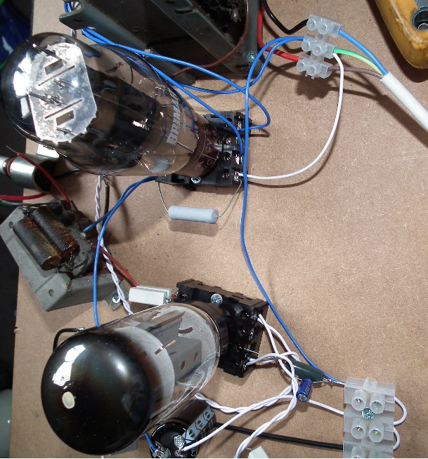

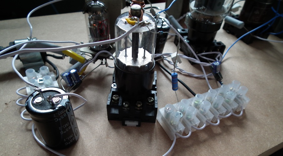

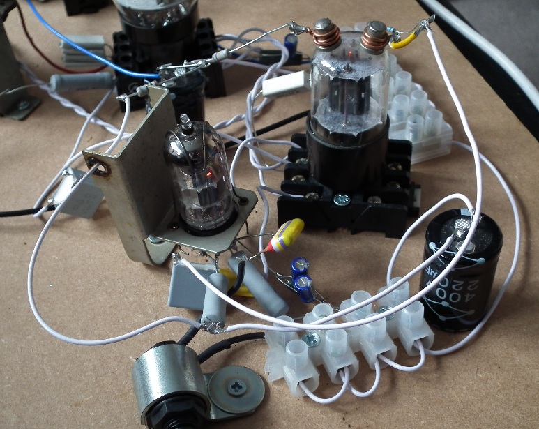

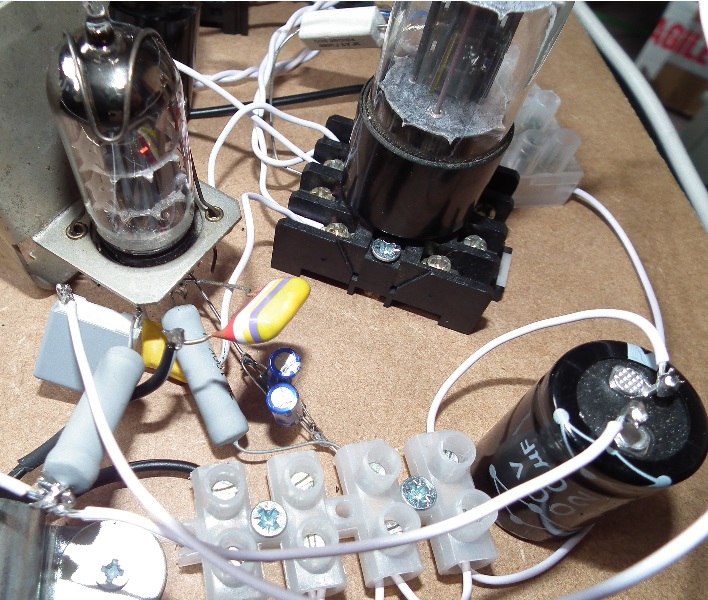

Here's what I've been building.
Got some interesting clipping from the 6550, as the grid goes positive when it gets loud.
Methinks there's some work to be done there, but I'm pleased I've got it working.
