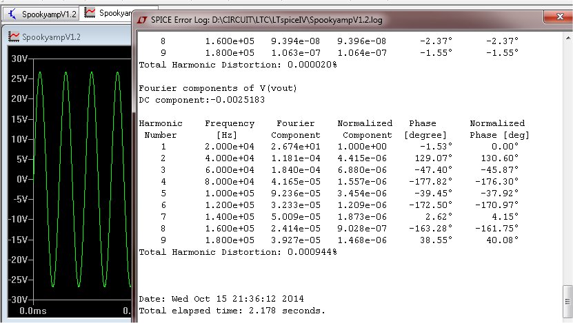

IN 20 DAYS , powered by a hawksford VAS (spookyamp).
The professors circuit was quite inspirational , but easily beat. (below)
This is actually tested by builders and the H/K 990 <.001%thd20K 50w.
The professor's EF3 is the best OPS short of an error correcting one.

They seem to like it ? The HK990 got stellar reviews as well. Leach V4.5 uses a
zener based cascode only , I use zener + cap multiplier.
SOME swear by the even faster slewing CFA input stages.
PS - I like the fact that this design has to same 10ppm @ 100w as it
does at 1w. It also has the most 😱 semi's (18).
