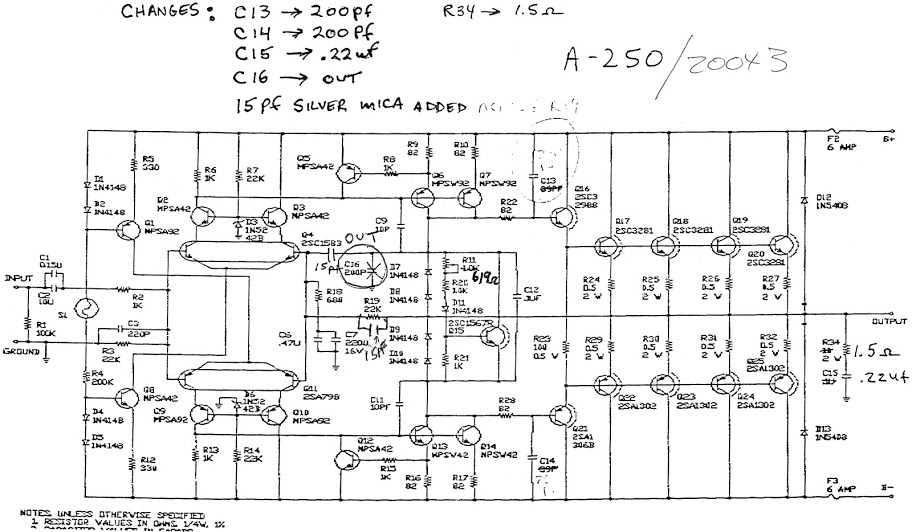

It is a 3 channels power amp. There is no model number other than 200X3!!! I just want to see whether there is any way to improve the sound quality. I don't have the schematic, I got it 16 years ago.
1) I don't use the third channel, should I disconnect the third channel from the PS?
2) Will increasing the PS filter cap improve the sound? Something from simple to more complicate.
3) I remember it has really big electrolytic caps, will paralleling caps of lower value and even film caps to lower the ESR help?
4) Paerallel wires to beef up the output connections, beef up the high current traces.
Where can I get the schematic of Acurus?

Break the supply lines to the front end and insert a small value resistor for isolation. Now add bypass caps on the front end (suggest 100µF plus 0.1µF film), add bypass caps to output stage, try around 47µF plus 0.1µF film with a 1Ω resistor in series.

You mean adding R32, R33, C13, C14, C15 and C16 to isolate and bypass the differential and the current mirror stages.
Then add smaller caps like 47uF and 0.1uF ceramic caps in parallel with the huge caps onto the pcb to lower the ESR and better high frequency bypass.
"You mean adding R32, R33, C13, C14, C15 and C16 to isolate and bypass the differential and the current mirror stages."
Exactly.
"Then add smaller caps like 47uF and 0.1uF ceramic caps in parallel with the huge caps onto the pcb to lower the ESR and better high frequency bypass. "
C21, 22, are 22µF in the Leach, C23, and 24 are 0.1µF, but add a 1Ω in case you have grounding issues (causing oscillations).
You may also want to add C2, 3, 4, 5 (Leach) to D3, 6 (Accurus).
Try increasing C12 to 2.2µF (or even higher), this will change the way the bass will sound.
I would try removing Q1 and Q8 and run resistors as the CS as per the Leach.
You could also try splitting the driver emitter resistor and using it as a feedback point (as per the Leach), may require an oscilloscope and a lot of fiddling.
Unfortunately you can't degenerate the diff pair like a Leach (because of the dual transistor package, although you could use matched discretes glued together).

Thanks a million. I pull one of the power amp out already and still make the other two work in the system. So I can take my time fiddling with the one amp outside. So far, I check all the transistors numbers and both the Q number and the part numbers match the schematic. I check a few components and they match too. So I think the schematic I posted is the right one.
I have to remove the pcb from the heat sink to do anything as the traces are all under the board. I definitely going to double up the output wires as the wires are like 16 gauge only. The jumpers are also very thin.

Hi DJK
I ring out the circuit, it's matches the schematic I posted. I feel a lot better. It is easy to do part of the mod you suggested. On top this is what I am going to do:
1) I am going to put 10uF caps across D1 & D2 string, and D4 & D5 chain and beef up the ground trace from D1 to R5, D5 and R12. Then to the input ground.
2) Beef up the ground trace between the ground of C6 and C7 to the input. This is to reference the NFB ground to the input.
3) I am going to increase the resistors you suggested to isolate the +/-V to the input and driver side from 1 ohm to 51 ohm. This is between R10 and collector of Q16, and R17 and Q21. I calculate the current drawn of the input and pre-driver from each rail, it's only 12mA. Let's just say 25mA. 51 ohm only drop 1.25V on each side. Q16 and Q21 are both emitter follower, their is no problem if their +/-V rail is different by 1.25V. then the filter caps will work a lot better.
4) Should I increase the idle current by adjusting R11 to get more current through the power transistors to get more into the Class A region.
I think it's better to leave Q1 and Q8 there as these are constant current sources or CCS. CCS improve power supply rejection.

"I think it's better to leave Q1 and Q8 there as these are constant current sources or CCS. CCS improve power supply rejection."
What could be more constant than a resistor to a zener stabilized voltage (Leach)?
Active CCS usually measure a bit better, but passive CCS frequently sound better.
The only real reason I can see to keep Q1 and Q8 is the over-temp thermostat shuts off the CCS when the amp overheats.
You're welcome to play with the bias, but tests with an IM analyzer show this type of circuit has a sweet spot for the bias that is actually quite low, and cranking it up will increase IM distortion at higher frequencies.

The reason I am searching for better sound was because I bought the Acurus when I had a pair of Kef floor speaker. Then I bought a pair of JM Lab that is much higher quality. In the process of testing the JM Lab, I actually brought my Acurus to the store and ran the speaker. My big mistake was I compare the Acurus with a Ybl amp there. It was day and night difference. The Ybl sound fuller and richer with my speaker. Everything else was the same, same song, same preamp, same speaker and same room. Just A/B comparison.In my area, $5,000 US can buy you a big, reasonable sounding amp or a quite good sounding small-medium. amp, They may be premium models from budget brands or vice-versa. Either way, there is always some unaffordable masterpiece that will sound better from an imagined perspective, at least.
I take up amp building as a hobby, built two guitar amps, I think it's time to build an audiophile amp. I was in the tube section here, but I still have lot to learn about audiophile electronics. So I decided to work on my Acurus as a stop gap for now and wait until I learn more and decide on what to build.
I am sure there are easy things I can improve a little. I remember I went into the Kef and beefed up the wiring and the traces in the crossover, it did improve the sound a little. I think even the manufacturer sometimes over looked the interconnect and pay too much attention on the circuit and electronics. Simple beefing up the connections sometimes can do magic.
I traced the input ground traces, it uses thin 12mil trace running all over. I beefed up with 16 gauge wire, adding filter caps on the zener and separate the front end from the power section. We'll see whether that improves a little.
One main reason I am reluctant to remove Q1 and Q8 is I would be doing big changes. And I need good reason for that. Are you saying using resistor tail make the sound better?"I think it's better to leave Q1 and Q8 there as these are constant current sources or CCS. CCS improve power supply rejection."

I can think of one reason constant current is better. The amp is like an opamp in non inverting configuration. This means the input of the differential pair move up and down with the input signal. This in turn change the tail current and give modulation. Constant current source is superior in the common mode rejection column, that's the reason all IC opamp use constant current source for the tail.
I am not familiar with Leach. Is it supposed to be high end amp? Other than the Q1 and Q8, the design between the Leach and my Acurus are quite similar.
"Are you saying using resistor tail make the sound better?"
Yes.
"I can think of one reason constant current is better"
A resistor to a constant voltage with a constant load is by definition CONSTANT CURRENT.

As I said that the power amp is very similar to an opamp in non inverted configuration. The differential pair bounce up and down with the input voltage. The input can move +/-1V. The tail resistor will follow the input and the tail current change with the input swing. That's why you need constant current source. BUT that does not mean it sounds better with constant current. Maybe the modulation of current improves the sound.
Do you know what is the zener voltage Leach use to set the voltage across the tail resistor?
Here, look at the Eagle drawn schematic and B.O.M. for the 4.5 version.
