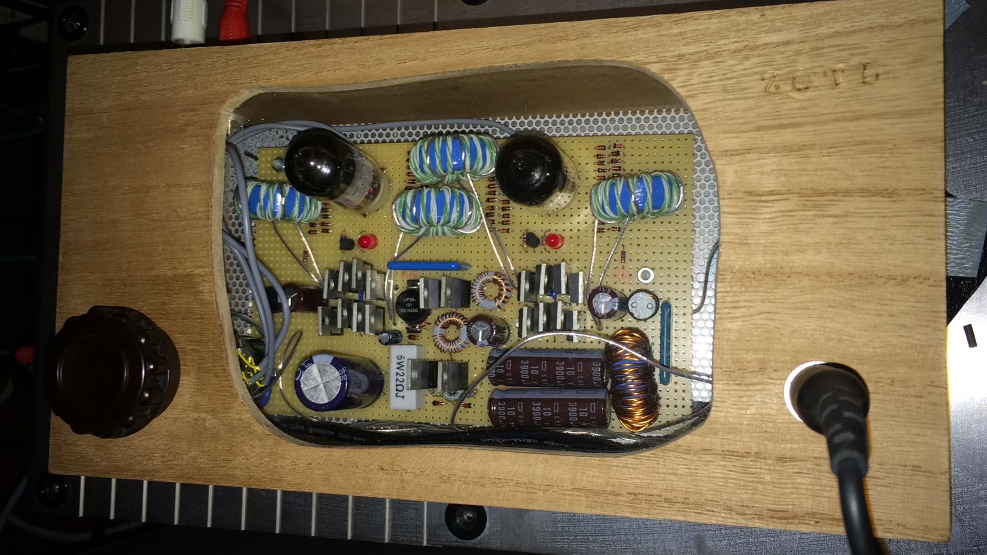

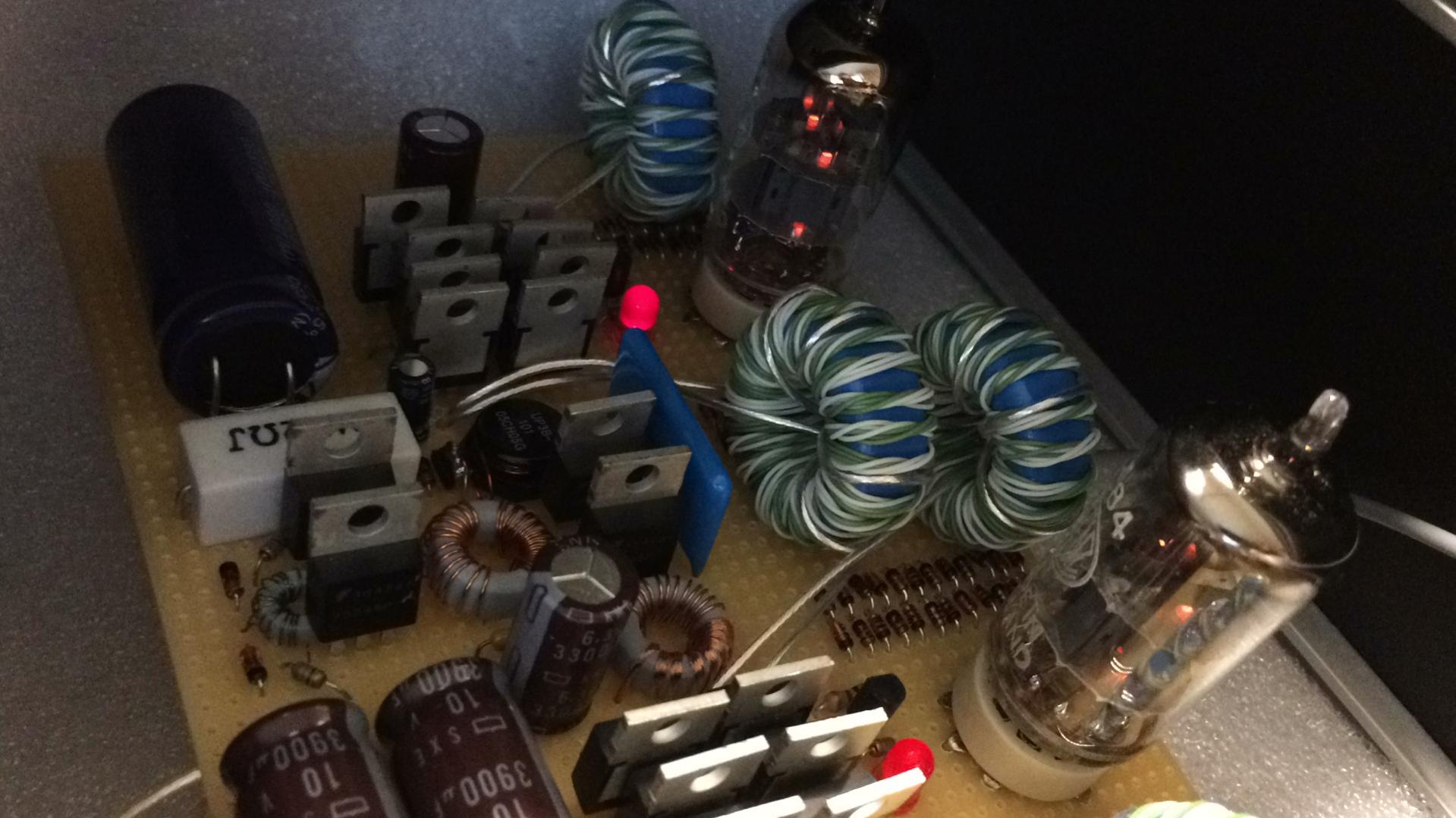

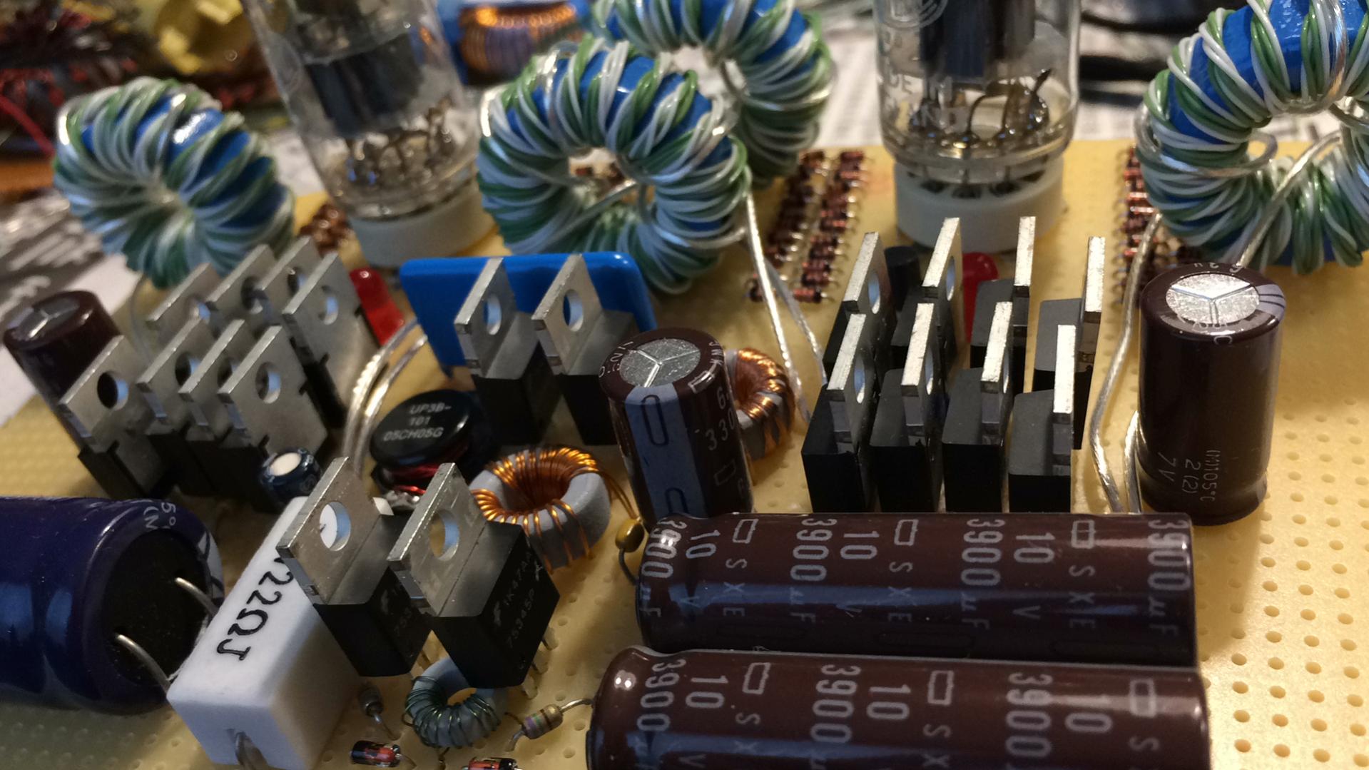

Still using this headphone amp of yours (the very exact schematics, 6N1P-6N6P) and I'm so grateful for this simple design.
Just swapped my 26 Ohms headphone to a Beyerdynamic DT 770 PRO 250 Ohms.
DC voltage is 300V istead of 280 due to some oversizing of the transformer load and it doesn't drop that much as I expected, otherwise the thing is working since more than a year flawlessly without any error. Oh and swapped diode bridge from 1N4007-s to Vishay Ultrafast Hexfreds, not sure if it brings any advantage but they're already in. (With 2x 470uF in parallel after that, per side).
Now what I notice with the 250 Ohms DT 770 PRO is that hum is higher, it appeared again. Heating was AC and I managed to route it properly so that it doesn't pollute anymore, then I switched it to DC heating to fully eliminate any residues from the heating side. Running at 6.1 volts now, specs say 5.7-7 so I'm good with that (intentionally).
So it might be only the anode voltage side to let in some hum, already played around with RCA inputs, ground (star, bus), whatever... changed tubes too.. it simply doesn't disappear fully. Can't think of anything else than anode side. When I switch off the amp and it still plays for more than 10 seconds easily, at the very moment the power relay releases, hum is gone.
Now I'm considering a cascade LC-LC filtering with 2x 2H chokes (or 1 LC with 10H choke would also be sufficient probably), anyway, the 2-pole LC is stronger (steeper curve) than the 1-pole RC (existing one)... according to this article. I hope it will help, just need to look for some extra space in the chassis..
I thought I just mention this. Output cap block hasn't been swapped yet, it delivered good bass at 26 Ohms, now at 250 Ohms bass is "whoaaa".
I'm considering to use less capacitance here for the 250 Ohms (still maintaining no perceptible bass loss at ~20-25Hz). I'm wondering what might be a good value, 100uF or even less ?
It's 6x 100uF electrolytics now (per side) with film on top of them. Maybe I could utilize an all-film block and get some good 10uF film caps to connect in parallel. The chance of failure of 6 electrolytics / side (12 altogether) is a bit high here for my peace of mind.
Apart from the slightly reappeared hum, I'm still very satisfied with the sound, surely the DT 770 PRO needed a hefty EQ to get back to flat (and then slight "V") but it's very enjoyable now. The Takstar Pro 82 was (is) much more pleasant without EQ, in raw state, but the amount of bass is simply nowhere to the Beyer.. this 770 PRO can be driven really hard (at least to my taste), close to pain levels while still just delivering all that bass, so at normal listening levels it has all that dynamic reserves.
Last question here: approx. how many milliamps does this design deliver at 32 Ohms/250 Ohms/600 Ohms ?
When I've had hum that goes away as soon as power is removed, I look for ground loops (short the input is there still hum?) or magnetic coupling of the PT to the tubes.
47uF should be enough for high Z. Perhaps make it switchable so if you use your old headphones, there can still be bass.
This is why I don't bother with linear supplies for this... If you use 37kHz, you can't hear any noise, right?
The current is the same no matter which output Z you're using. The power will increase with high Z though. It'll put out over 1 watt into 470R but like 20mW into 16R.

Thank you for the tips, I'll make some extra test rounds regarding this ground loop idea.
PT is resin cast toroidal in stainless steel chassis and at about 10cm to the closest tube. The behaviour doesn't change if I unscrew the transformer and lift it up/take it out of the chassis so I assume it's not the reason.
I'll still look for some extra possibilities.. caps are 10+ years old, very simple Daewoo brands.. I don't have a cap tester but both sides are consistently behaving this way.. so I assume if it would be a capacitor issue, maybe there would be some difference between them (although water dissipation is the same for all, roughly).
Anyway.. I'll check ground again.
Thank you for the power info, at least I know what to expect from this design approximately. 😎
