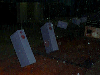

I built a set of speakers about, well, 10 years ago using those same 12s, same tweeters and 5.25" Vifas. I was actually pretty happy with the way those subs sounded at the time.
Man, that was a long time ago. It was in a straight forward vented alignment tuned around 25Hz, IIRC.... A single 3" I.D. port was all that was needed. I was a really good match to that tweeter and mid.
I was powering it off of a 100wpc NAD reciever at the time and they really did good. Honestly, I think they might surprise you. I pretty much designed the cabinets like the NHTs of the time, I'm sure you'll see that.
I never ran into this problem with that 12", but the 15" series II had serious mechanical issues, they would bottom out very easily, without audible distortion or any other precursers to let you know they weren't happy, and at mediocre power levels, I was not happy with the 3 or 4 of them I had used, they sounded good, but I was always afraid they would be damaged.

Really? Same tweeters even? Pretty amazing coincidence
Do you think you could dig up anything on the enclosure design? Do you recall what the F3 was? How did the tweeters perform? Hopefully well. It would be great if i could integrate those tweeters and woofers into my goals.

I can't remember too much, but I am pretty sure the woofer had 2.5-3ft3, there was a very small chamber behind the mid/tweeter, and the rest of the cabinet was for the woofer. The cabinet was actually a lot bigger than it looks in the picture, it was quite deep really.
For the crossover, I think I had copied one that Madisound offered as a kit with those same tweeters and 5 1/4", It could have been some other manufacturuer, I don't know, but I copied that part. Then I just did an additional 2nd order electrical high-pass on the 5 1/4" at around 100Hz and a 1st order lowpass on the sub around 80Hz, IIRC.
I couldn't give you an honest opinion of the tweeters. When I built those I was stationed in Korea. I had built them in our Vehicle maintenance work bay, it had taken almost a month. I made jigs to cut each piece one at a time with a skill saw. Everything was sanded by hand and I sprayed about 5-6 coats of Dupont primer/filler and a buch of high gloss black enamel coats over that, with tons of wet sanding. It was such a miracle we completed them there, that we (and everyone around us) thought they were awesome.
The tweeters were probably a little bright/harsh, but we didn't care, We all still thought they sounded, real, real good. In a medium size dorm room that had concrete walls(we all lived in these quarters) they absolutely got down, they imaged real well, had good midrange and really hammered out the bottom end. But still, this listening wasn't under much scruitiny. We were really just having fun with this project, take it for what it is I guess.
