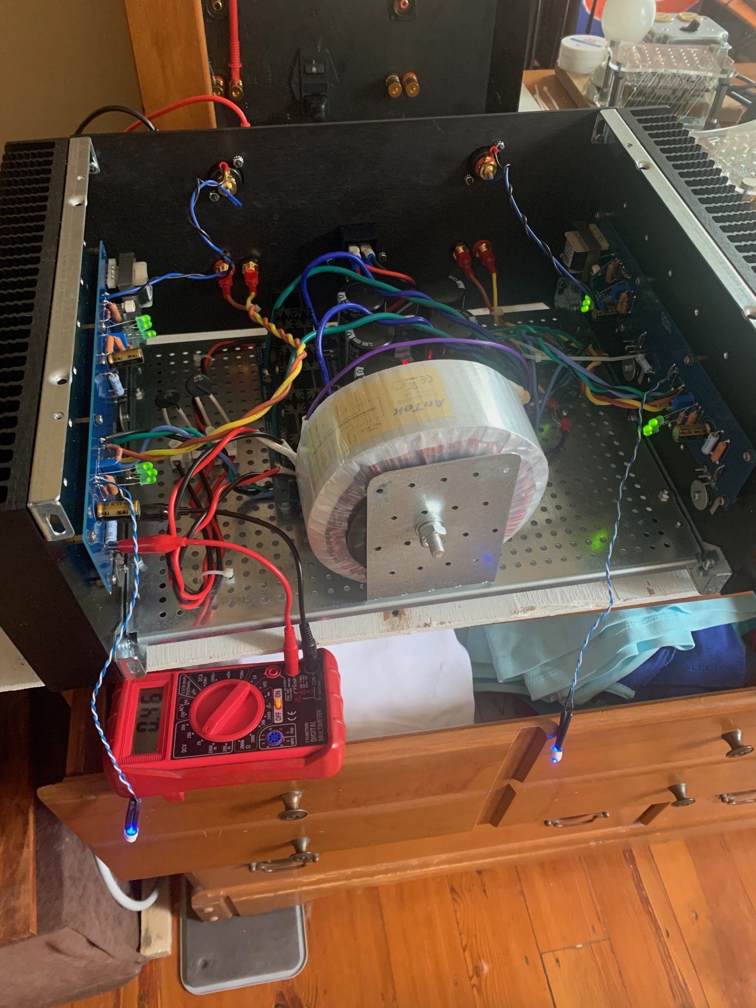

My lovely F6 has a toroidal Antek transformer mounted with a bracket so it is standing on it's side in the case and it gives off a VERY low level hum, audible when near the Amp, and also though the speakers if you put your ear a foot or so from the speakers. I am putting some rubber padding under the transformer but also want to wrap it with aluminum foil in hopes of curtailing EMF interference on nearby wires. I know I have to be carefull about not shorting anything out. My question is, how effective can I expect aluminum foil to be as an EMF blocker?
A picture is worth a thousand...perhaps this will help understand the situation. It is an ANTEK AS-4218.
PS- I want to eliminate the possibility of Type 3 hum, as described earlier in this thread. I think I've got the mechanical type fixed with a bit of rubber matting under the transformer.

It may not be the orientation of the transformer itself that’s causing a problem. Two separate channels, separated by distance, with a power supply sitting smack dab in the middle is probably the best way to create a ground loop. Hint: the input cables close the loop, so think “outside the box/amplifier”. Just a little radiation, from anywhere, and hummmmmmmmmmm.
