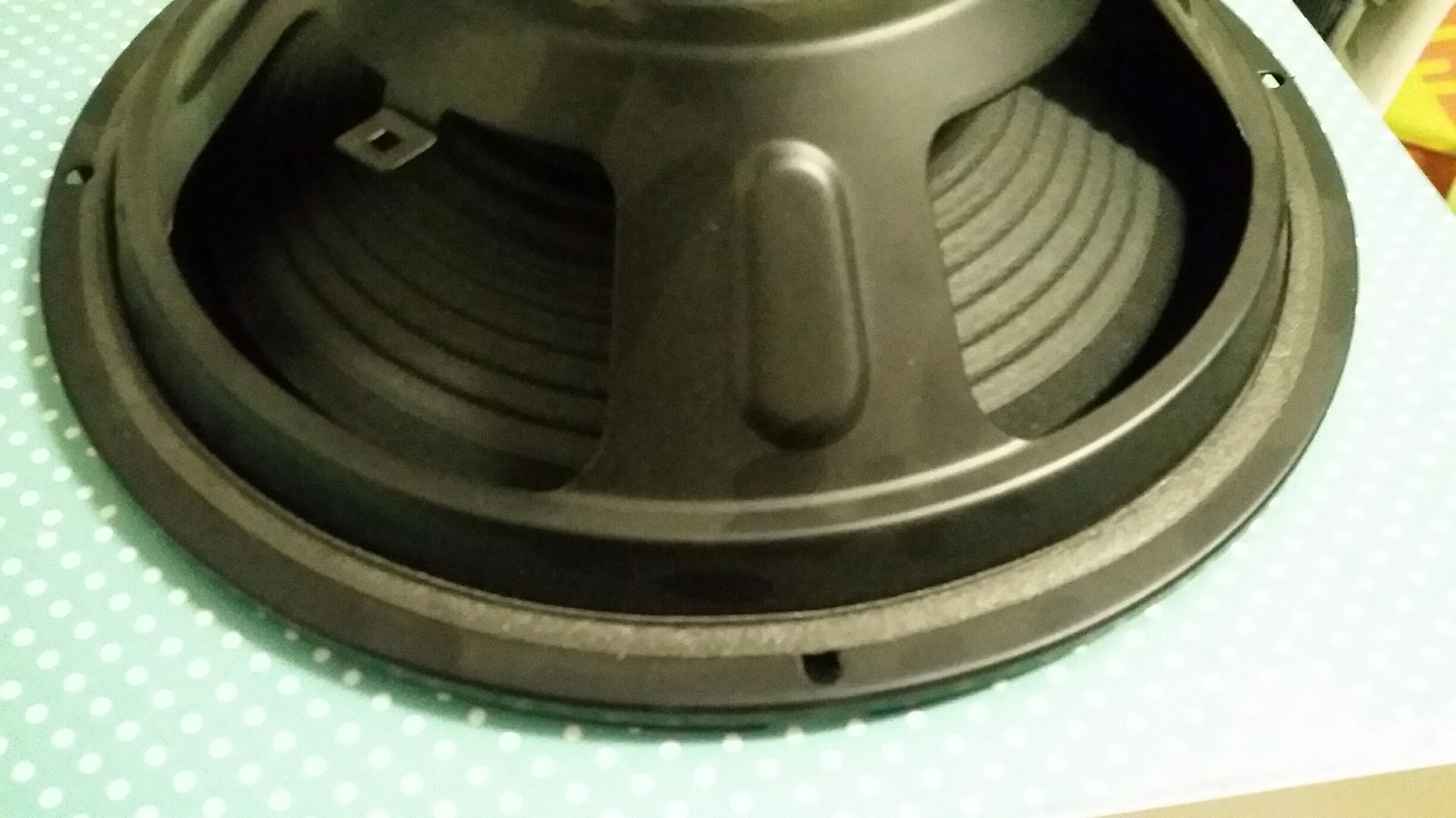

It's a cheap stamped chassis with a fair lip on it already mate, the walls of the cabinet aren't terribly thick either so I don't think chamfering will yield much improvement?
If I decide to put a new midrange/fullrange in that will definitely need some work.
Makes sense then. I was thinking they are thin and won't be effective that much just now, logged back on re-check
Hard to get much glue into a joint like yours, with the end grain compromising adhesion. Your box is really narrow so I would glue felt on the side walls near the woofer. My other standard trick not yet mentioned is to reinforce/damp the flat area on the basket between the struts and the magnet. It is a structural flaw that all high end drivers correct with the struts extending directly to the magnet structure. SB Satori for example. I use plumbers' putty. "Extreme Basket Tricks" is an old thread here that covers this subject.
I thought someone already mentioned plumbers putty on the chassis? I've done it myself years ago in a bass reflex 8" full range design, don't know if it helped at all though?
I don't have any felt but I do have heaps of the foam displayed in the first post so that will be getting liberally applied.

Cross bracing, along with shoring up the woofer's cabinet connection (even making a bad square of reinforcement behind the woofer and longer screws where you can helps here) are likely to give you the best bang for buck mechanically. Earl Gedlee recommends lossy cross braces for dampening, which makes sense. A little half-lap or laminated structure glued with a lossy adhesive (use whatever scraps you have!) to bridge across panels wouldn't hurt.
My description is no good. I'll try to make a picture. Other recommendations follow what's been given: internal ribs screwed only on the ends and again adhered with a flexible adhesive makes for a decent poor-man's CLD, too.
I have had good results from dampening the internal faces of the speaker cabinet. Like BBC style cabinets.
I have used rubber type carpet underlay in the past - Carpet tiles with bitumen layers are what I am using at the moment, stuck down with contact adhesive.
Don't over think it though, use what you can source and have fun!
The bracing you showed in post 39 will not be very effective as the braces need to be near to the middle of the panel to resist flex. Placing the braces a little off centre can help as the the differing lengths will have different resonant frequencies.
