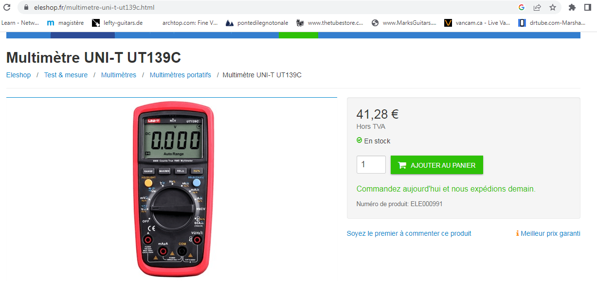

Hi, Im looking to get a new multimeter ( on a budget ), maybe TrueRMS as well. I found this one any thoughts? .
UNI-T UT89X

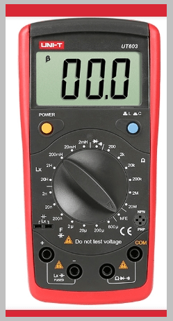

I have two UNI-T LCR meters and they work satisfactorily : a basic UT-603 and a more sophisticated UT-612
That said, I never tested their DMM. I rely on my two FLUKE FL87-III, two FL87-V, an one 8060A, but certainly UNI-T offers good DMMs, if I state by the good performance of their LCR meters...

for the money, the uni-t ut139c is very good
Yes indeed - IMHO, don't expect the ability to measure, accuracy and repeatability of a FLUKE 87-V, but also take in count that this is a 10X higher priced DMM ! 😕
But for 42 Euros, the UT-139 is fine, so go for it... 😎
