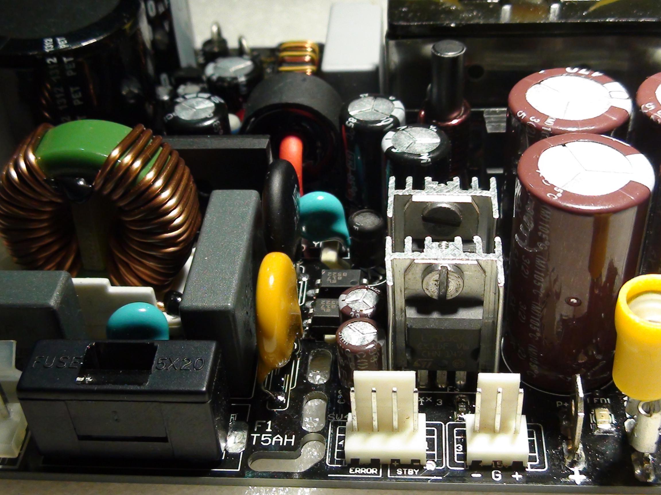

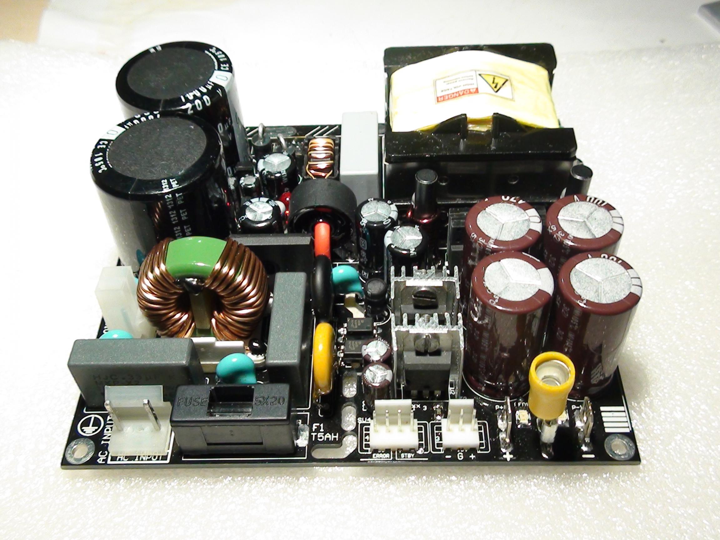

I believe that my SMPS perfectly fits your needs, if you are looking for an Unregulated SMPS.
Power is just 600W, Peak 900W.
Available voltages form +-40VDC up to +-90VDC, with +-15V Output. +-24VDC Output, +12VDC FAN output, and DC Error detect + Standby input.
Its yours at 65US$.
12CM x 11.2CM

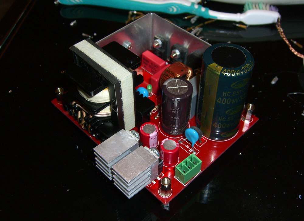

Cool, i actually use an LLC resonant power supply made by a friend of me.
attachment.php
Configured to run at single +37-38V.
With +-65V/2A at 120kHz it has >97% efficiency. Those are 270W, 400Wpeak.
