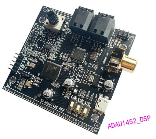

Any suggestions on which DSP to be used for 8 channel I2s out with 2 channel input? To be interfaced with TAS6584
Is there any DSP chip simpler way to implement with TAS6584 chip as the amp chip input is with I2s. Something simpler like in the image with SPDIF input.
This ADAU1452 board (several vendors on Aliexpress) has both TOSLINK and coax SPDIF connectors which simplifies input. The TAS6584 chip looks interesting, sort of equivalent to a TPA3255 power wise (at least up to 45V) , but with I2S inputs. I couldn't look at the full TAS6584 datasheet without requesting it from TI just now. Probably will get rejected. Due to current export restrictions?
