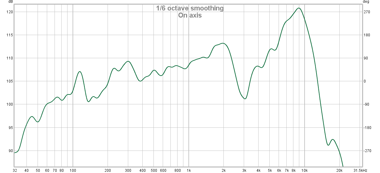

Having heard the Lii Fast-10, I cannot recommend it. The frequency response is a nightmare, with a huge peak at 9kHz. It might (might) work okay as a midbass driver, but running full-range I couldn't make it through a complete song before trying something else to see if there was anything at all it could play well.
The manufacturer-provided response plots look excellent. In reality, they're anything but.

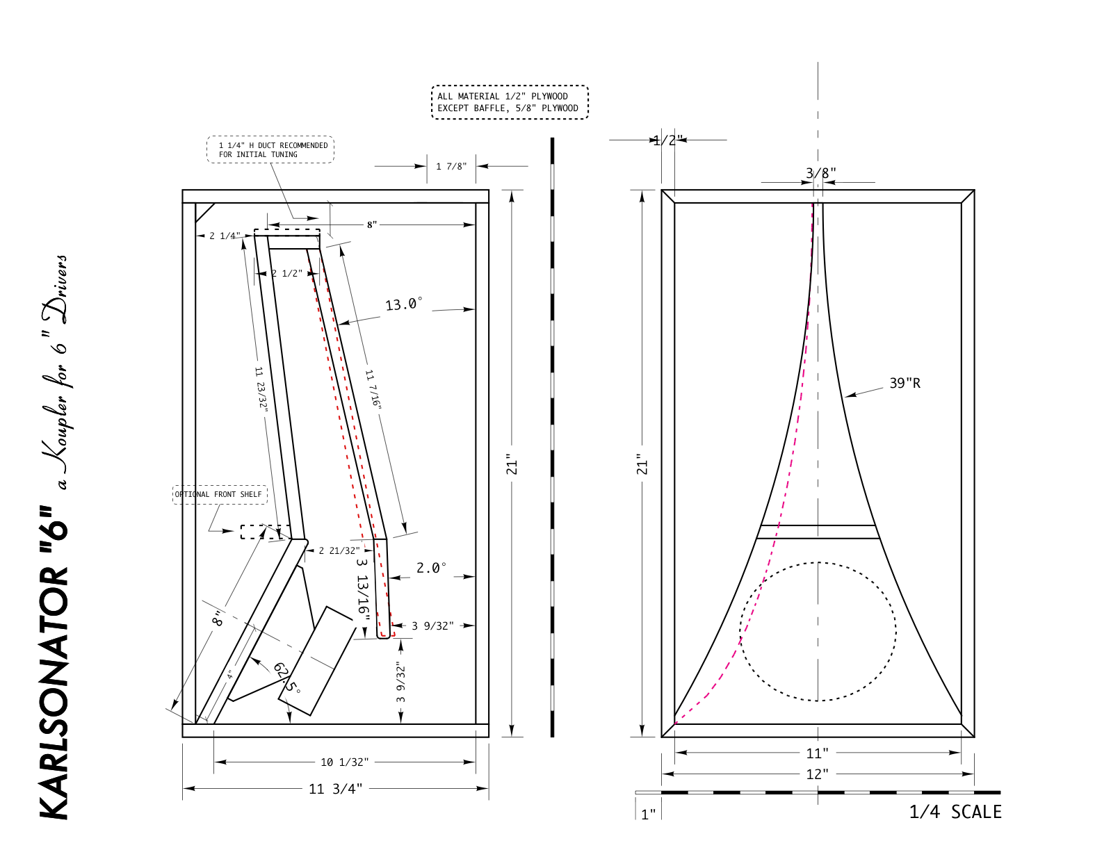

imo LCaoF6 is a pretty good six inch category fullrange driver - look at its ~on-axis response in a Karlsonator 6 prototype. (a bit less cabinet depth than plan). Its rather high qts gave less "snap" in that cabinet vs a de-whizzered FE164 on slapped upright bass tracks. That's why I don't love 12LTA - it needs more magnet.
FWIW an audio file - there's no damping in the front chamber - just some in the "stub" and bottom back of the box.
Karlsonator Six with L. Cao F6 six Inch fullrange speaker - YouTube
In case anyone is interested, here is the plan for the Karlsonator6. Make sure to put damping material in the stub (above the driver). Its fb is around 60 which works well and not too anemic.

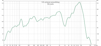

Hi Freddi,
On-axis attached. This was on a shallow U-frame OB, so the LF response could probably be improved with a cabinet.
No getting around that kHz range, though.

No problem. That curve wasn't calibrated for SPL or drive level, so the absolute SPL is likely incorrect.
However, we can still see the kHz range is basically unusable.
FWIW, it sounded like this in person. Kinda-passable-ish for a small selection of tracks. The majority of music we tried was unlistenable.

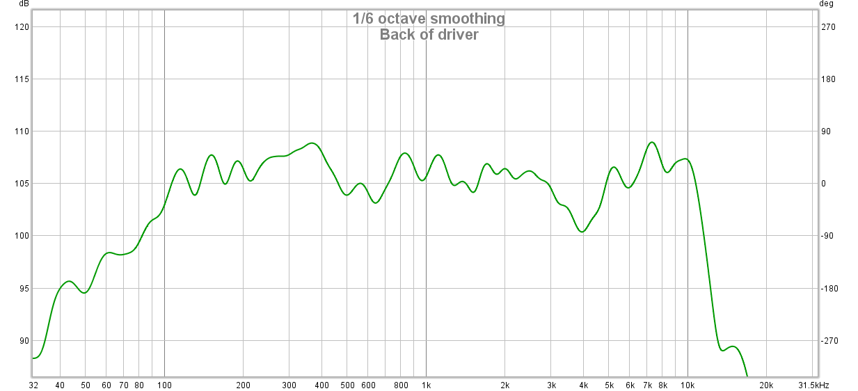

I did try listening at the back of the U-frame, and found the sound to be much more listenable. Graph below.
There's a bit of useful Xmax IIRC, but IMO there are certainly better midbass units out there. In all, I can't recommend these drivers.
Chris
