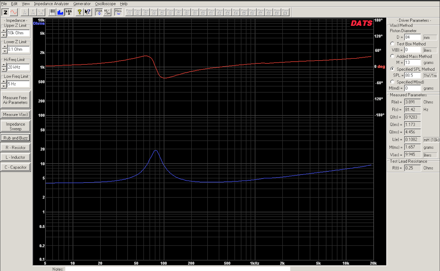

I've had experience with a few of those drivers and measured a lot of them with DATS, but suit yourself.

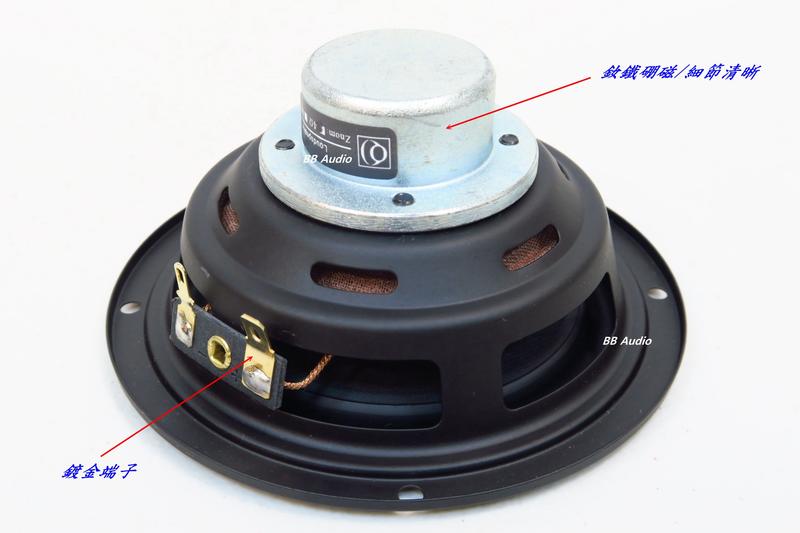

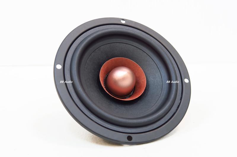

Out of the lot, I'd put these ahead. They have good specs, and for full range sound, work best in a MLTL enclosure. They do 45Hz to 15kHz.
If you are looking for casual listening, say a pair of kitchen speakers, these will do the job. Quite cheap to find. They will need a good notch or an amp with bass and treble controls (perfect with a TPA3116 with tone controls).

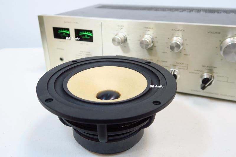

If you want something better, the best 4" driver I have ever listened to coming from China is this one. It is pretty good by itself, and quite the performer if you add a small notch at 7kHz. I've seen it being compared to MarkAudio drivers.

Hi Perceval, you said you had the DATS of this copper whizzer one, could you upload it here please?
