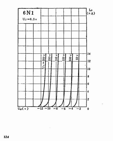

Any subs for 6N1 & 6N2 twin triode valves?
the 4th page(the last):D
