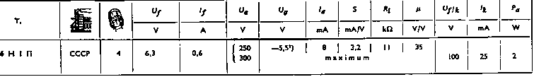

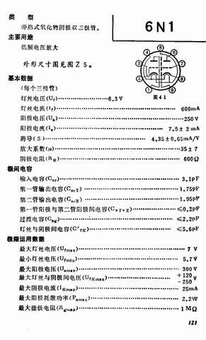

I have the datasheet of 6N1 & 6N2.If anyone is interested in that,I would post all here.
This is the first page😎

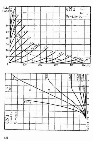

hey X.G.
i'm afraid you are quite mistaken...
remote triodes are common and important for RF and AF. again, i repeat: a remote cutoff triode is simply a triode designed to vary the mu with bias. if you look at the russian 6N1P data sheet that has the plate curves, you will see if you look across the 5mA line on the plate curves that the curves flatten out as the grid bias increases. not as much as some other tubes but enough to qualify as "variable mu". actually, the 12AU7 is also quite variable mu as well and is used in one very well known and much admired studio compressor (tube tech). i don't think anyone would describe the 12AU7 as "remote cutoff" but it definitely is. in any case, a quick look at the 6BK7 data sheet will show you how close the 6N1P is... just because the tube is variable mu doesn't mean that its no good! it simply means that if you vary the bias, the gain changes. this was done to make automatic gain control (AGC) for radios and mic preamps and many other clever things.
jc

hey geek,
you are misinformed... 6N1P has about 1/3 the transconductance and really different plate curves from a 6922... the 6N2 has the same characteristics as a 12AX7 but it is 6.3v heater only and slightly different pinout.
jc
Good grief, people.....🙄
6N1-P
250V/5.5mA bias
mu = 35x
gm = 4500µA/V
rp = 7800
6N2-P
250V/1.8mA bias
mu = 97x
gm = 2250µA/V
rp = 43000
Both 6.3V heaters only.
So no the 6N1-P is not a 6DJ8 neither is it a 6922.
How could it be?
The 6N2-P is similar to a 6AX7 but not quite so don't go popping those in a phonostage or you'll muck up the RIAA correction to say the least.
The 6N1-P has been sold for decades as a 6DJ8, especially in the USA during the cold war.
That doesn't make it a 6DJ8 but don't get me started........

I should have specified the 6N1P can sub 6DJ8, but not the other way around, because of the maximum Vp difference.
You can just as well throw that Svetlana datasheet in the dustbin, it's utterly worthless.
Also keep in mind that the heater of the 6N1-P draws 600mA.
Vp max is 300V BTW.
Cheers,😉
