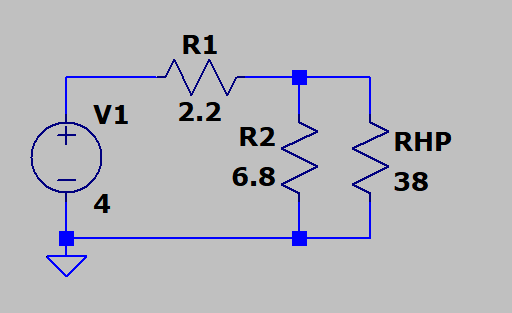

first resistor in serie is to drop voltage to protect headphone. How much watt and value of 1 st resistor?
The second resistor will be 10R in parallel with headphone to make 38R Headphone to be approx 8 ohms to match OPT.
Suppose normal level volume is around 1 watts out of 2 watts of 45. How much value of series First R to drop voltage . I listen to 45 around 60-67 db in small bedroom

You don't PUT 2 watts into a load.
An amplifier is just a voltage source (we a relatively high RI with tube amplifiers)
2 Watts ar 8ohm means 4Vrms.
4Vrms at 38ohm is around 420mW.
But that's only when you crack the amplifier fully. We don't know what the max power is of the headphones, but there quite some out there that easily need (or can handle) 200-350mW.
In any of the cases, it's essential to match the output impedance of the amplifier.
Just an L-pad attenuator should be enough in this case to match the impedance and attenuate the signal.
Far to lazy to do all calculations by hand, so I very quickly put it in LTSpice.
See schematic below.
This will attenuate the power in half (210mW) while keeping the total resistance around 8ohm.
It's not a perfect match with these E-value resistors, but close enough.
Power dissipation for R1 is around 550mW and for R2 around 1.23W.
Just take double the value to be extra super safe, so two 2W resistors will be fine (plenty) probably.
