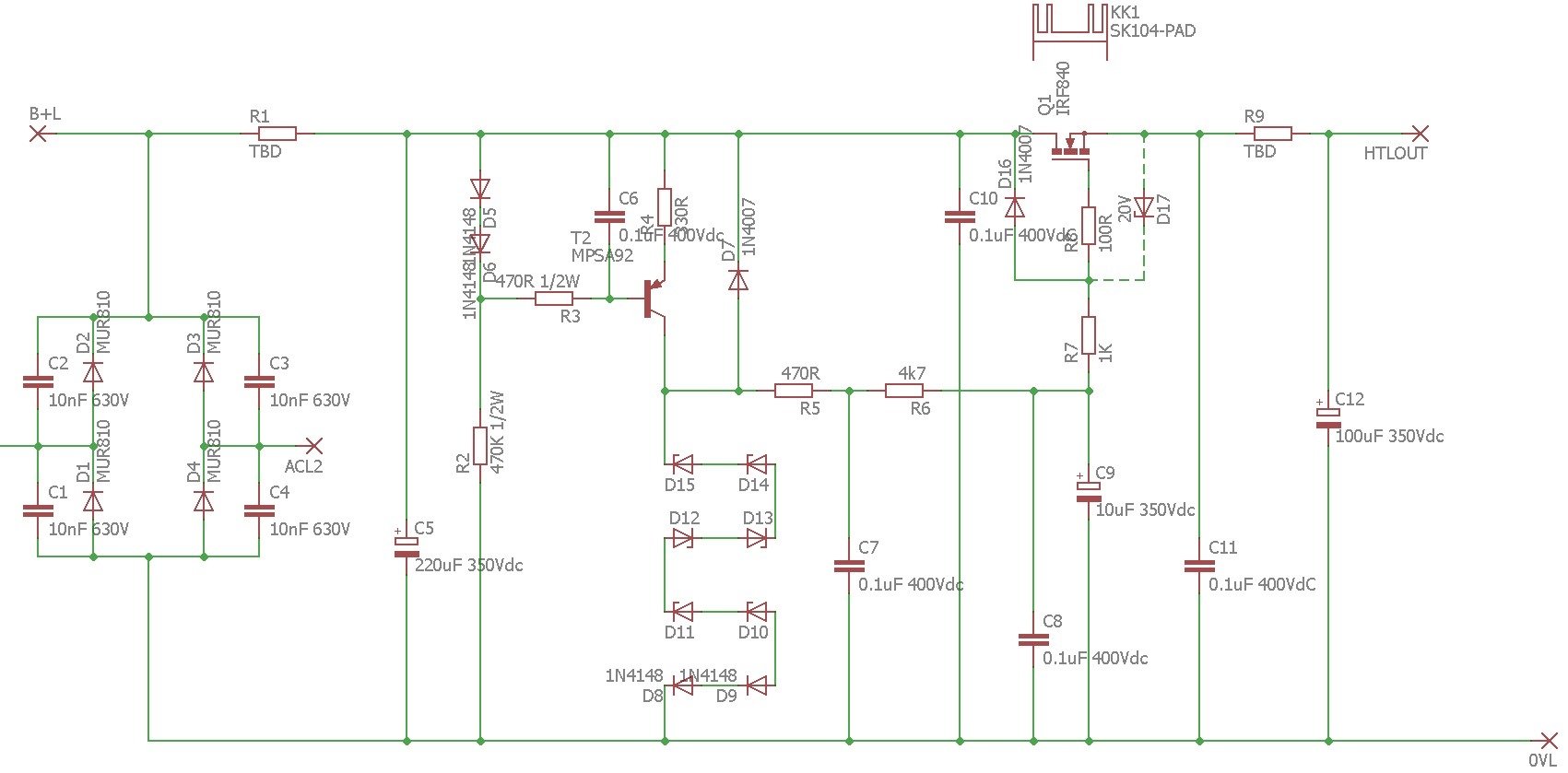

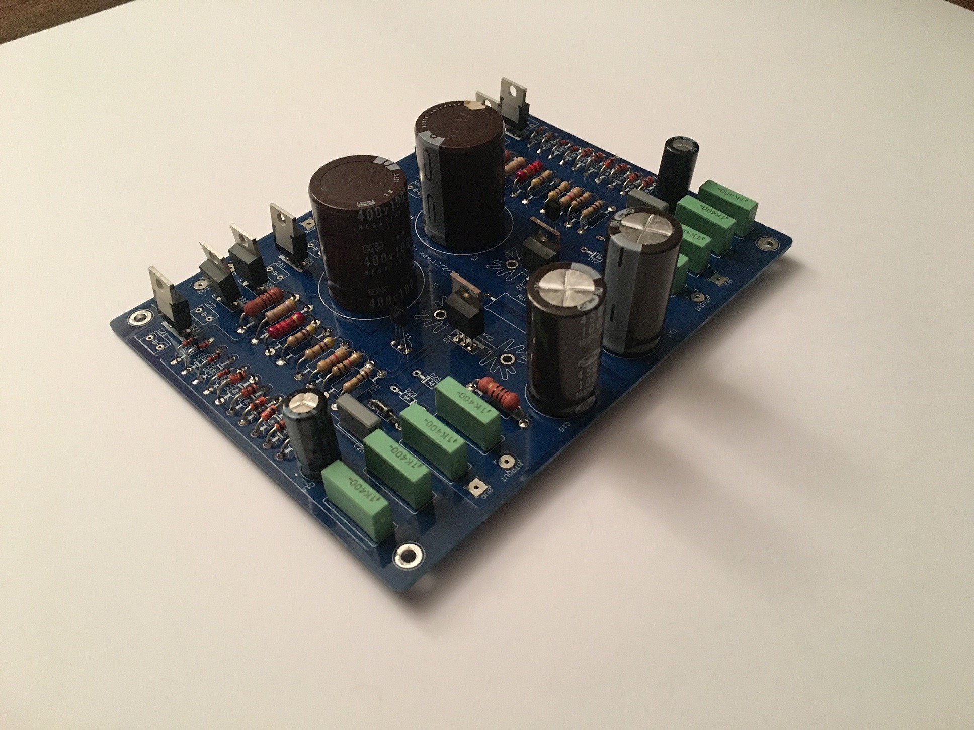

You’ll find an excellent PSU in my post which will provide 560V / 400mA and can be easy enough modified for your needs, since I attached LTSpice models. PCB Gerbers included as well. The design is by BugAmps and I can ensure you, if you are careful about grounding, you’ll get a dead silent PSU.
https://www.diyaudio.com/community/threads/building-a-pp.382845/#post-7044052

@tubekiddo, I looked at the design you linked to. Nice overall setup, very complete.
I noticed tho that the HV psu is not a regulated design, it's a source follower (fancy name cap multiplier), right?
That will sag under load.
Jan

It has a smooth ramp up, stabilizes at ‚normal‘ load and will sag if you try to blow your boxes…@tubekiddo, I looked at the design you linked to. Nice overall setup, very complete.

Maybe for a guitar amp in push-pull. For an SE amp quiet is the main concern. A class A SE amplifier doesn't have any appreciable sag unless you do something really weird or wrong.The beauty of tube sound is at least partially due to the sag of an unregulated tube supply.
It doesn't sag that much, but it produces a signal related ripple at B+ due to the source follower Zout.Maybe for a guitar amp in push-pull. For an SE amp quiet is the main concern. A class A SE amplifier doesn't have any appreciable sag unless you do something really weird or wrong.
That ripple, which is a distorted version of the signal, is directly in series with the output signal.
