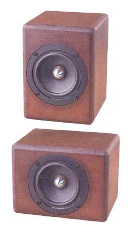

this family :
Meet the Fonkens
has worked particularly well with FE127E : i.e "m" for "milli" (4.5L)
FE103E (no pictures at the moment) fits same sized enclosure, so I can't see why the FE107E wouldn't also
and the most excellent and already very missed FF85K : "u" for "micro" (2liters)
this one is a particularly crazy good little nearfield PC monitor - iTunes equalizer can probably approximate close enough to BSC if deemed necessary.
detailed plans at first link
there is also Tony Gee's Solo103:
Humble Homemade Hifi
all above are fairly easy builds and sure don't use a lot of material

well, to be anal about it, we're calling the "mid-sized" box design (which with minor adjustments to vent tuning details has proven to work well with several of the Mark Audio drivers as well) the "milli"
I'm fairly sure that there was at least one pair with FE103E installed, and certainly there'd be no issue with the FE87 fitting in the "micro", (possibly requiring adjustment to port dimensions) but I'd doubt it would approach the FF85K in overall performance

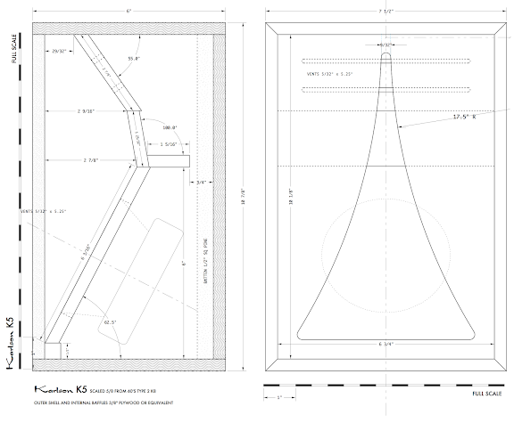

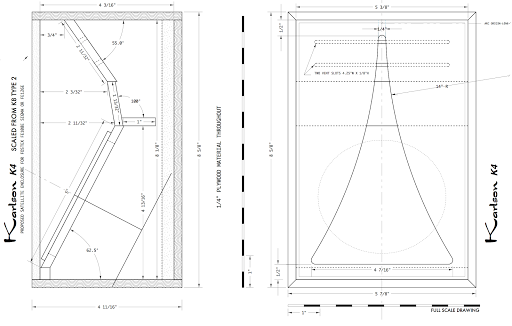

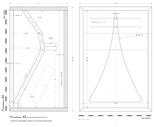

Greg Bianchini at Gregg's Karlson speaker forum scaled the 8K - I'll probably have "K4" with FR88ex as a toy then evaluate
"These are both scaled from the 1960's type 2 K8". (50% and 62.5% respectively)
full size here: http://lh6.ggpht.com/_74mgsXnFjZ8/TAbjpGw3alI/AAAAAAAAAlE/ZvhWz6KL3NU/K4.PNG
full size here: http://lh5.ggpht.com/_74mgsXnFjZ8/TAbjpmEIMLI/AAAAAAAAAlI/6WYX1NxIhFc/K5.PNG

Well, to follow up ( and Dave may post on this separately) to achieve the same bass performance from the FE87 as the FF85K handily delivers in the 2 liter micro, would require approx 4liters. So at the time, so unless you already had them in hand, it made more sense to spend a bit more on the FE127E and build the slightly larger milli-size.
