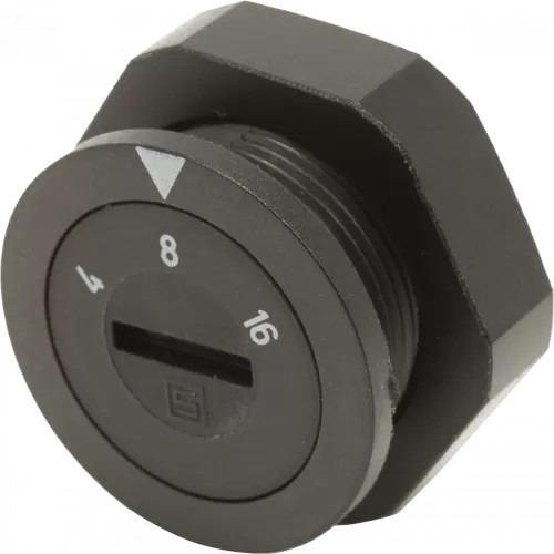

https://www.schurter.com/en/datasheet/SWM1__Frontpl_#
Click on "Open complete table SWM1 (Frontpl)", scroll down to "0033.4032".

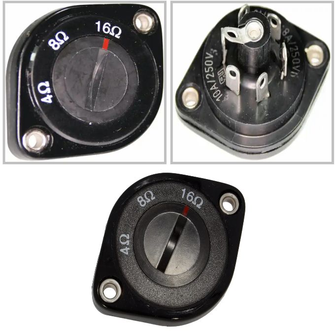

This is the Marshall "official" type, relatively expensive because of Mojo (Jimi Hendrix used them 😉 but any sensible rated switch will do fine.
Think industrial rated 5A or higher, 10A being better.
It's coin operated, a chicken head knob being an irresistible temptation to idiots.

This one is about half the price of the Marshall one:
https://www.tubesandmore.com/products/switch-rotary-impedance-selector-3-position
