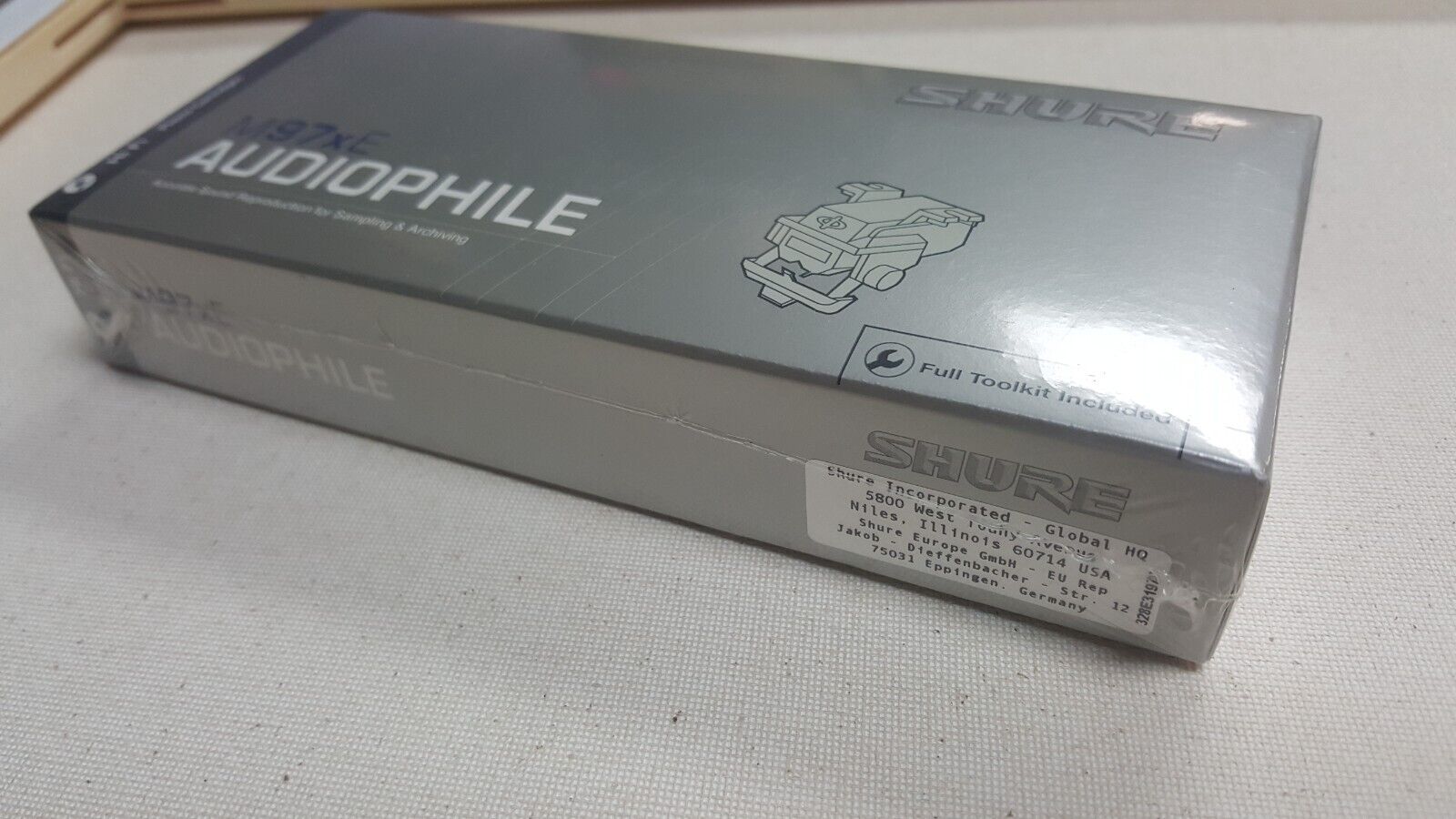

Some original packaging (for cartridges or styli) is sealed in air tight plastic film.
That way, you know it's unused. And it's protected from degradation due to exposure to the air.
