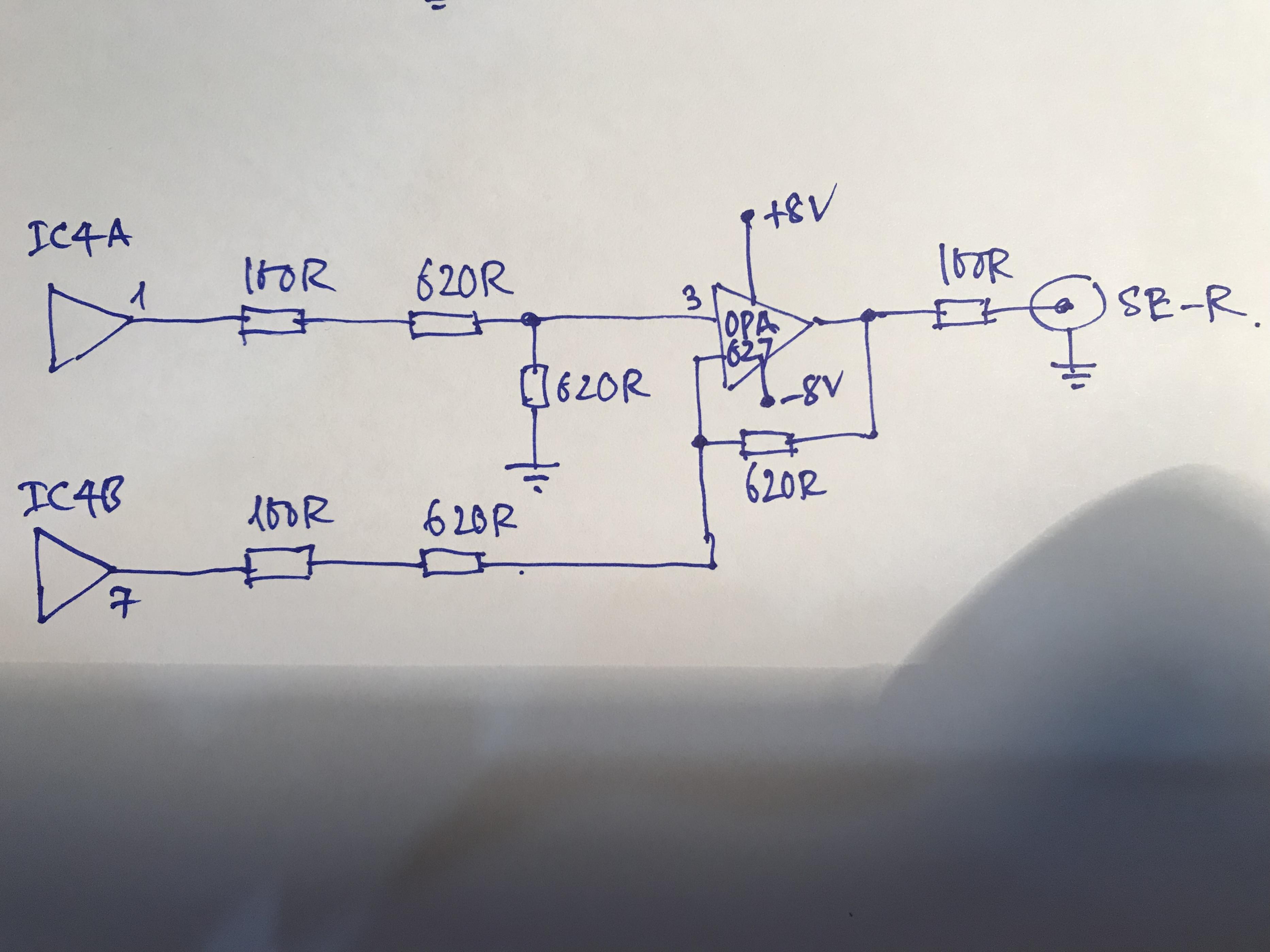

I have 4 PCM1704U-J and JLSound I2SoverUSB board.
I2SoverUSB - I2S over USB Audio
My plan is make a reference DAC which Non-Oversampling, full balanced , XLR and SE two type outputs.
First this circuit base from pavouk.org then returned to balanced type.Can it useable with this way, what is your opinion about circuit? According to this circuit could you recommend a reference I/V Converter, LP filter output? It could be discrete design maybe a transformer. Or these OPA627 and OPA2134P output acceptable for a reference grade?
Also i'm not sure how can i convert XLR outputs to SE outputs, what is best methods for that?
You can try my schematic, this is good method for you!

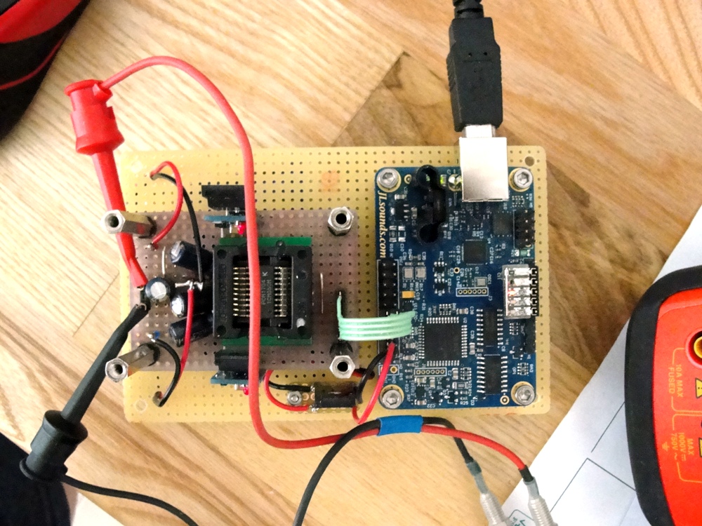

The JL Sound works as claimed.
This is not a DAC.
This is a measurement fixture to match (a batch of) PCM1704's.
So only one channel on IC test socket, and opamp IV.
Patrick

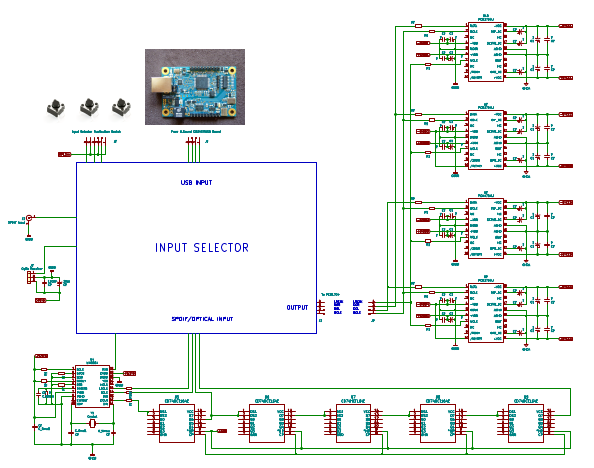

I continue the circuit drawing but have one question to members.I very confused.
First i try to explain circuit. There are a switch circuit between USB and other inputs.When USB close it will connect directly to the PCM1704 side.When SPDIF/Optical input close, it will connect to buffer and bit delay circuit then goes to PCM1704 side.As i know there is no other choise for that.
Then i saw DDDAC notes during my research.They use delay data half clock cycle.My question ;
Do i have to use this half delay circuit or my circuit is enough ?
DDDAC 1794 NOS DAC - Non Oversampling DAC with PCM1794 - no digital filter - modular design DIY DAC for high resolution audio 192/24 192kHz 24bit
http://www.dddac.com/documents/dddac1794pbt_nos_ver51.pdf
Best Regards

That board looks like it will need some external circuitry yes.
Patrick shows the use of the JL Sound board a few posts up, so that's a proven board.
...and it's the one I have laying around somewhere..
Do you have a finished PCM1704 dac board or it is in progress?
Actually I know the JL Sound board it is great but if I want to use better oscillators like CRYSTEK CCHD-957 I have to buy additional board from JL Sound for them.
In this china board the oscillators can be replaced easily.
