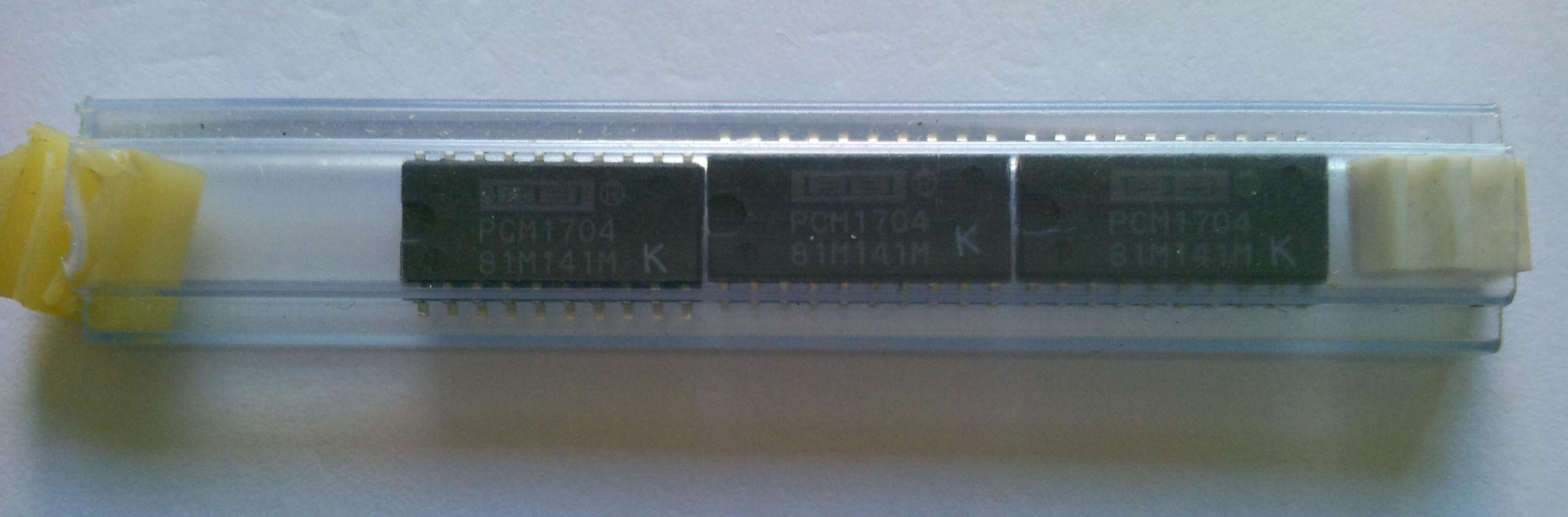

Doing a bit of cleaning I found an old gem: (sorry for the blurry pic)
692819d1532104258-project-pcm1704-pcm1704k-jpg
3xPCM1704, bought years and years ago for a project that never happened...
Anyone has an idea what they could be used for nowadays ?

Genuine PCM1704 is 80 USD each at Rochester Electronics (well-known authorised EOL IC dealer).
And that is not even K grade.
: Part PCM1704U-J
So I suggest you post them at Swap Meet for at least 80€ each.
If someone would pay that (fair) price, he has some serious use for them.
You cannot drive them directly with I2S, but need glue logic or a digital filter chip like PMD100.
We have plans for them (we bought a bunch before they got obsolete), but no time yet to execute.
Or maybe you should keep them and do something with them afterall.
You won't find such nice sounding DAC anymore these days because they are just too expensive to make.
And 24/96 is more than enough for playing 16/44.1, unless you want to play 24/192 material, or above.

Hi ... Just FYI the PCM1704 is likely capable of going up to 768 kHz/24 bits or there's a rumour that it will even do 1.536 MHz. This is with no oversampling.
If you decide to use the 1704 for a project - and maybe prefer a simple(r) setup - JLsounds USB-to-I2S directly offers the bit "shuffling" needed to align two channels so that external oversampling filters or electronic circuitry for this is not needed.
