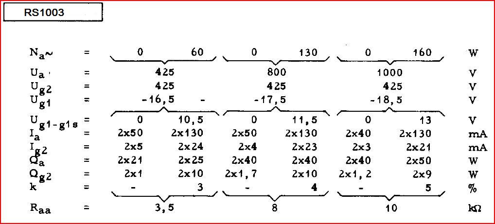

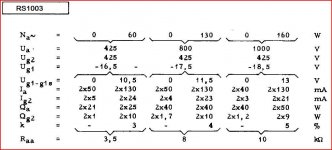

single pair of 4D32 can give you 120 watts, the operating points are given in the datasheet...
what i dislike about the newer kt120 and kt-150 is that there are no published operating point for pus-pull....unlike the 6550 and the kt88's....

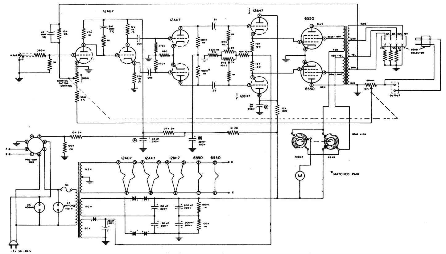

The O/P transformers used in the Cit. 2 and the Heath W6M are very special and I don't know if satisfactory "clones" of either can be purchased. Good O/P "iron" is always EXPENSIVE.
Maybe you could make something loosely based on the Heath W6M around the Plitron PAT-2100-SSCR O/P transformers, whose full power bandwidth is excellent. Even though the "finals" operate in UL mode, g2 B+ gets regulated for superior open loop linearity. Williamson style circuitry has plenty of NFB, for a decent damping factor. FWIW, I would use a "high" current/"low" plate voltage KT88 operating condition set, to compensate for the comparatively low primary impedance.
BTW, I would adjust the W6M's small signal tube lineup/circuit details to make the gain structure compatible with unattenuated 2 VRMS I/P signals and more linear.
