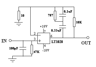

Seeing as how opamp based ccts have come into this discussion anyway I'll throw my hat into the ring.
A while back in the search for a ludicrously simple phono amp i stumbled across the kits link at the bottom of the diy site and followed it to Lidstrom audio where they had the following:
I built my first version using +/- 12v battery power and kept the feedback resistor to ground at 10 ohms but incresed the load of the feedback RIAA network by 10 times (resistors up by x10 and caps down by x10) to give me sufficient boost for MC purposes.
Not the last word at present but it's currently implmented with really cheap caps and resistors and NE5534's. Still sounds good though. i believe there's alot of potential for tweaking.
My next build will keep the same schmea as I'm using now but with Caddocks, Auricaps and AD797's.
food for thought and WAAAY simple

For MC use, current noise of bipolar inputs is not as important as voltage noise (source impedance reasons). I've had trouble getting FETs to work well without some heroic efforts. What DID work well was the AD797- extremely low voltage noise and extremely high PSRR, which takes a lot of criticality out of the power supply design.
For MM, I'm still a tube guy, though I'll admit that there's FETs in my preamp, too.
