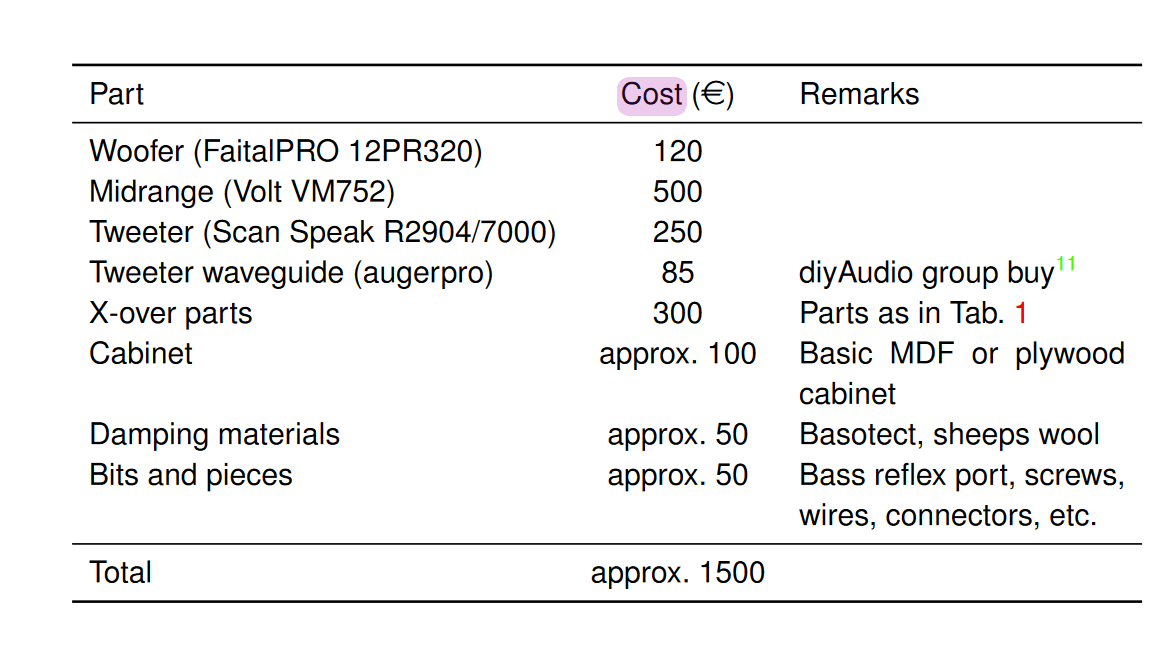

If you have the room, for that budget you can have the Open Source Monkey Box with plans on this site, larger bass driver which is always useful, one of the best mid drivers around and a the Be tweeter. There is a floor standing version if you want to go down that route.
https://www.diyaudio.com/community/threads/open-source-monkey-box.327594/

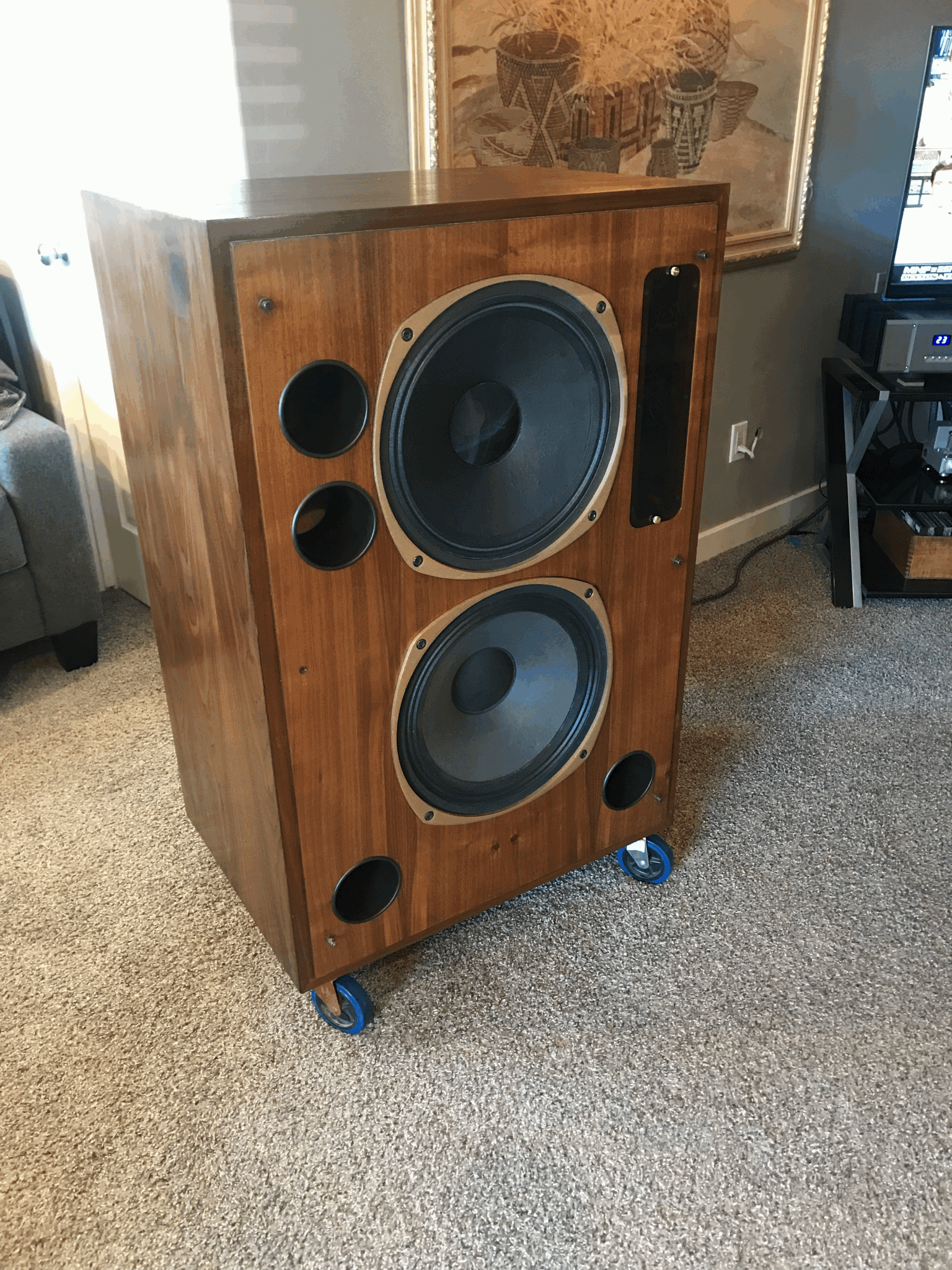

Guys, Thanks for helping me in my journey. Some additional background. Mark-The coffin box of the 6661 is no beauty, agreed. The Madi box is also no winner. I choose them more for the products incorporated. I did look at Meniscus offering but saw nothing simiar. I want a floorstander for a few reasons. 1- Increases sensitivity 2-The dogs are less likely to knock it over. 3 Should improve low bass . So to answer the final question-I have looked at Madisound, Troel, Meniscus. The goal here is to own something that wows not just pacifies me. Below is what I just sold.

The 72 page Monkey link likely a picture/price somewhere right? I am open to all suggestions of where to look at kits/designs or brands.
Jeff Bagby Helios kit is available here with links to a write up of the design and box size - https://meniscusaudio.com/product/the-helios-loudspeaker-kit/
Write up of the Open Source Monkey box has a link on the first page which includes an indicative costing of the parts - http://github.com/mbrennwa/osmcdoc/raw/master/osmc_paper.pdf

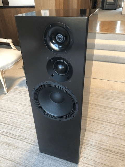

Guys, Been a while so let me thank you all for such well thought out replies. I was at Axpona and listened to some very good speakers.

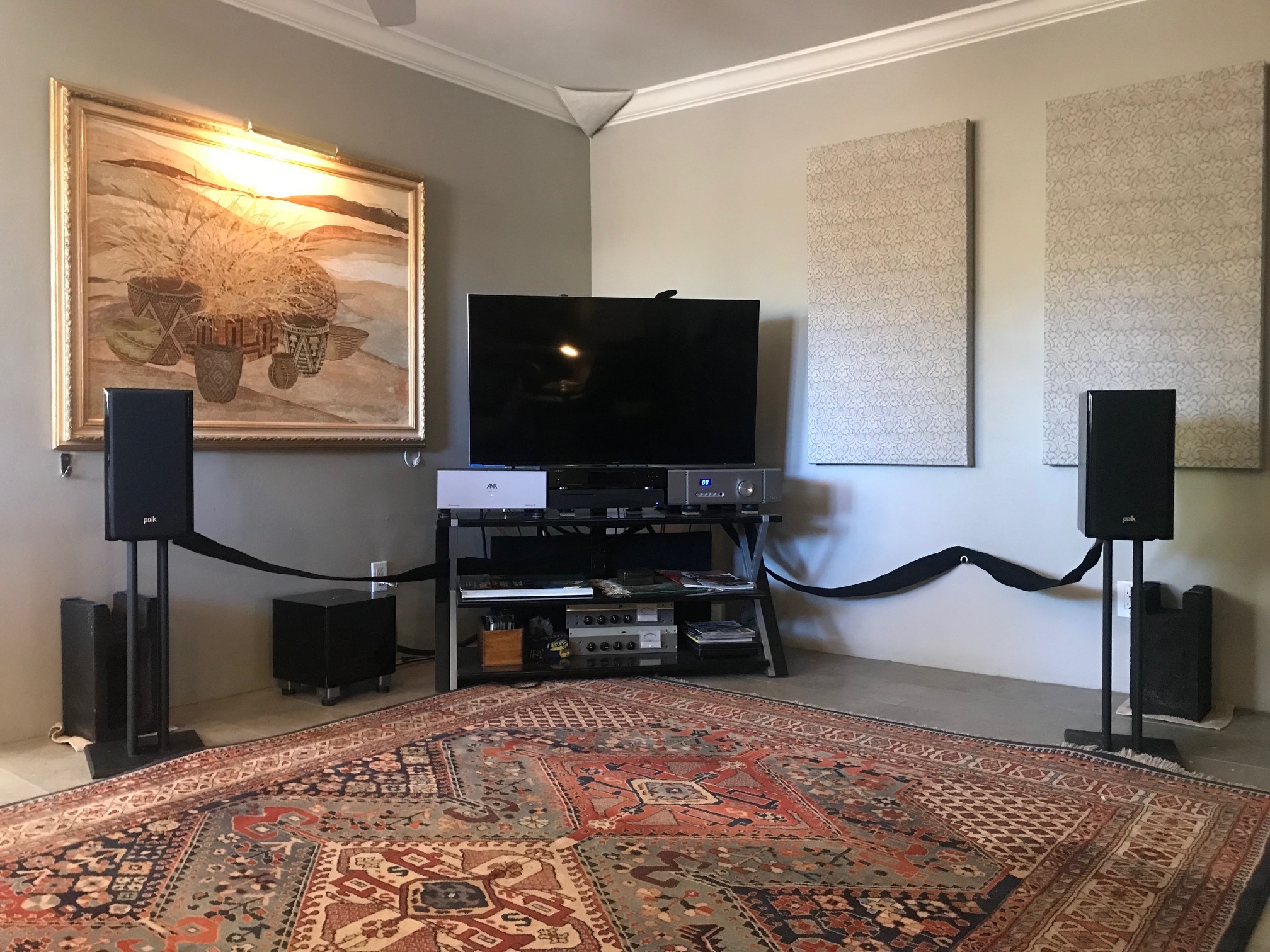

Jim Salk had his new Purifi Be speaker $6k, The AudioNote Hemp $6k, The MBL baby $12k, Ikon Powered $10k, and others were grabbing my attention. The attached photo shows the new Polk L200's just received for our August 27th exhibition. One of 14 models. AZAVCLUB.com
